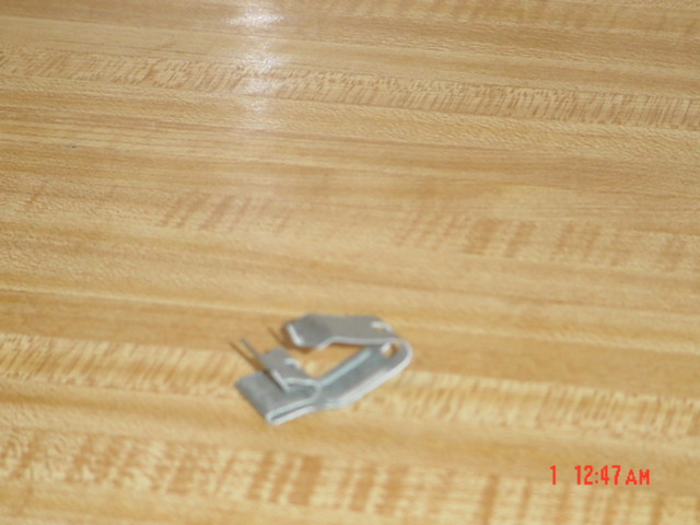

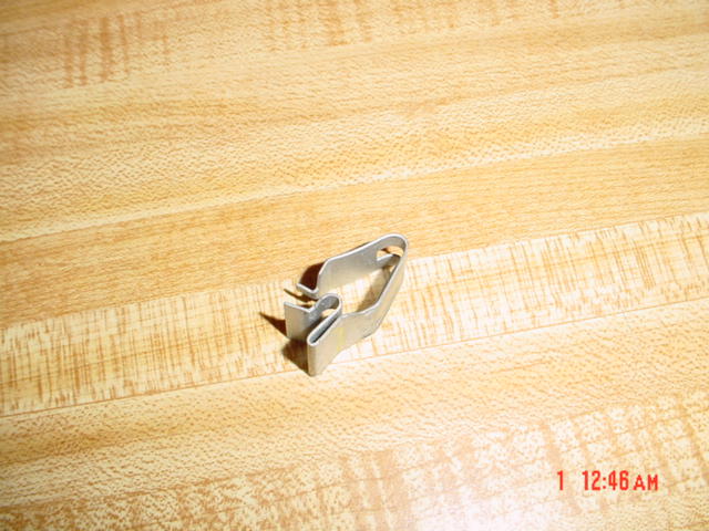

so all I need is the metal clips that hold the grill shell on? I believe I have one of them that the guy sent me that I bought all of my denali stuff from. I'll get a pic and post it here in a few minutes.

heres a clip he sent me. I found it at the bottom of the box, I don't know if there was more. Is these the clips you are talking about that I need, how many do I need? Whats the part number for the clips? Thanks a lot.

Old Jan 1, 2005 | 08:37 AM
one03sierra's Avatar
Formerly one92rs
Joined: Apr 2003
Posts: 4,205
From: league city texas
Talking
that is them.
Old Jan 1, 2005 | 09:28 AM
00z71sierra's Avatar
Joined: Jul 2003
Posts: 154
From: Northern NJ
Happy New Year to all!
If you have fog lights already on your Sierra then it's plug and play and you don't need a separate harness. Also, you would have the button on the dash already.
The clips you are talking about should be on the new grille shell already. You shouldn't need to get any different clips. The swap is very straightforward.
