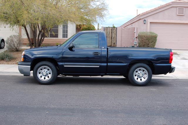

You dont need a photoshop just do it! heres before and after on mine

I was just unsure if I wanted to do it or not, so I thought a photoshop would sway my decision. But looking at yours, it does look a lot cleaner. I think I'll attempt it this weekend if its nice. Thanks
