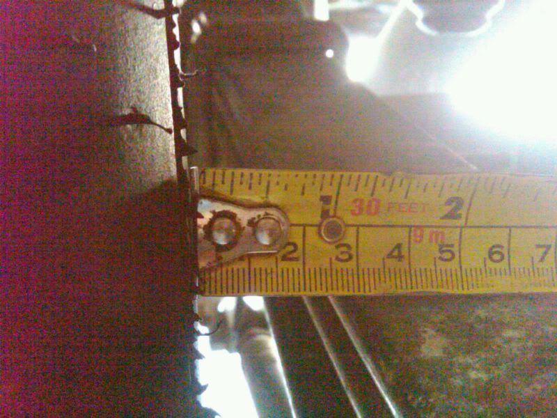

I wish I had leafspring clearance like that. I'm guessing the drumbrake rears are actually a little narrower than the disk brake rears. Does that sound right?

Not sure, but could be. I'm narrowing mine 2 1/2 inches per side, which is a disc brake setup, and running a 4 1/2" backspace wheel. Which equates to a 7" backspace on a stock setup. I should end up with about a 1/2" spring clearance with the 325/50R15 tire, if my math is correct.

You know I remember you and I discussing that. I am gonna measure wheel mounting surface to wheel mounting surface on my rearend this weekend and see what I come up with. Maybe we can get someone (aka you ) to meaure there truck with drums and we will compare measurements.

Biggest D/R mt makes. 325/50r15. sticks out a bit, but thats fine. 4/6 drop will commence next weekend, then finish tune.
Mounted on Broke10's 4/6 drop silvy.
6.5" Back spacing, section width 13.1". leaf clearance bout an 1"

Take some better pictures!!! Looks good though!
