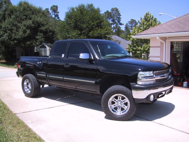

I would stay away from stacking lift blocks, if you want it higher than 3 inches add a suspension lift. If you are just looking for 4-5 inches of lift you can do the 3 inch body lift and add a torsion bar leveler kit in the front for an additional 1.5 inches. Thats what I have.
Me too !
