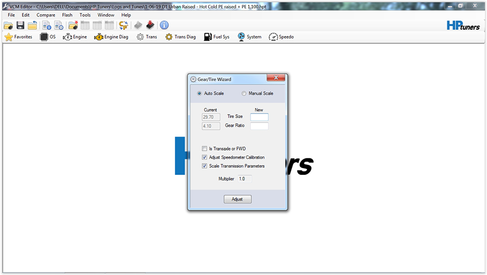

3.90's is better than 3.42's in many applications and yes you need to tune the computer for the gear change. The speedo needs to be corrected and the transmission needs to know the tire size and gear ratio for proper shift scheduling.

I agree 4.10's with the 31.6" diameter rear tires.
Yeah just add the tire height and gear ratio in the HP Tuners "Gear/Tire Wizard" and it scales all the parameters in the tune automatically

I did 4.10 in my 2012 with stocker 20s, it raised the rpms over all by about 500...gas mileage didnt change one bit even down the highway, plus its quicker around town. if you change the gears and wait on the tune, your ABS light and dinger will hate you every time you start the truck and get rolling. Your ABS and Stabilatrak and Traction control will NOT work, when the lights are on the system will not work properly. If you want to pay for the credits, I can make the adjustment to your tune. I wont do any actual engine or trans tuning just the gear ratio.
