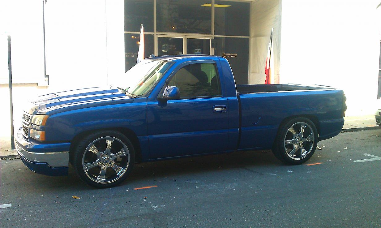

285/35/22 fronts 285/40/22 back.. 2.5/4.5 drop..

Is that tire a 285/35 or 40?
It's a 285/40... The 285/35s are in my sig. If you are at a 3/5 and ~35 offset, I would recomend the 35s in the front. You'll have a little more road feel but it will be the only way to avoid rubbing. Part of the ride quality may be also due to the change in tire design. I went from a Nitto 550 to their 420 which is a little less agressive patern.
