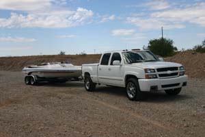

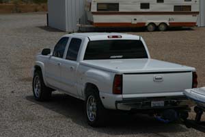

I posted in the general box on these wheels. I've got the real Weld Velociti 8's on my 2500 non HD. The rims are 9.5" wide, I'm not sure what the back spacing is, but with the flares they do stick out a hair in front, but they look dam* good.
Here's a couple of pix:
Attached Thumbnails 20" wheels on HD-smtruck.jpg   20" wheels on HD-smtruck-boat.jpg   20" wheels on HD-smnewtruck.jpg
