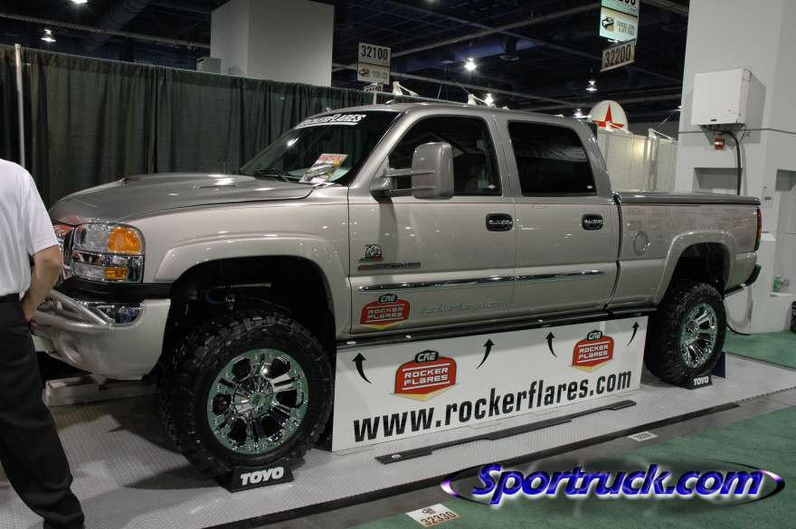

To do a upper 2-tone paint job like this, would you need to pull out the windshield & back window, or could you just get away with taping them off? I guess removing the bed to get the back of the cab & front of the bed is a given. I don't really care about painting the door seams/jams since it won't be a show rig.
The truck would be a '05 Chevy 2500 crewcab.

i just did a color change and they pulled everthing out from windows to inteior but i guess u could just tape them off but i say it is worth it to pull it all out

i would say that the colors being pretty close you could pull it off without removing the windows but i would probably remove them so you wouldnt get alot of buildup around them.....BTW ive seen a few start to peel around those areas but if its prepped good you should have nothing to worry about.
