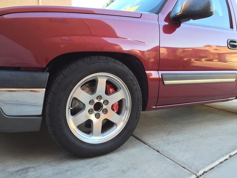

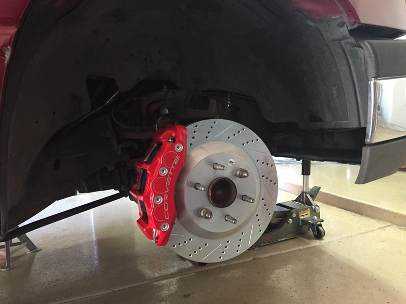

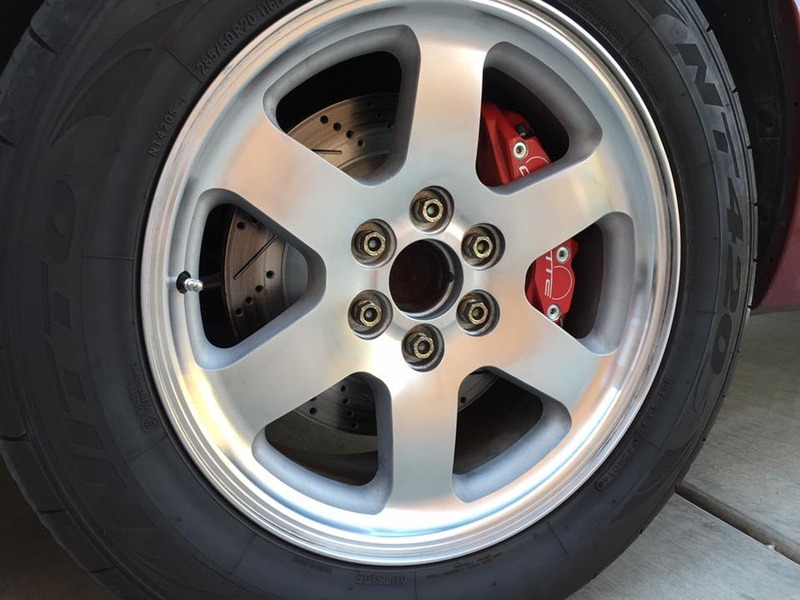

Well, they're on...alittle upset though. Come to find out the GMC decladded wheels hit the calipers face. Had to go out and buy spacer plates. Took a 1/2 inch to clear. Monday I'm going down to a local wheel shop and having customs spacers made that are hub centric.
Other then that, the pedal is the firmest I've ever felt on a truck. Only thing I've felt more firm is my dads corvette brakes. Have to season the rotors then bed the brakes. So no heavy braking for a week. Install was pretty straight forward if you have any mechanical abilities. Thanks to Rudy for the caliper brackets with supplied hardware, fit perfectly. Not a very cheap swap, but definitely worth it for the looks and added stopping power.
