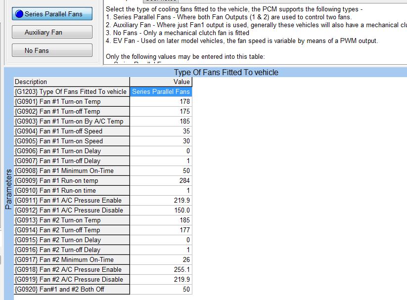

Only good news to report is that my OEM efans and OEM harness install worked flawlessly. The OEM harness is a super clean install. Only thing I'm not sure of is what controls high speed for the fans. Obviously, the low speed on is controlled in the tune and I'm guessing high speed is based on the A/C pressures. But what controls high speed when the A/C is off?

High and low speed are both controled by the tune. Both can be activated with temp and/or ac pressure.

Where is the high speed in EFI live? Does 99-02 have high speed control by temp? This is what I'm working with at the moment
