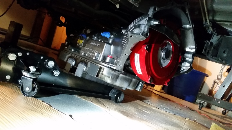

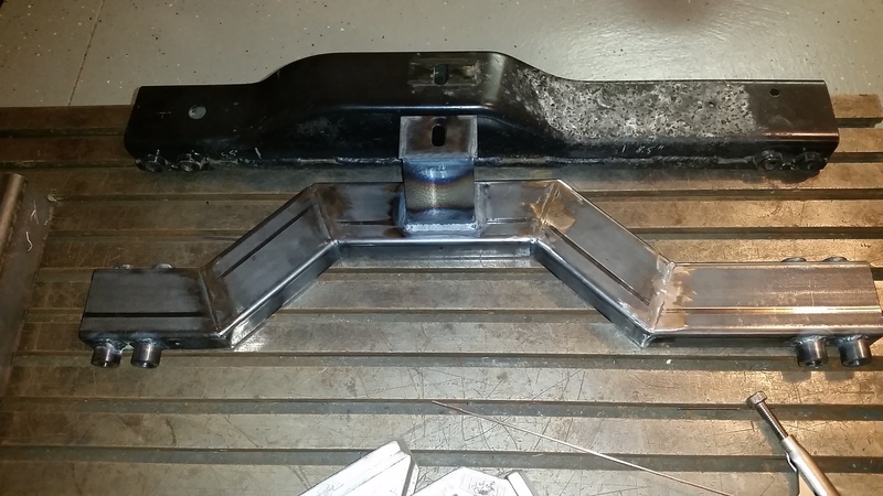

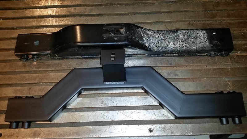

Nice looking cross member, and I'm steeling your idea to quickly weld up a trans support for the jack. Great for working on the garage floor. Any progress with the turbo build?

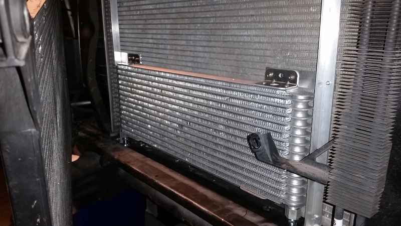

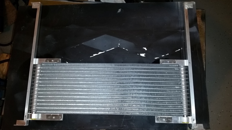

Thanks, nothing really exciting to update on, I have been lazy. I finally put the intake back on 2 weeks ago after doing the sloppy IAT mod and started plugging sensors back in. Working on routing/re-routing hoses/coolant lines/etc trying to keep it somewhat organized. Also working on a filter setup for oil feed to turbo, I'll post pics of that when I get it sorted out.

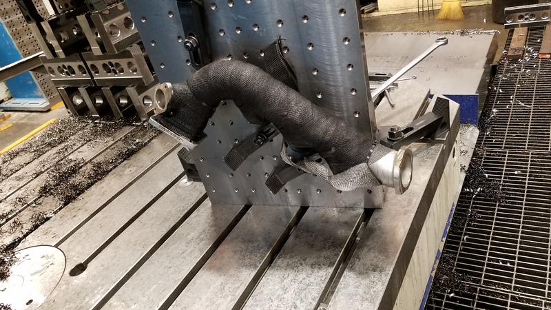

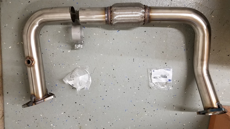

So after mocking things up, this isn't going to work since it hangs below the frame.
I could've hacked it up and re-welded it but i decided to make my own crossover and use v- bands.

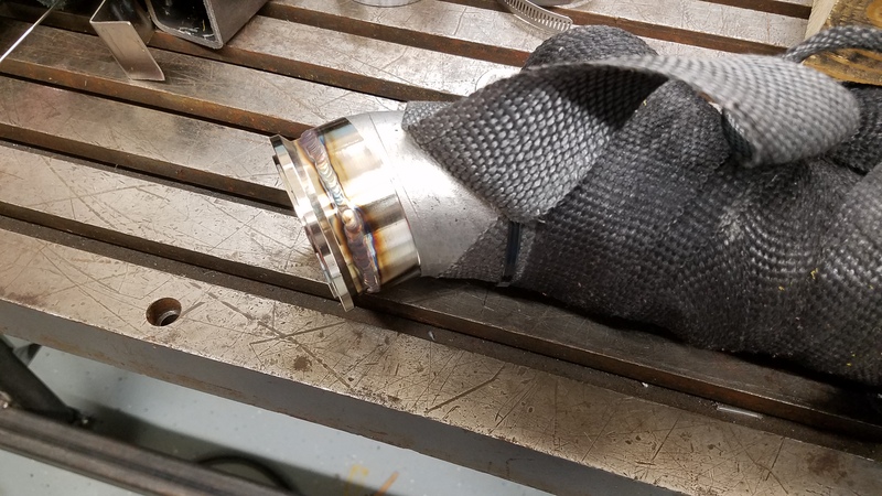

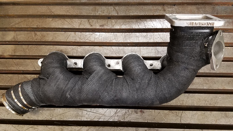

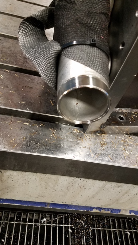

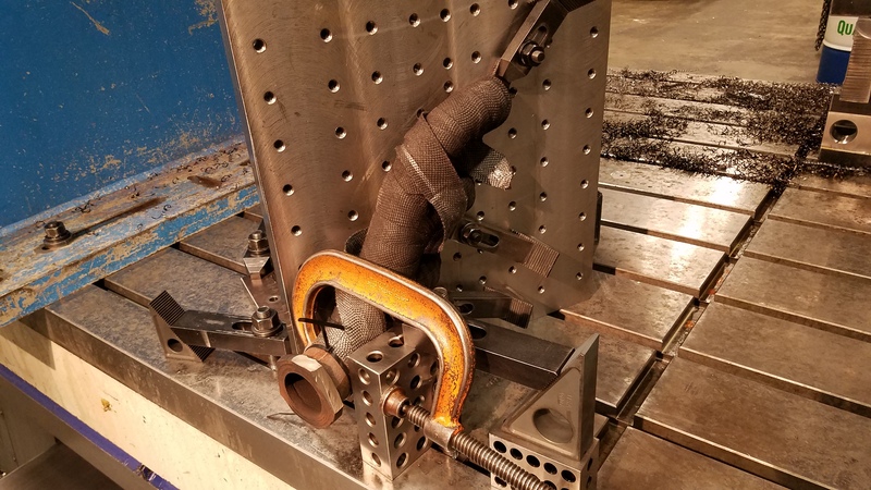

Weld preps
Size:  195.9 KB Name:  20170506_093212_zpss8chexwy.jpg

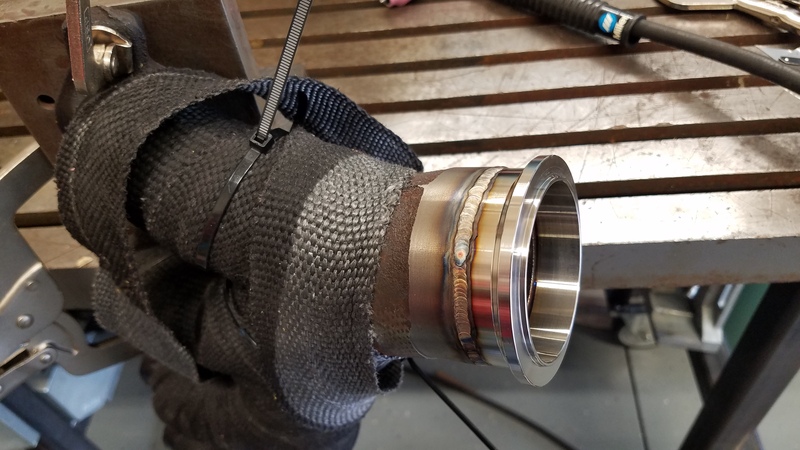

wrapped up and ready to go Name:  20170512_170241_zpsbadpdvvm.jpg
309 filler for cast steel to stainless
Just waiting on a frame clearance tube from spintech to connect the dots.

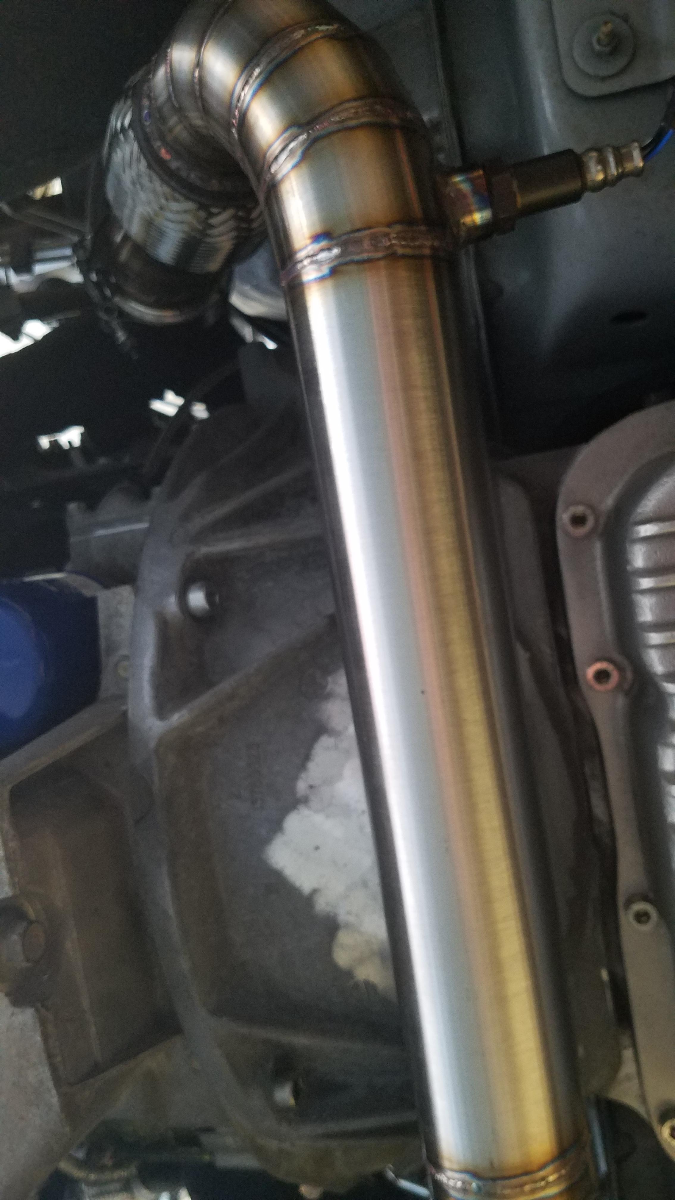

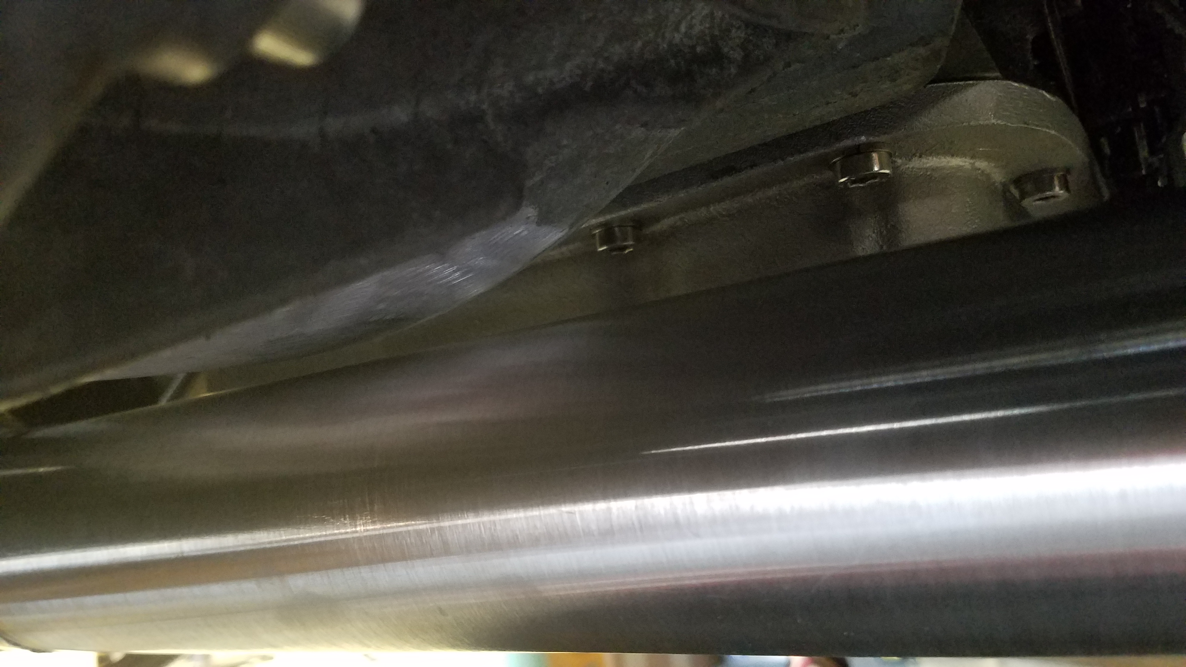

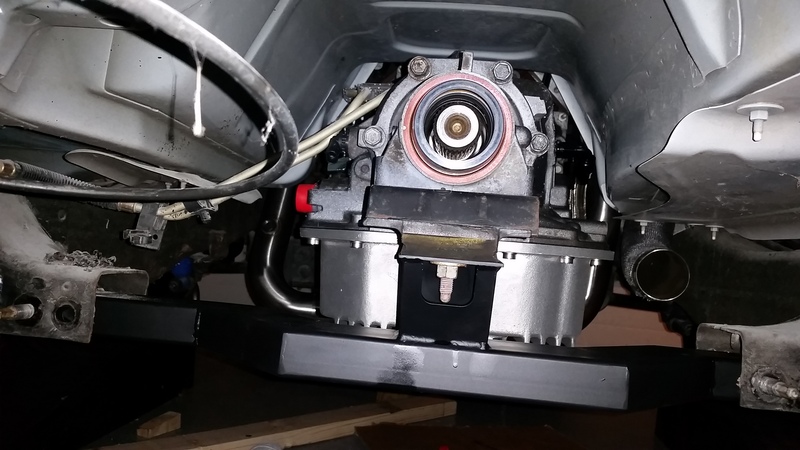

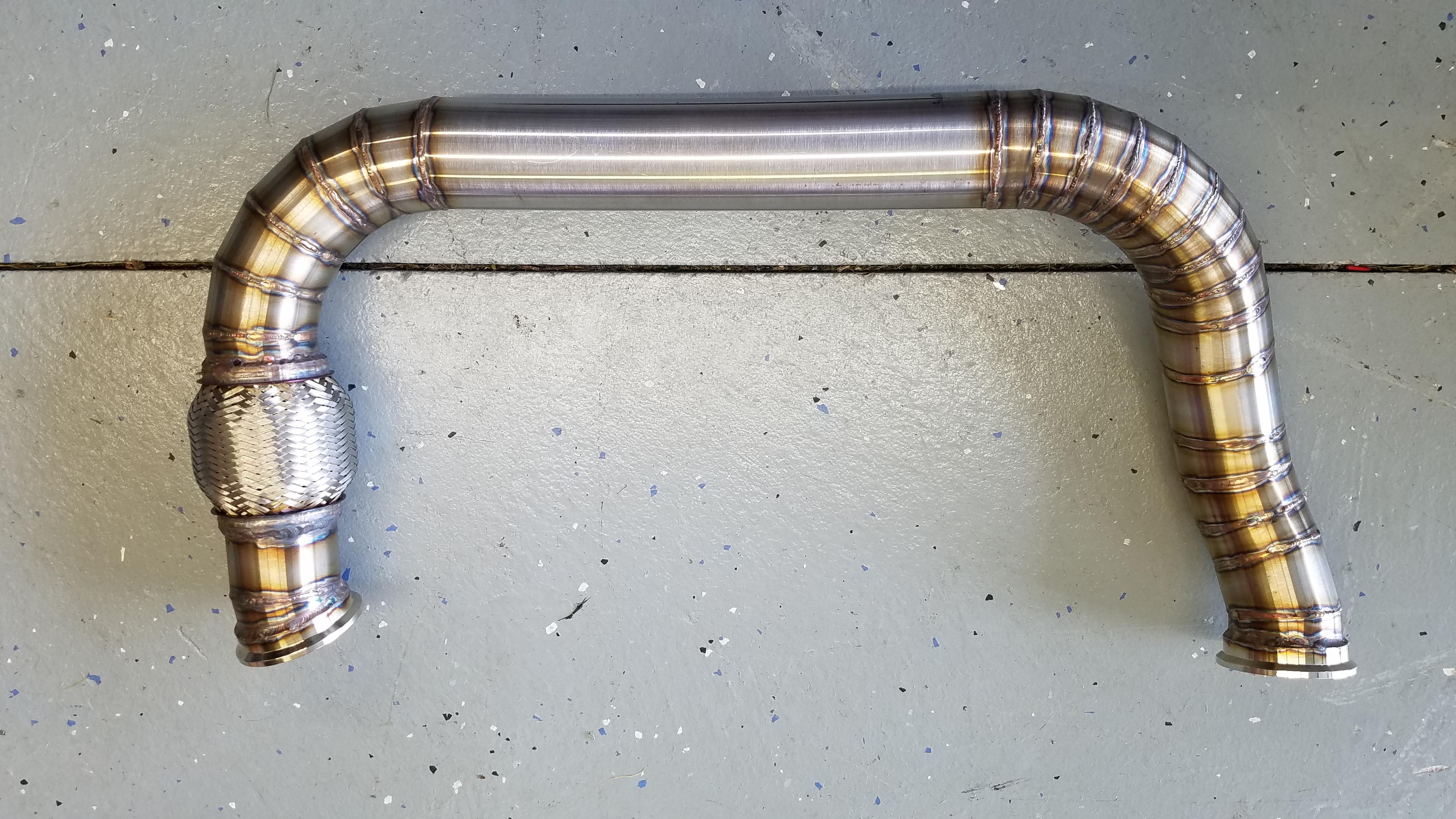

Crossover is done, tucked up tight to transmission for ground clearance

Yeah, real nice work. I'm going to piggyback off your trans jack jig too
