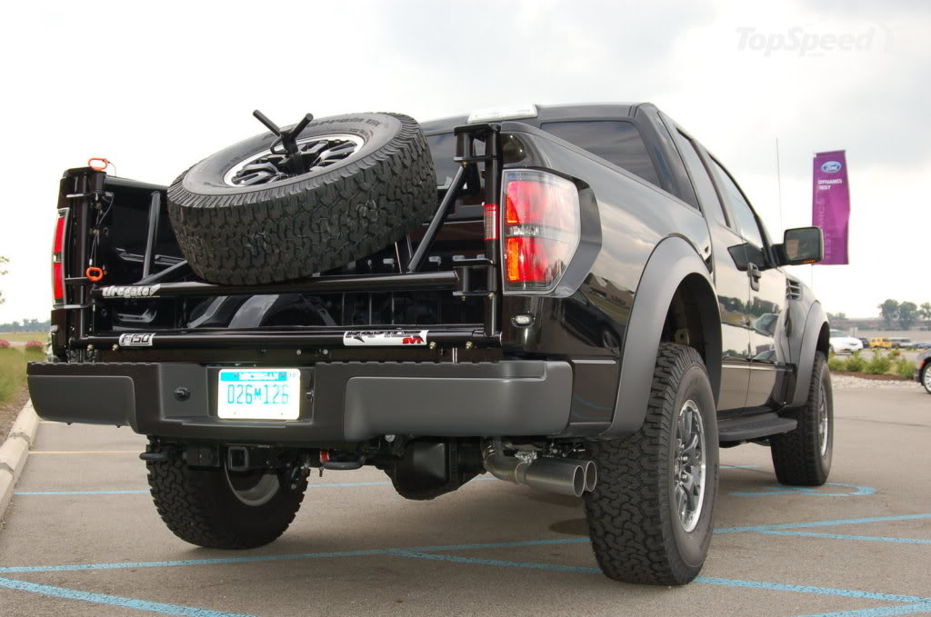

You could definitely hear when the pipes hit the bed lol. Having them exit before the tires might have been what made it resonate in the cab so much. I kind of like how the Ford Raptor exhaust looks. Maybe have the downpipes stay dual all the way back to the muffler with an internal x-pipe and then exit like this:
No cheesy clamp on tips though

This is not a NA exhaust. You don't need an xpipe, keep them separate the whokw time if you want to do duals. I change my vote to hood stacks.

I don't care if its duals or not. That's not part of my requirements, Richard! Just want a little more exhaust tone. I don't think the 4" is helping that.
