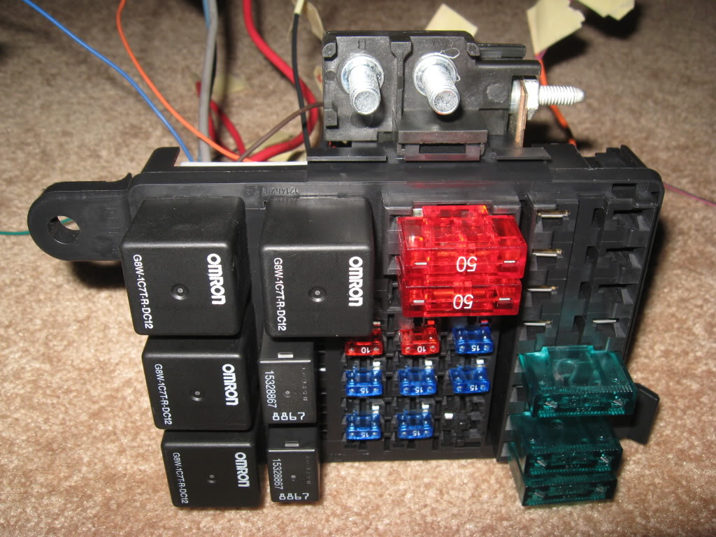

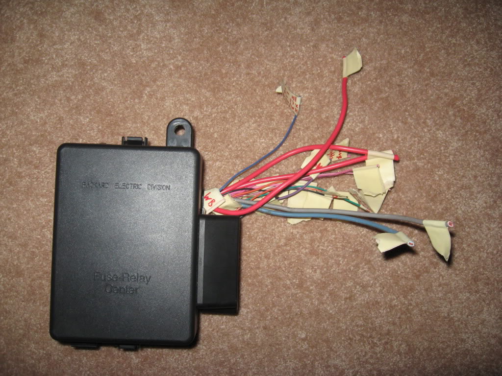

So I decided that having a bunch of extra electronic modifications warranted some organization... Lol so here's the product:
secondary fuse box
Basically just a dedicated fuse/relay box for all the extra stuff. It houses the fuses and relays for the e-fans, nitrous stuff, secondary fuel pump, fuel pressure gauge/sender, boost controller, Lingenfelter harness, wideband, gauge lighting and stereo amplifier. Everything in one little package. Better than stringing up relays and in-line fuses everywhere
