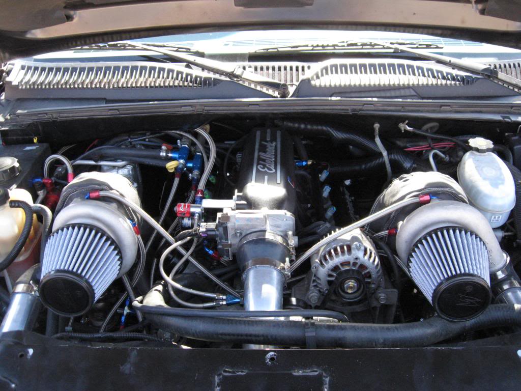

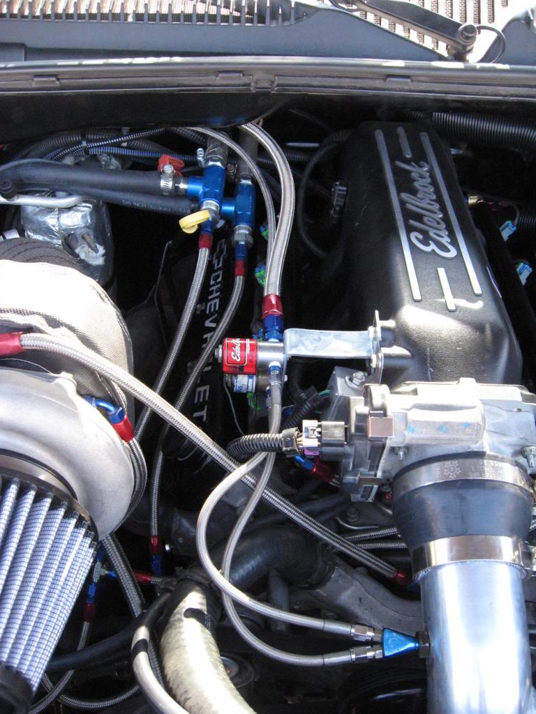

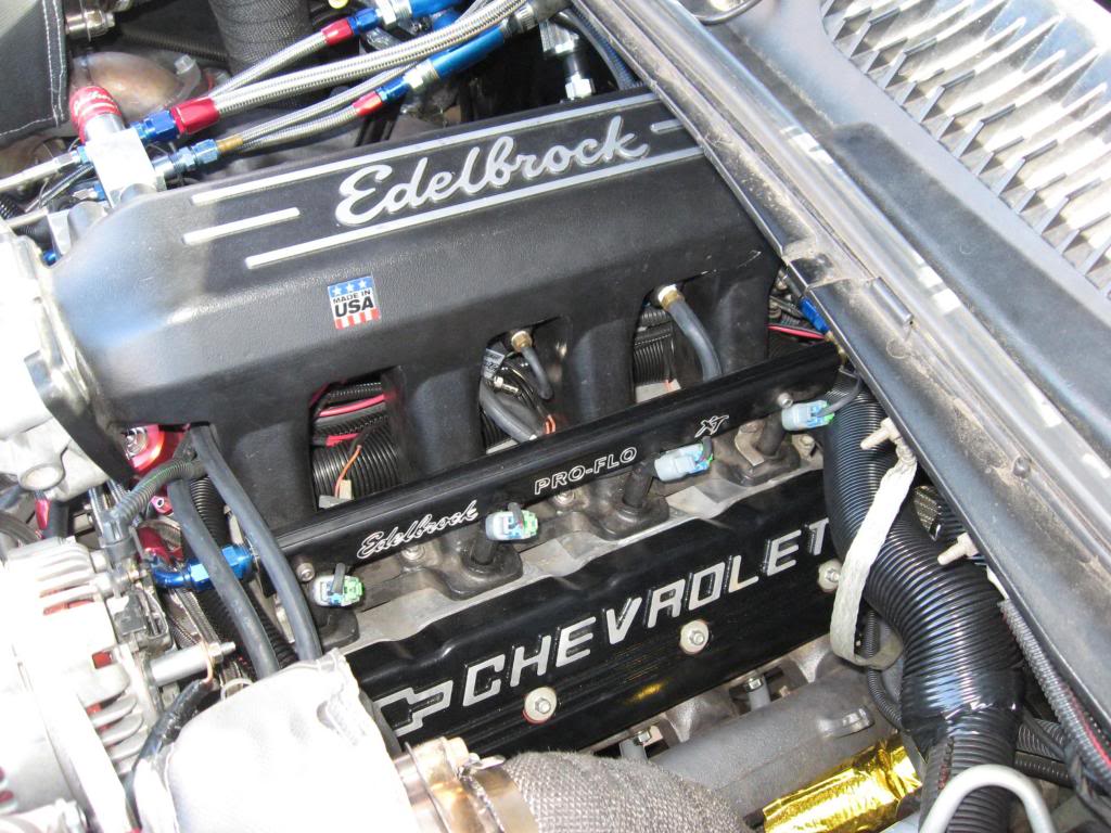

This is how the engine bay turned out

Old Mar 31, 2013 | 01:47 PM
  #227
chevyboy.520's Avatar
Joined: Mar 2010
Posts: 934
Likes: 7
Sick! The valve covers match the intake and fuel rails bad ***!
All that extra work and pain in the *** wire tuck came out extremely good!
Old Mar 31, 2013 | 06:39 PM
  #228
supercharged680's Avatar
Joined: Sep 2009
Posts: 948
From: Dubai, U.A.E
looks really good man!
Old Mar 31, 2013 | 06:51 PM
  #229
smokeshow's Avatar
Mod with training wheels
Joined: Feb 2009
Posts: 7,741
Likes: 207
From: Detroit
I could make yours fancy too
Also, this is unrelated, but...where can i find quality wire loom?? I have tried a few different types now and none compares to the factory wire loom. All of the stuff ive used in the past and recently has melted. My hydroboost lines with loom on them are line an inch from the turbo/pipes yet dont seem to mind the heat.. much higher quality stuff.
Old Apr 1, 2013 | 02:05 AM
  #230
Spoolin's Avatar
GFYS and STFU
Posts: 13,870
Are those valve covers what I think they are? They look damn good!!
That engine looks so familiar now!! LOL
