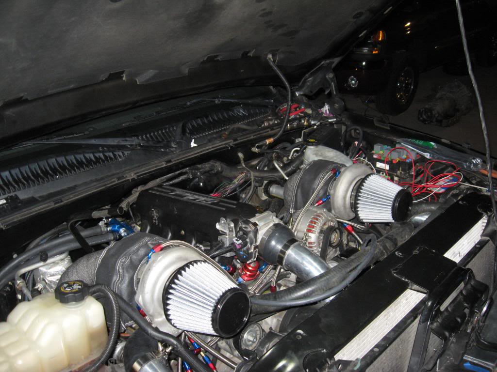

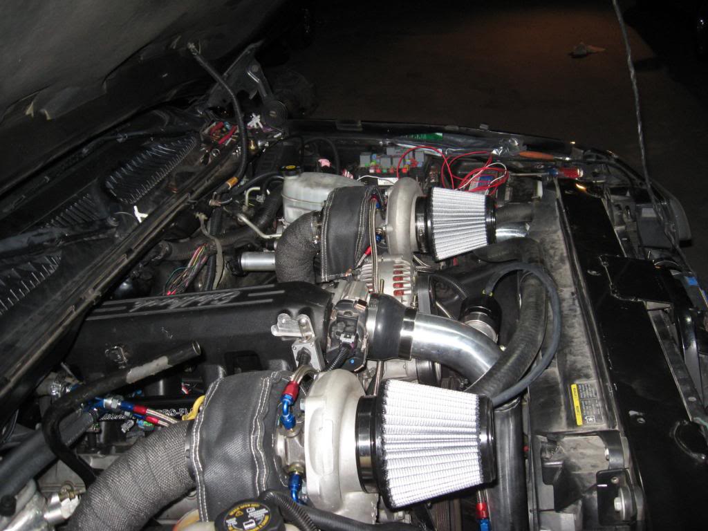

Here it sits, waiting for a transmission to beat up on...

Yeah it is chamfered. The converter is my old one, just a restall. So I have run it before. But not with the new billet input shaft, which is my guess for the problem culprit.

After a lot of deburring the input shaft last night, I was able to get the converter in far enough to measure the clearance at 0.987", which is within spec. That's without the input shaft seal, though...

More deburring today and clearancing the o-ring groove in the input shaft and the converter is finally in. It has been a pain in the *** lol...but the transmission is ready to install.
