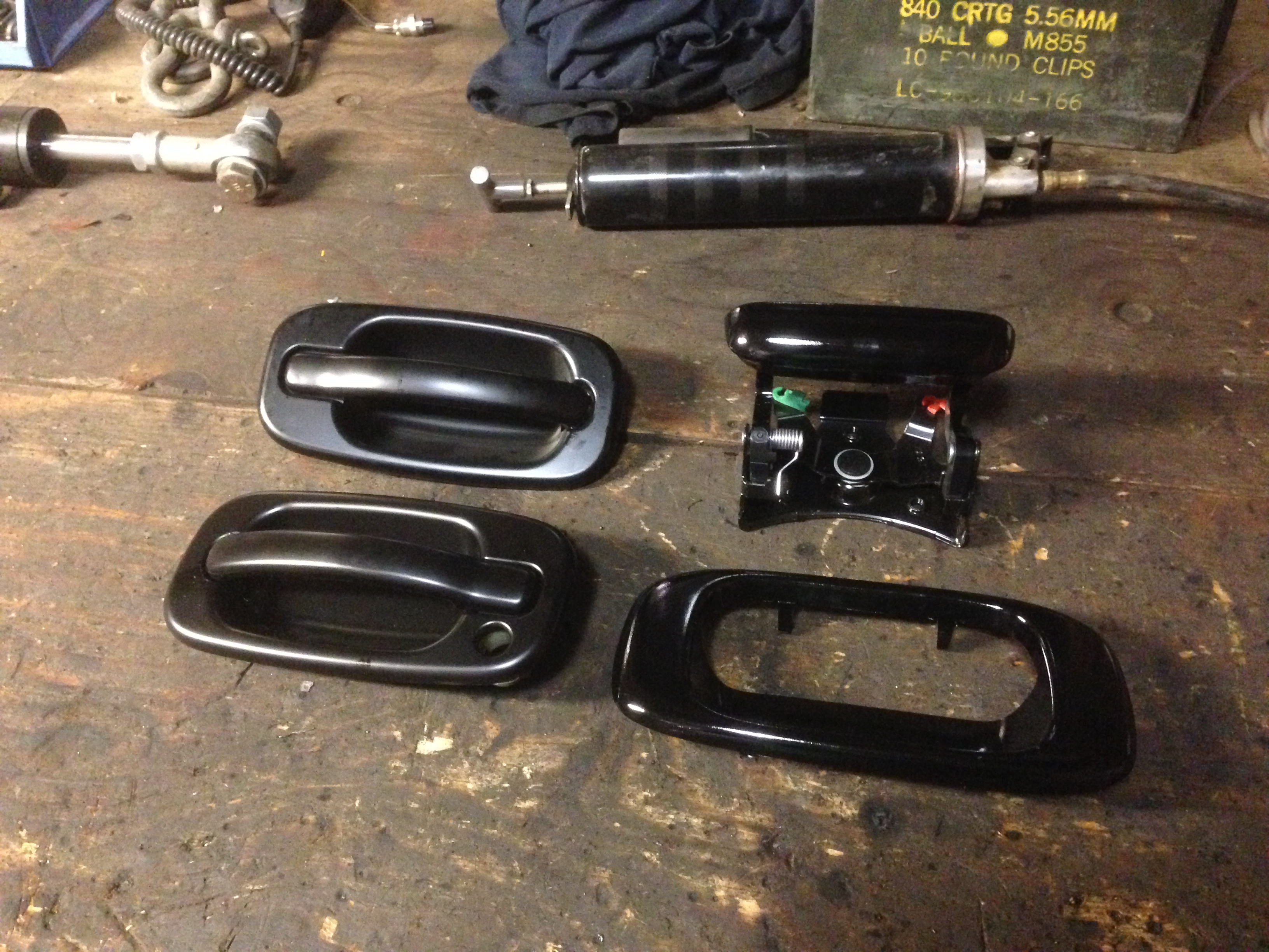

Picked up smooth door handles today, painted tailgate handle and bezel.
