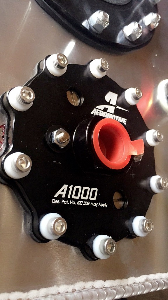

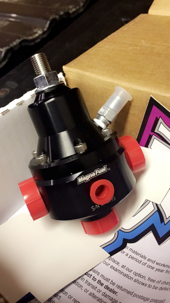

Got my Fuel cell, cell harness, and regulator. Should be able to start building all the lines tomorrow once the fittings and line get here. Went with a 15gal A1000 cell with a MagnaFuel Boost referenced Regulator.

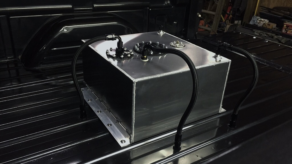

Got all the fuel lines built tonight currently waiting on the local welder to get back to me about welding brackets on my cell, once he's done I can drill the bed for bulk head fittings.

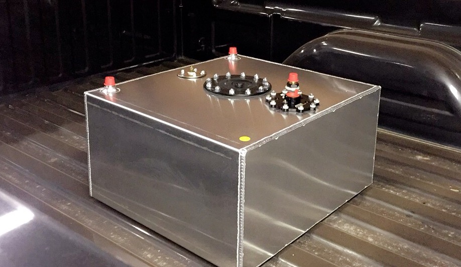

Got the fuel system buttoned up for the most part. Really happy with how clean everything is turning out.. Waiting on a battery tray once I figure out where it's gonna go in the bed I'll run the pump harness and gets the trans cooler installed

One thought. Shouldn't you turn the fuel cell 180 so the pickup/pump is at the rear? Just thinking about starvation on hard launches and sustained G's.

Thanks I appreciate it! The cell is baffled so I don't have any worries with starvation... As far as the ring gap is concerned I wanted to see what this motor was capable of without having to dig into the motor too deep, it was built with the intentions of being on borrowed time...The sooner it pops the sooner it get a 408 lol
