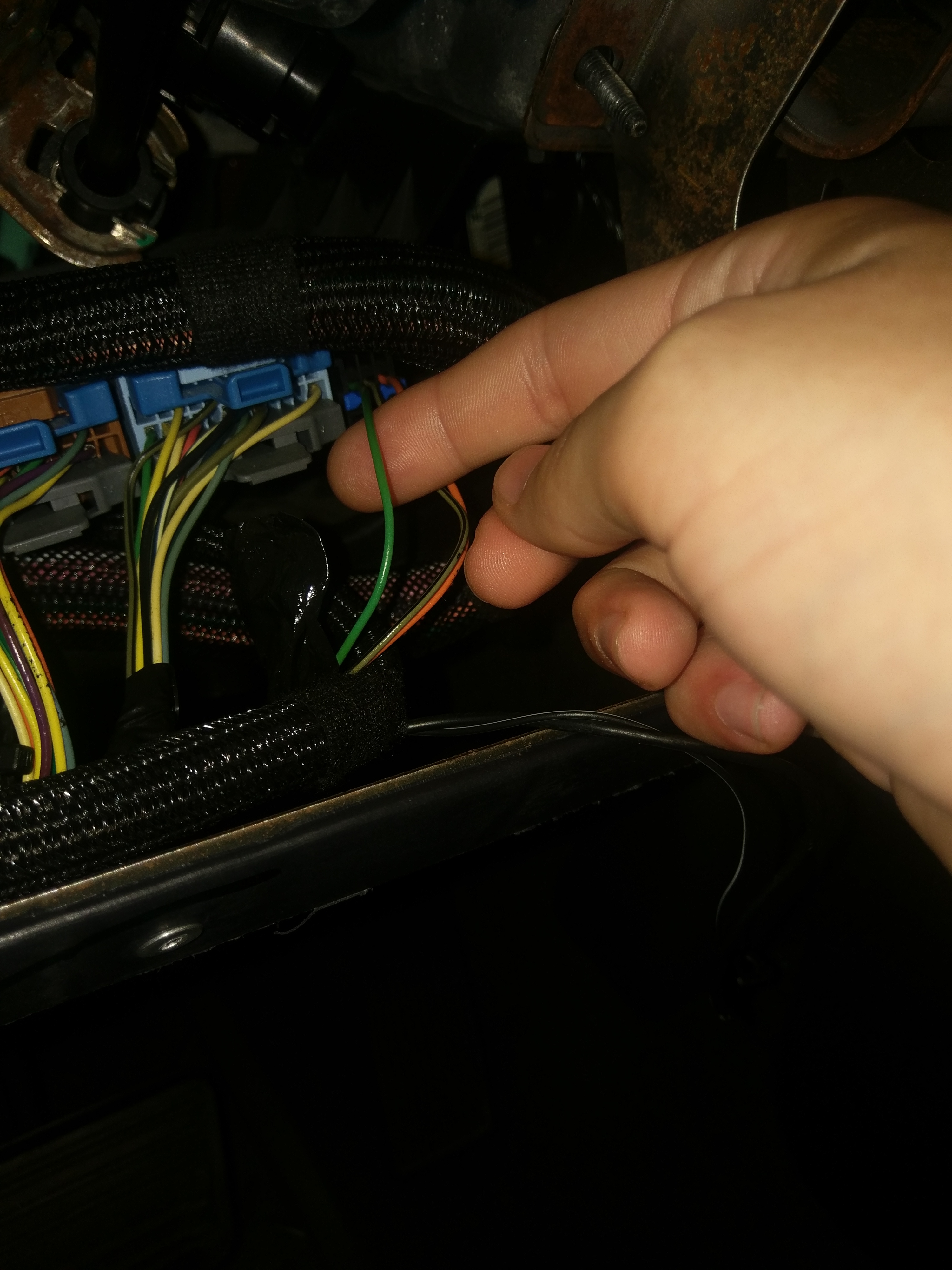

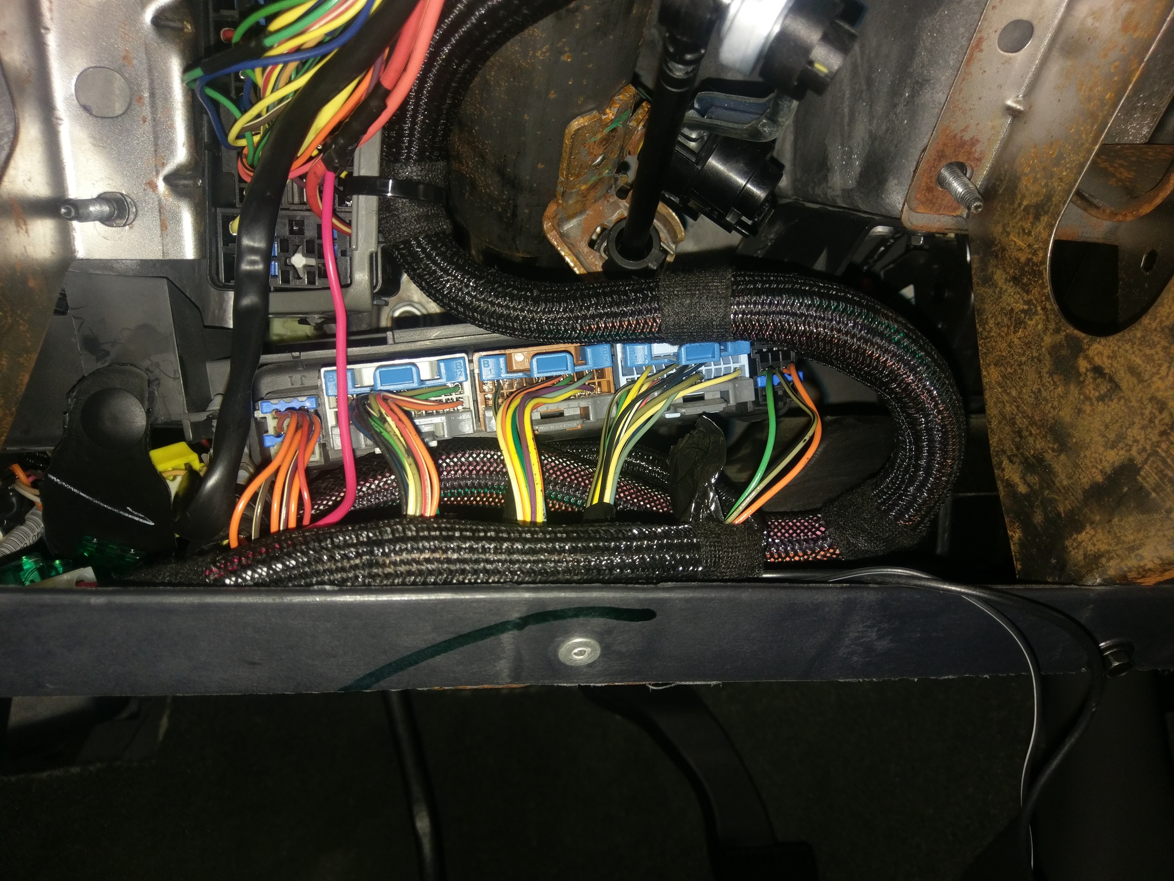

Here's the wire I used to switch my headunit to backup camera when my reverse lights come on in an 06/07 truck:
It's the far right BCM plug C5 and it's the light green one next to the gray/black

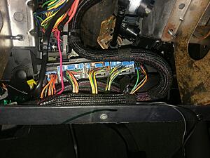

Originally Posted by ironcityboom
I'm finally getting to these reverse Lights but Im not sure if I'm sourcing the correct wire...I've tried to find pictures but it seems most guys talk about a lime green wire for the reverse Lights but all I have is this darker green wire(circled in picture) and isn't doing **** when I put 12v to it. I've checked the bulbs, they're good. Also checked fuses...unless I'm having a brain fart and missing something obvious. Possibly another source under the dash?

Edited my original post, I accidentally called out the steering wheel control wire
It worked!! Thanks man!!
