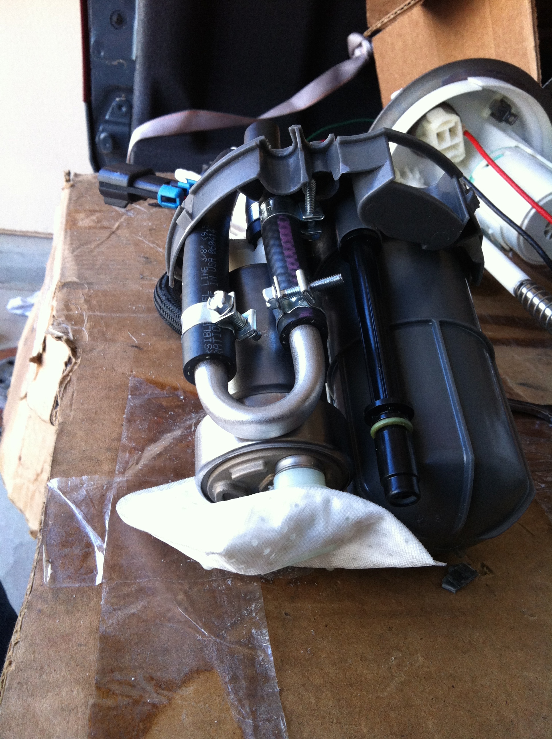

Whats up guys. I need some input. So like usual, I like to do things the hard way. I'm wanting to retain the stock fuel bucket and lid with my walbro 450. I was wanting to know what you all think would be the best way to connect a fuel line to where the factory pump connected to. Now remèmber the factory pump is held into this fitting with a bracket so the pump can't come loose from the fitting. I was wondering if just a fuel line hose clamp would be enough to hold a fuel line onto the fitting without poping off from the fuel pressure. This fitting has no barbs on it. And go figure, the expensive as submersible fuel line I bought is to big for this fitting to make a tight seal. So any ideals would be great. The fitting is where the flat head screw driver is pointing at in the picture below.

Hey all, I just wanted to let you know that I finally got my walbro 450 installed today. I started it up and let here run for about 5 minutes and then revved it a few times and everything seems fine. I will take it for a spin tonight. I ended up installing it the way I wanted to. I was able to retain all the factory stuff such as the fuel filter and fuel pressure regulator. I have it installed in the bucket with the sock at the bottom and the bucket lid snapped on. Will ad pictures later

Drove the truck to the gym and back. Still no issues or check engine lights. Put the truck under full boost for a quick second and I didn't notice any issues. So far so good!

Did you do anything with the plastic nipple to keep the hose from sliding off? Did you flare the ends of the metal tubing?

The metal tubing is actually stainless steel 180* barbed fittings for soda machines haha. For the plastic nipple, it just heated it up a little bit and pressed a punch into it to add a little flare to it, and put the clamp on really tight. I tugged on the hose and couldn't pull it off the nipple, so I think it will be fine. That was really the only thing I was worried about. I also did some cutting on the lid to make room for the lines to come out and go back into the bucket.
