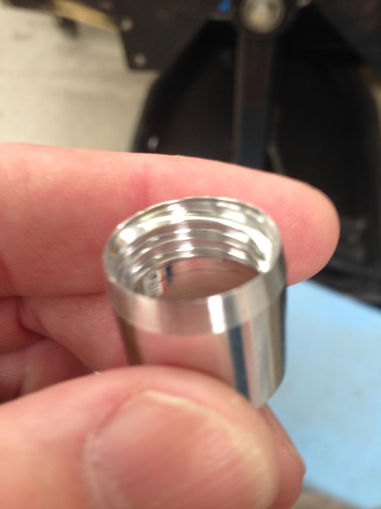

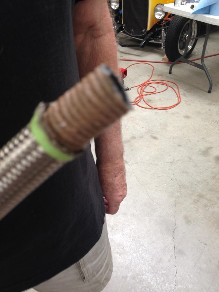

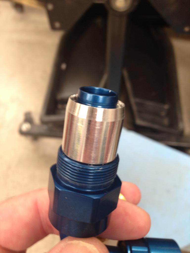

Now if you want the best of the best AN lines check out these bad-boys. The hose you can tie in a knot and it does not kink. The liner just pulls out of the braid. Because the liner is corrugated. Then the olive just screws on the liner. Super easy to use. Only problem is it is insanely expensive. The damn catalog does not even show prices. Supposedly this is what nascar uses. My buddy used them in his fuel car.

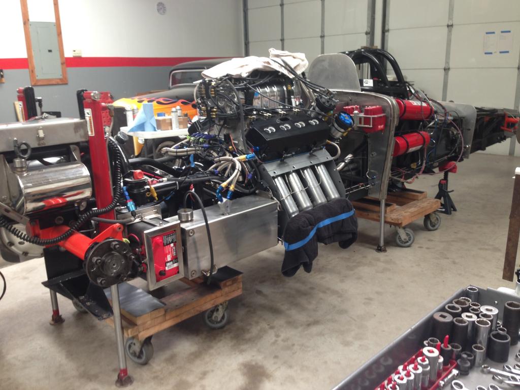

You can see them in this pic. They are blue and gold (kinda gay thou)

Those are Brown and Miller fittings. Yes, they cost more, but there's a reason they do. In the future I will only use those or Aeroquip.
