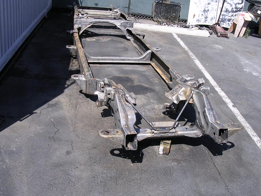

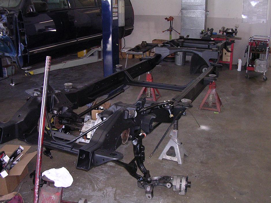

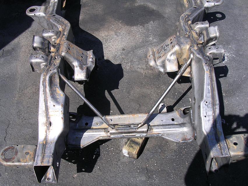

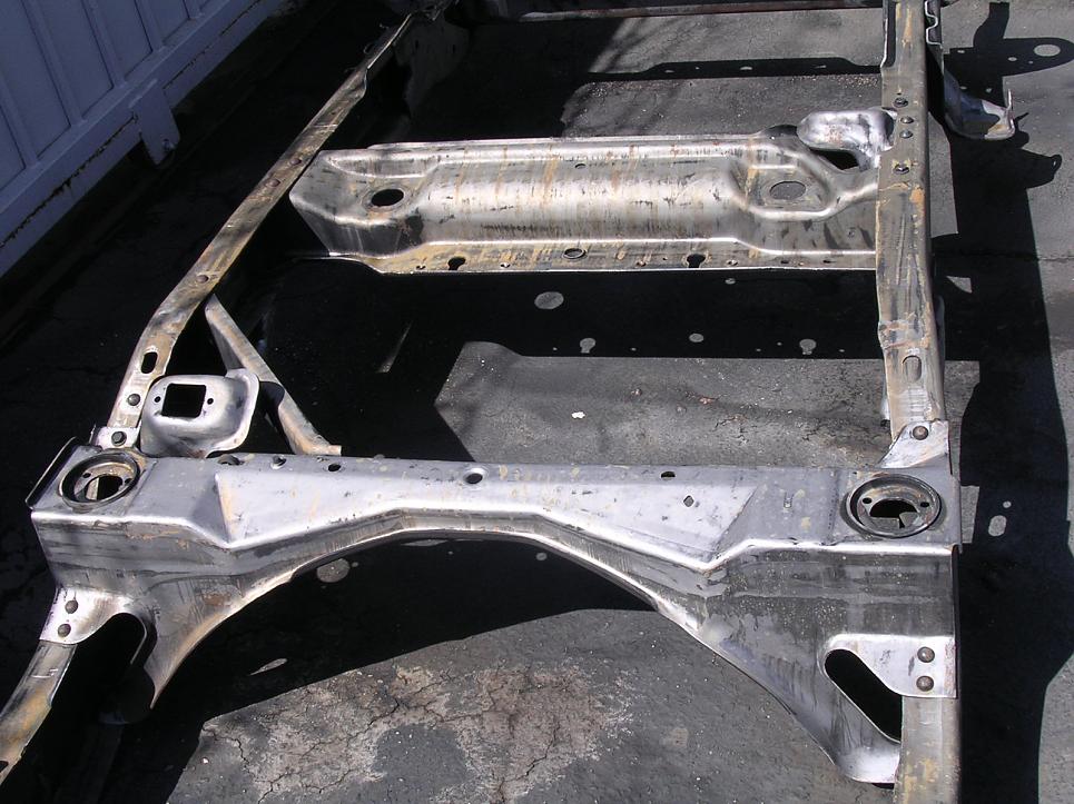

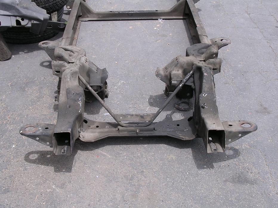

That's easy to remove. I am the same way about my stuff. I did it on my 99 suburban. A Hot Water pressure washer does the trick. It comes out at around 200 degress and around 3000 PSI. You need the heat, a standard pressure washer will not do it alone. Then a quick trip to the Media blaster gets it ready for paint. I only have a few pictures but I think you get the idea... My media blaster guy was impressed. He didn't wanna do it at first because he thought it would still have that crap on it here and there but once I explianed That I had it completey stripped to bare steel He said bring it by and he would give it a shot but would not make any promisses. When it arrived He asked if I had it acid dipped or something. I explained what I did and how it cleaned so well and he was impressed. It was well worth having it Blasted. I started trying to clean and sand the frame my self but It was going to be big $$$ for all the sand paper and Wax and Grease remover. It was way cheaper and less time consuming to have it media blasted. When it came back I only had to touch it up in a few spots from moving it around and it went right in to the both...
I do all my own work with the exception of things like Blasting, powder coating, and Specialized Machine work. And thats only because I don't have the equipment.
