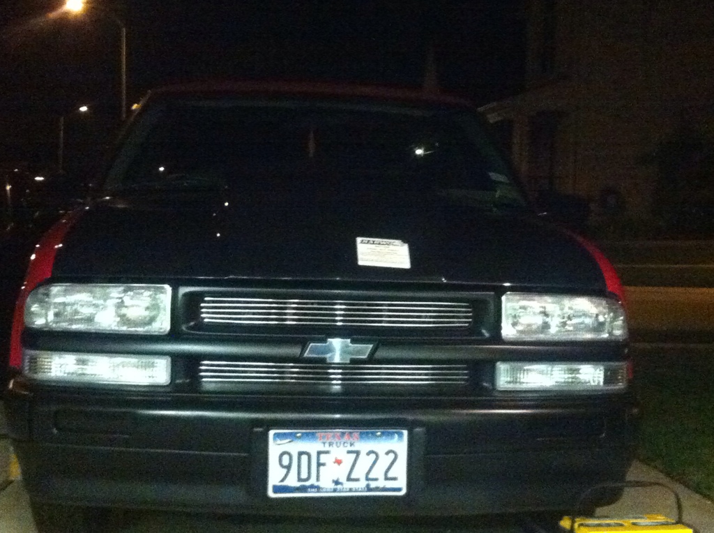

Its bad when you dont remember ordering parts cause they always seem to be coming in. Got back from gym and there was a box...wtf is that? Didnt even remember ordering a billet grill
