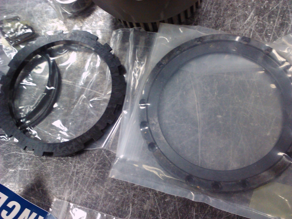

Billet apply and pressure plates for the 3-4 clutch. This clutch pack will have 9 4L65E .062 frictions with 8 .077 kolene steels.

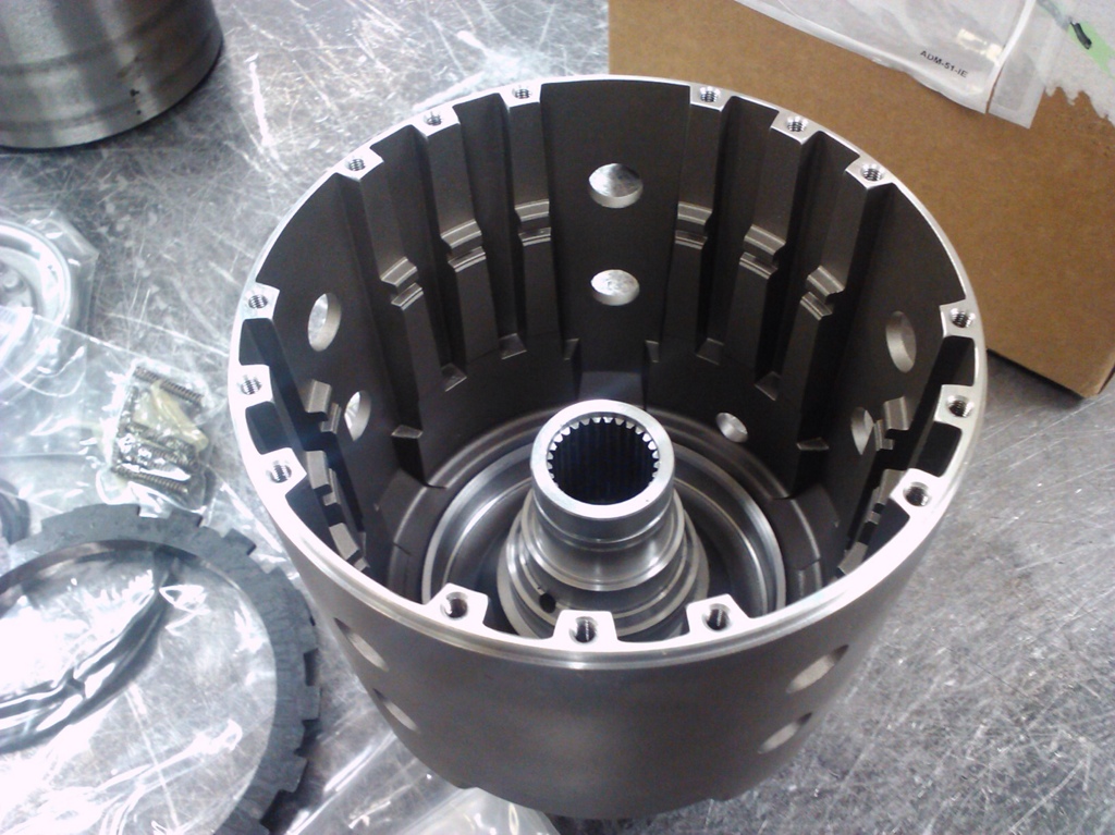

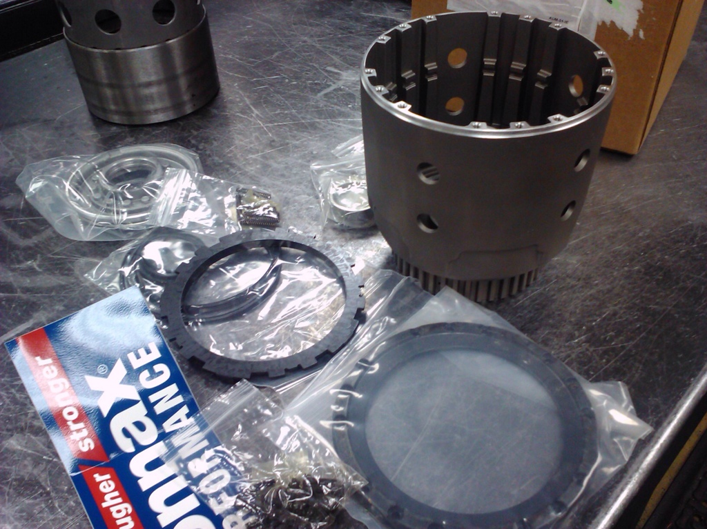

Picture of the inside of the new sonnax drum. Here is some more info on the drum. http://www.sonnax.com/system/announcement/77733-06K.pdf

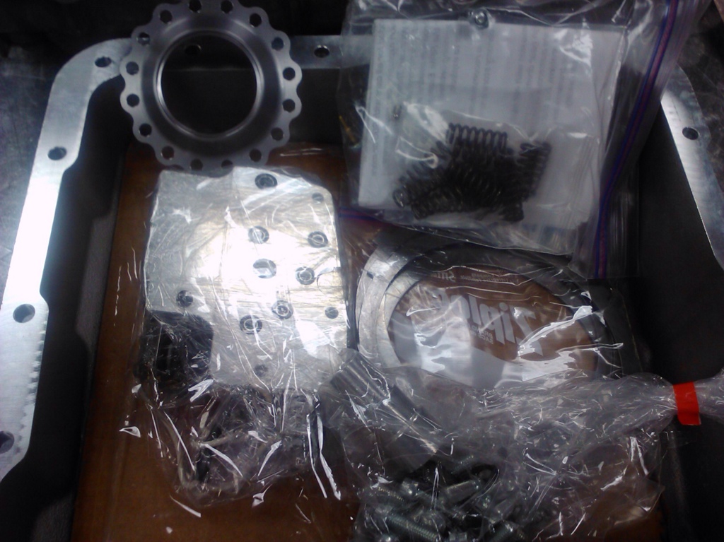

Trans brake kit from Rossler. Includes springs for the reverse input drum, brake solenoid manifold body, billet reverse input spring retainer, new aluminum oil pan with bolts and modified low reverse steels.

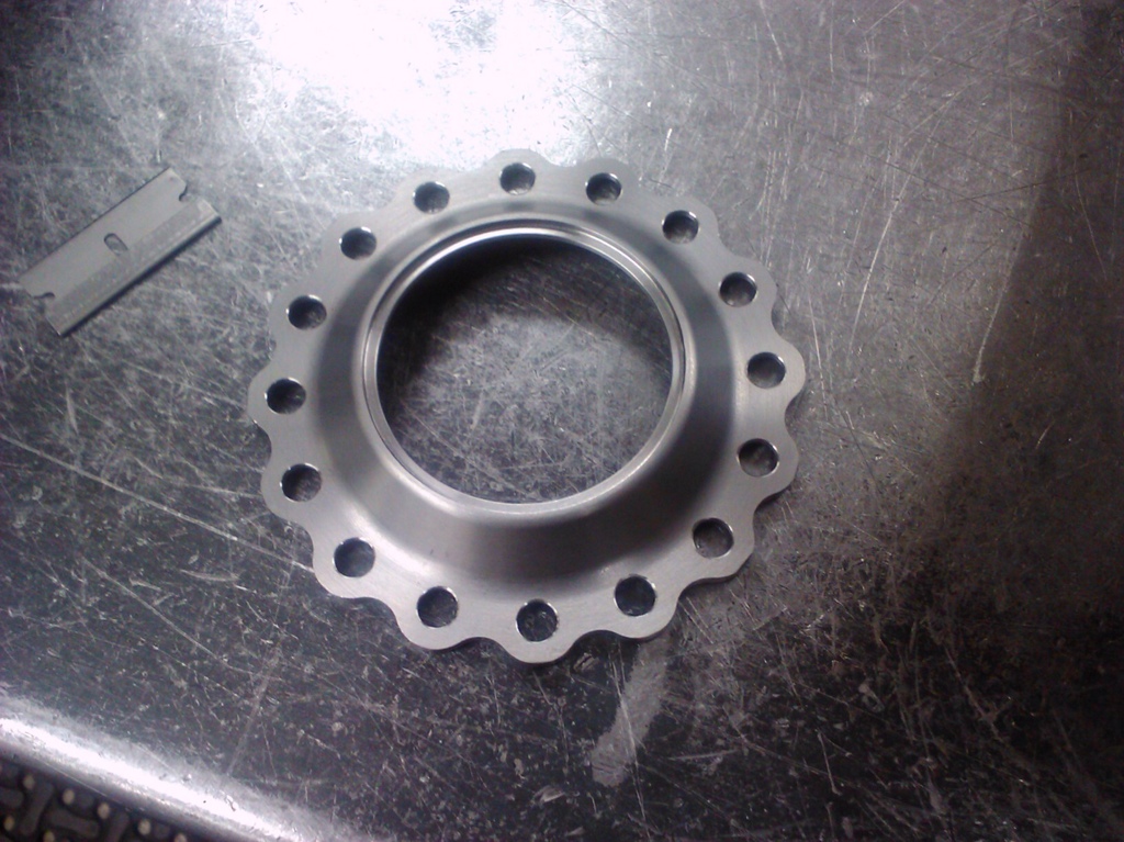

Billet reverse input drum spring retainer.

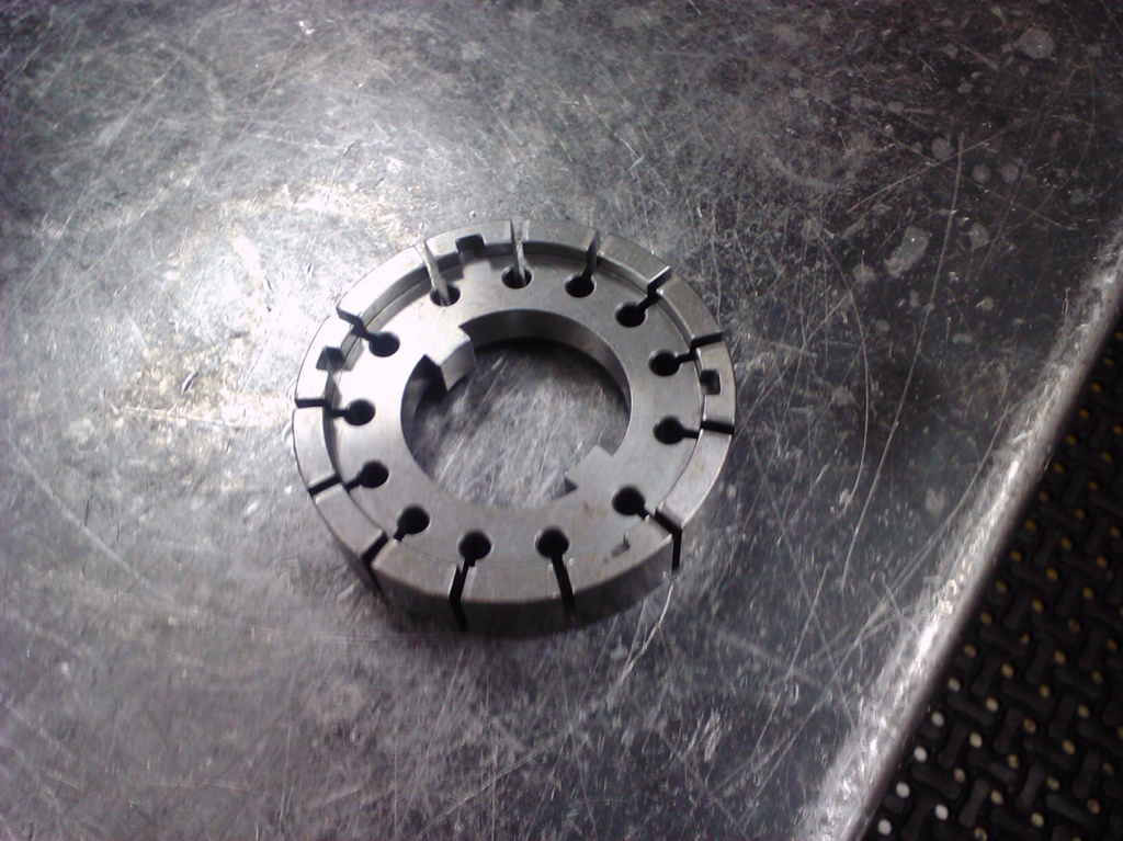

Billet pump rotor.

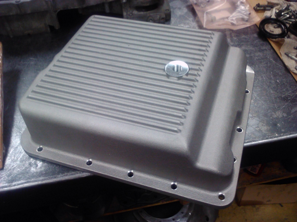

New deep aluminum oil pan that will allow clearance for the brake and will also be tapped for a pass threw connector for the brakes power supply.

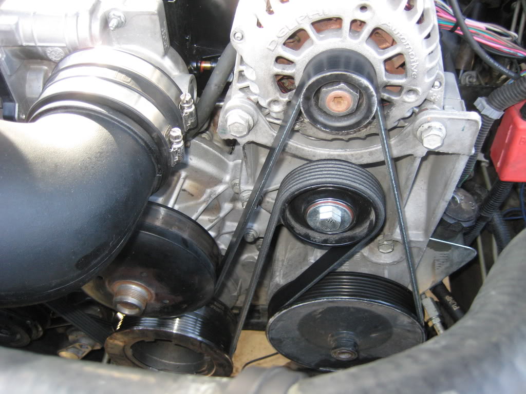

Nice!! Hey did you get the bracket modified? I did it a different way when i had the ls6 intake. Basically it is a pulley from a vette that you mount to one of the holes in the bracket with a lomger bolt and some washers behind it. You can have it if you need it.

i used the same method when using the ls6 and fast 92mm intake but used a much shorter belt routing. if i have the room, id rather just run an OEM belt routing. traded my modified alt bracket for a stocker today. i will cut off the portion where the power steering pump.

Bracket modified.

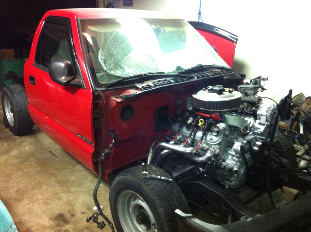

having a celebration beer now. some things make it feel like you're actually accomplishing something. got the trans crossmember completely bolted in today and finally dropped the cab back down to the frame. all of the a/c **** wouldnt fit with these headers. i removed it for now and will get a sheet of aluminum cut to clean up the fire wall. i still plan to run A/C and heat on this truck...it will just have to be something besides the OEM stuff. we put a vintage air system on my dads 32 coupe and it will freeze you out! and is VERY clean under the hood too. i may end up going that route. anyways
