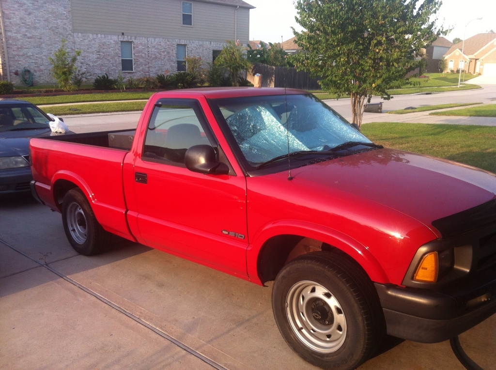

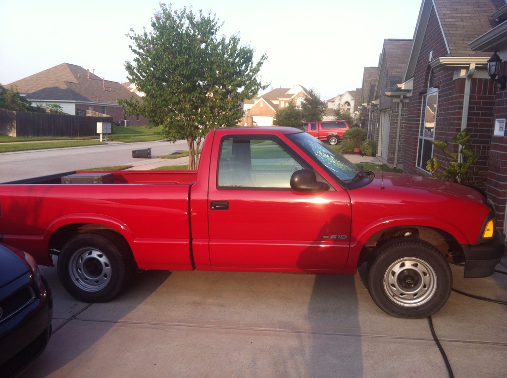

no new pics of the motor, but i did get some day time pictures of the truck. i havent touched or washed the truck since the night i picked it up so it's filthey but daytime pics are better than that blurry crap i posted in the opening post.

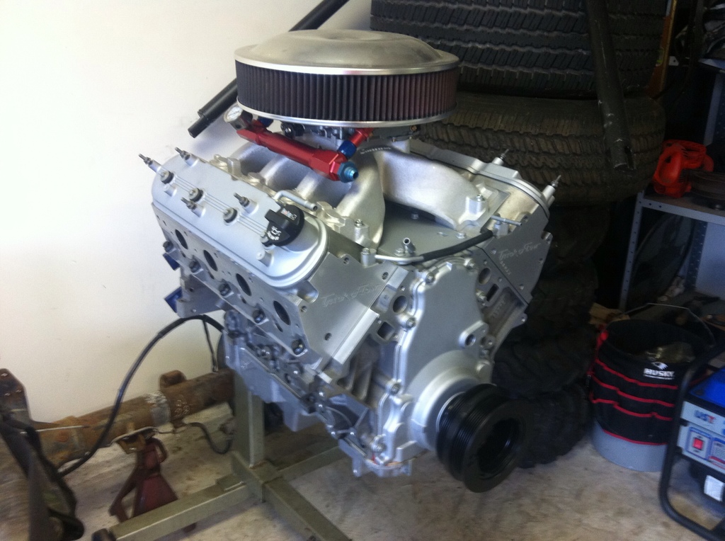

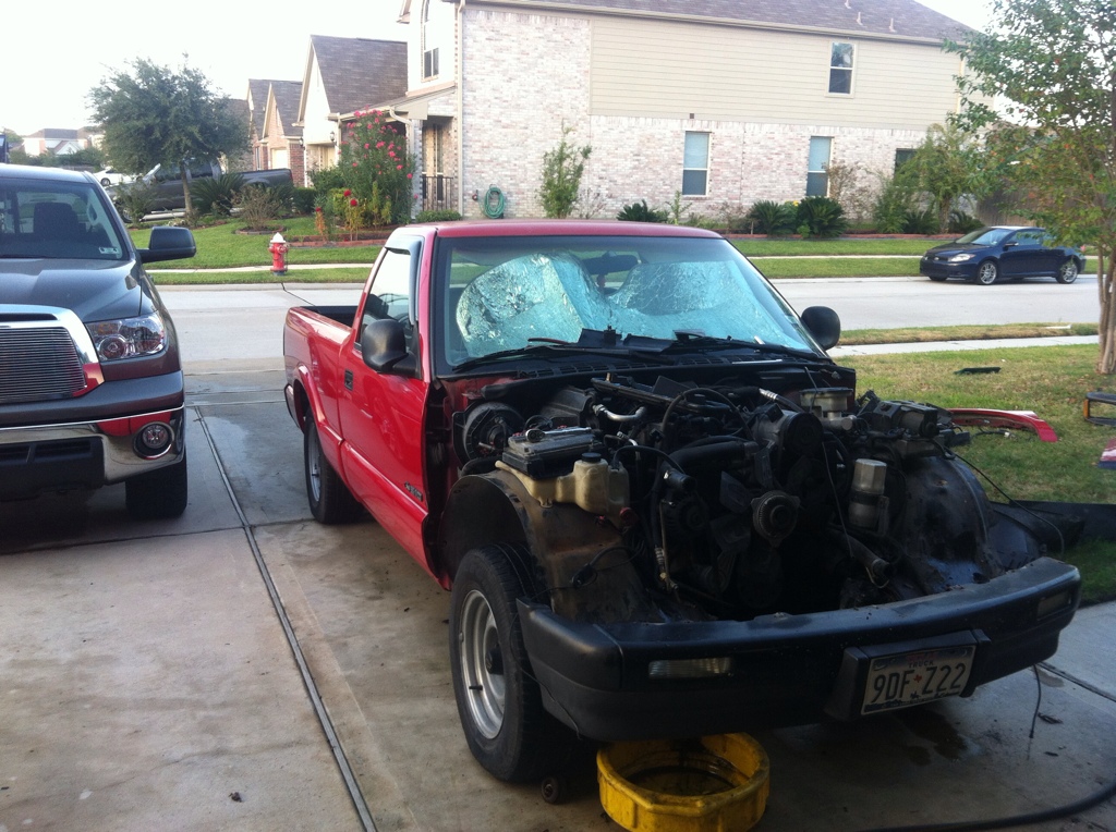

I'm drooling over that motor. Puurddy!
