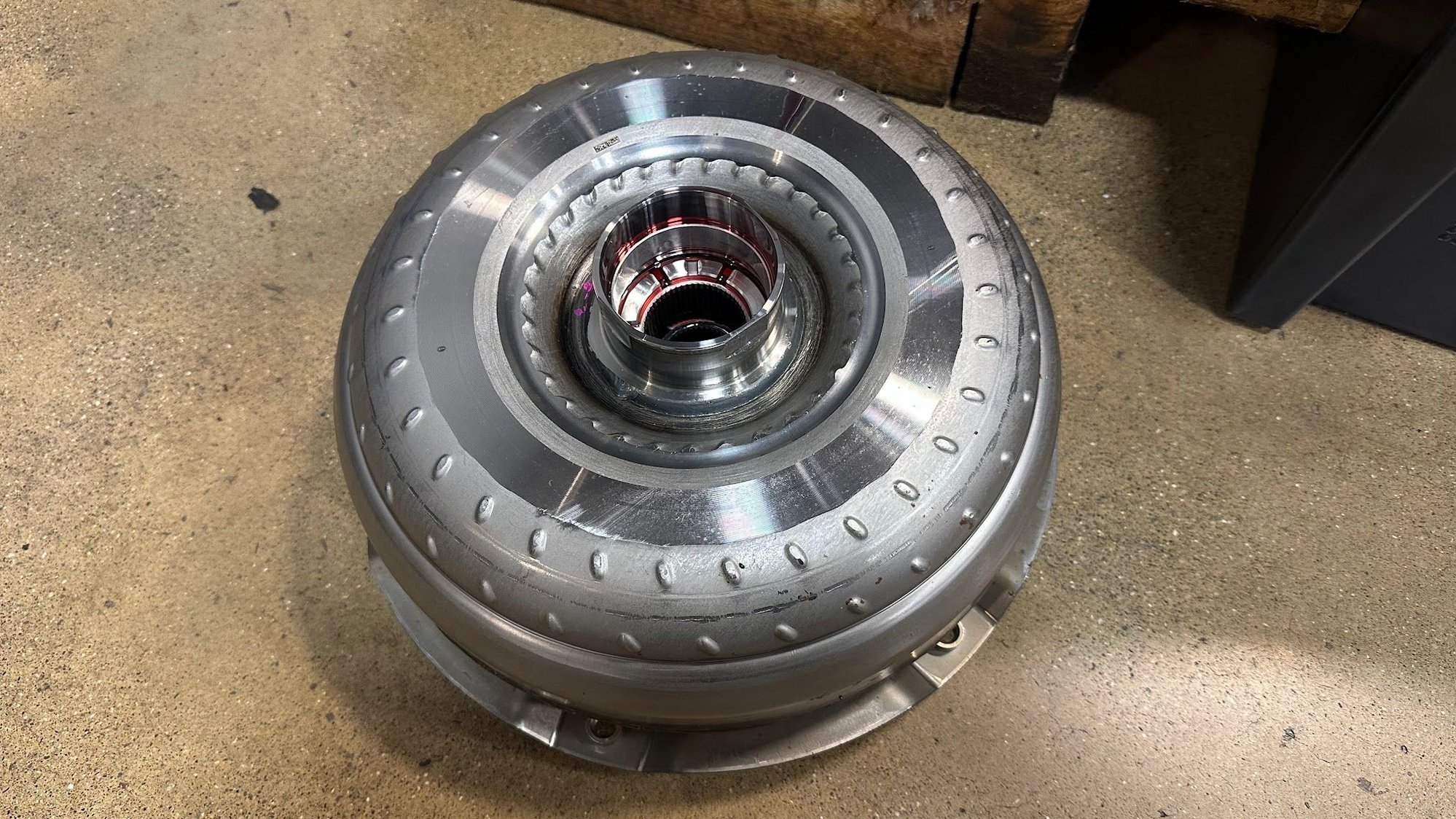

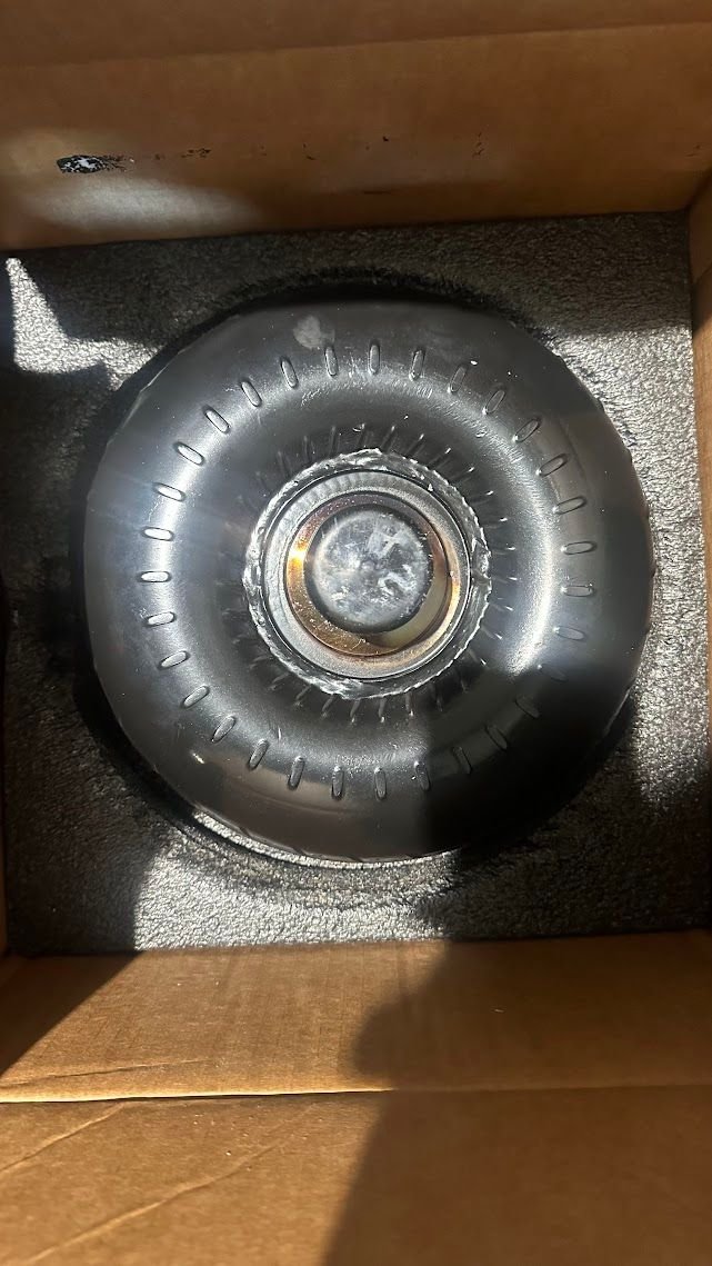

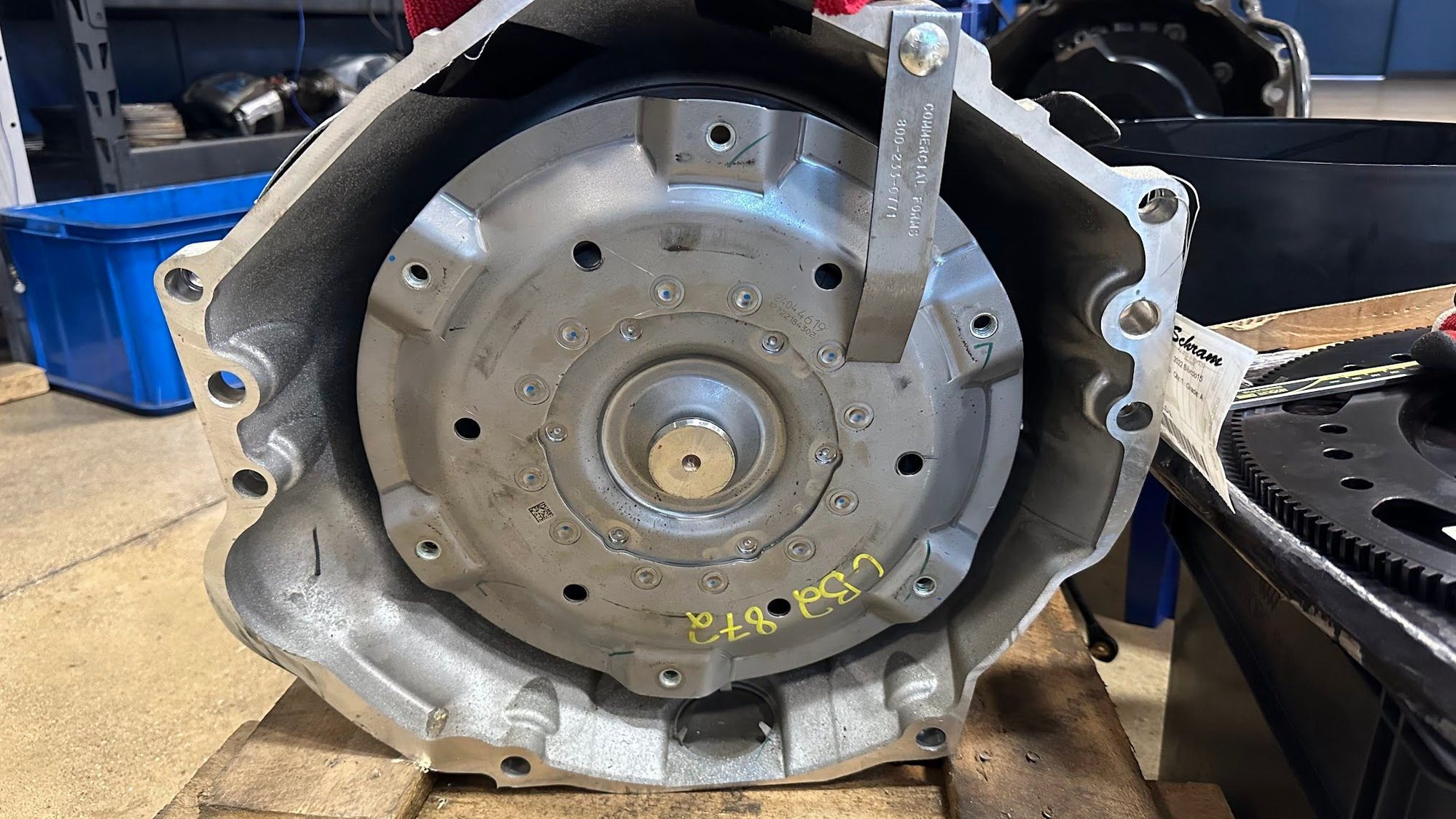

The latest gen TC on the 10L has recessed mount points, making the circle D conversion flex plate unusable as it has a pretty thick center section...i really liked the Circle D plate but unfortunately cant use it.. Was told the older version 10L TC is flat in the middle and the Circle D plate will work.
Had to get the TCI as it has bosses sticking out allowing the TC to fit. WIth that said, have a Pro-torque 6L80 TC and a circle D flexplate for sale.
Few pics comparing the 6L and 10L TCs

That’s cool. Thanks for the detailed info. Why did you convert to the 10L?

The 6L with the high stall wasn't really the funest to drive around town. It lost the snappiness of a blower car unless you really rev it up...maybe I went too aggresive with the protorque...this 10L is lightning fast at shifting, can skip gears downshifting, more aggressive gear ratios which i really dont need, but I enjoy tighter stalls especially having the torque of the stroker/blower with the 4.10 gears.
