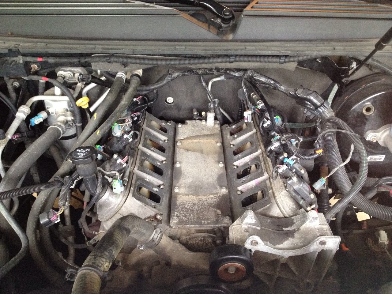

Not sure...not break anything? haha...working in the automotive engineering industry and dealing with the driveline engineers you hear everything...all of them are looking forward to the transformation but all say watch your dead stop WOT launches...these 6.2L can make some low end power stock, and with a 2.3L maggy on top its not going to make it any easier on the stock driveline components...with that in mind...here is the progress so far:
Started at about 5:30-6pm,
Let it cool down for about 30 min...and intake was off
Some part removals...lowered truck made things a lil easier to remove but still not as easy as on a smaller car...

All we got left to do today is install the front heat exchanger and pump and actually run the wires from the fuse panel to the pump....load the tune from Justin @ BB on the EFI live and tune it....
Only issues we had was loosing a injector adaptor which ended up falling air filter box hole and ending up on a corner at the bottom of the bumper...grrr
Had to put a few spacers on the drivers coil pack bracket to lift them up a tad to clear the fuel rail elbow connector.
Also found out that i cannot use my Banks Power intake with the Maggy...it locates the MAF too close to the intake tube so i had to use the stock air box... :-(
