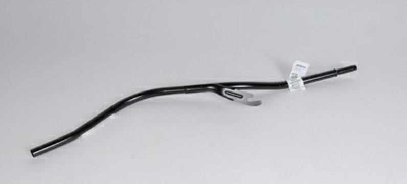

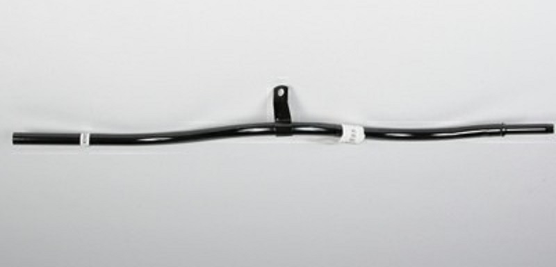

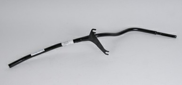

My FLT 80E came with a similar tube to the Rock Auto listed 2000 tube. Grabbed these pics and part numbers off of Rock Auto.
90s tube # 15729870
2000 2500 tube (listed for later years also in some online searches) # 25789571 edit: turns out this is actually the 60E tube...can't trust Rock Auto
2001 and up 2500 tube # 15019779 according to Rock Auto
90s tube # 15729870

I used the tube from the middle picture on both my 2005 80e which I cooked and the pre 97 that I received from Chuck.
With the tube from its corresponding vintage both dip sticks will hit the limiting plate. At that point the full marks are exactly at the same location in relation to the valve body
What we have found over time here is that the correct combo of dip stick and tube will slightly under fill the trans for our needs. Your combo of an older dip sick in a newer tube will fix that factory under fill problem as you show in your pics of your own fill mark. In a stock truck that hits no where near the g forces that yours does, their fill marks are ok. But we create some tricky situations. Fluid sloshing backward is a huge problem for us. A deep pan fixes that but as you know randy being awd there are a handful of reasons that doesn't work for us.
