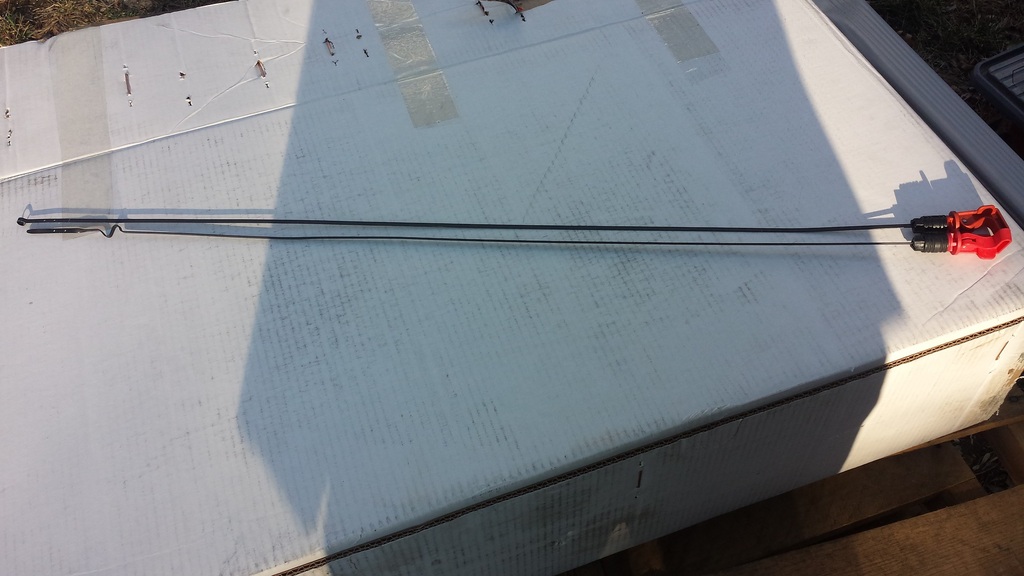

Mystery solved - at my own expense of course! Chuck from FLT suggested the pre '97 80e but failed to tell me the dipstick was a different part number. Just came in today from Chevy - a special order.

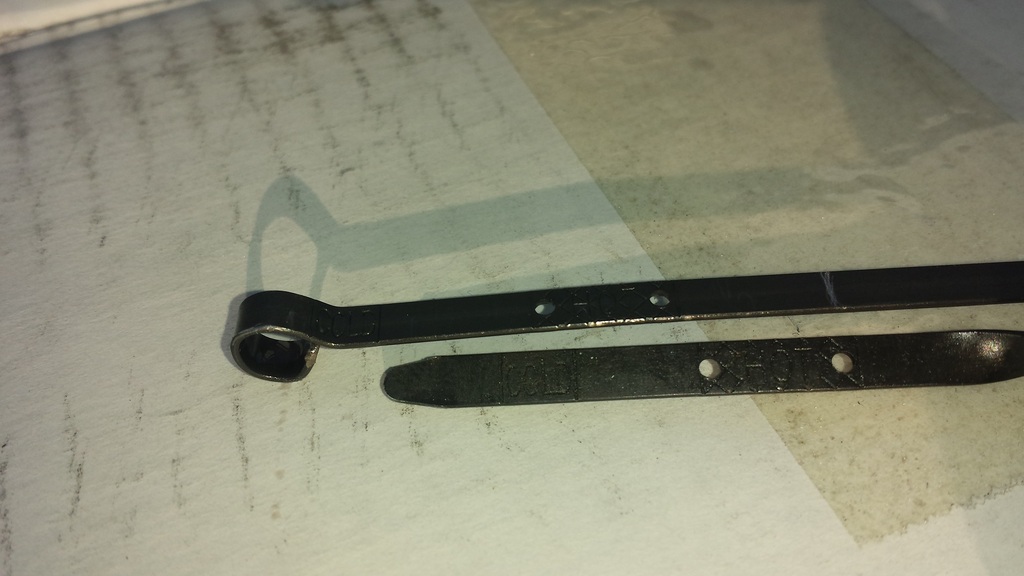

Note the witness mark I made on the "97 and later 80e dipstick after pulling the pan last weekend and marking the correct fluid level.
