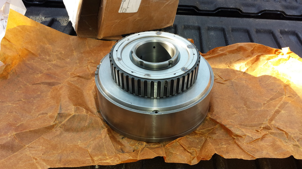

I've already bought all the parts and will be removing the Coan gears and billet shaft from the FLT and installing it in this one...
Custom 36 element intermediate sprag
High performance Alto Red Eagles

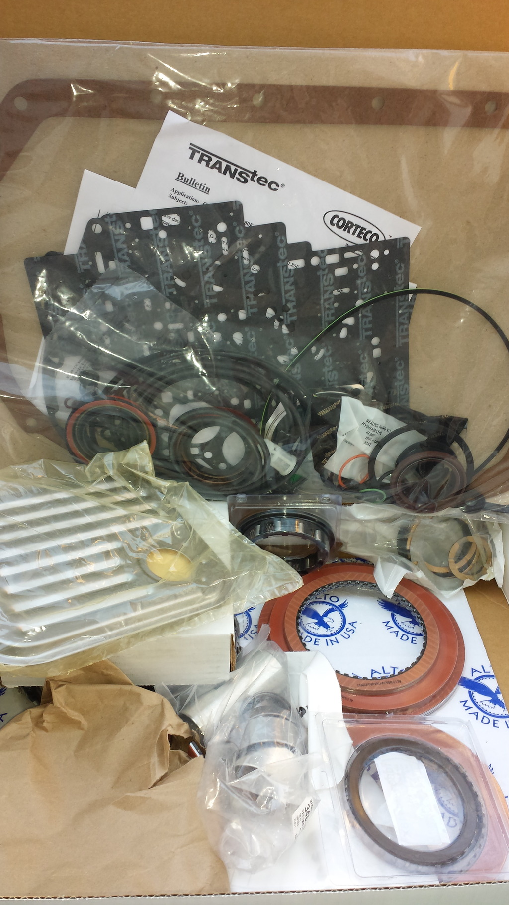

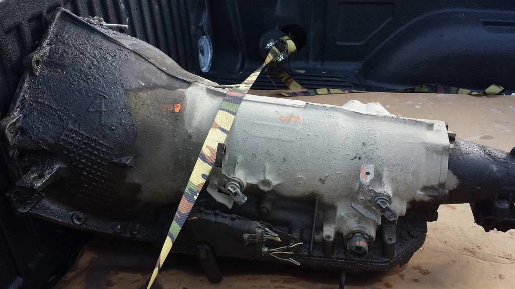

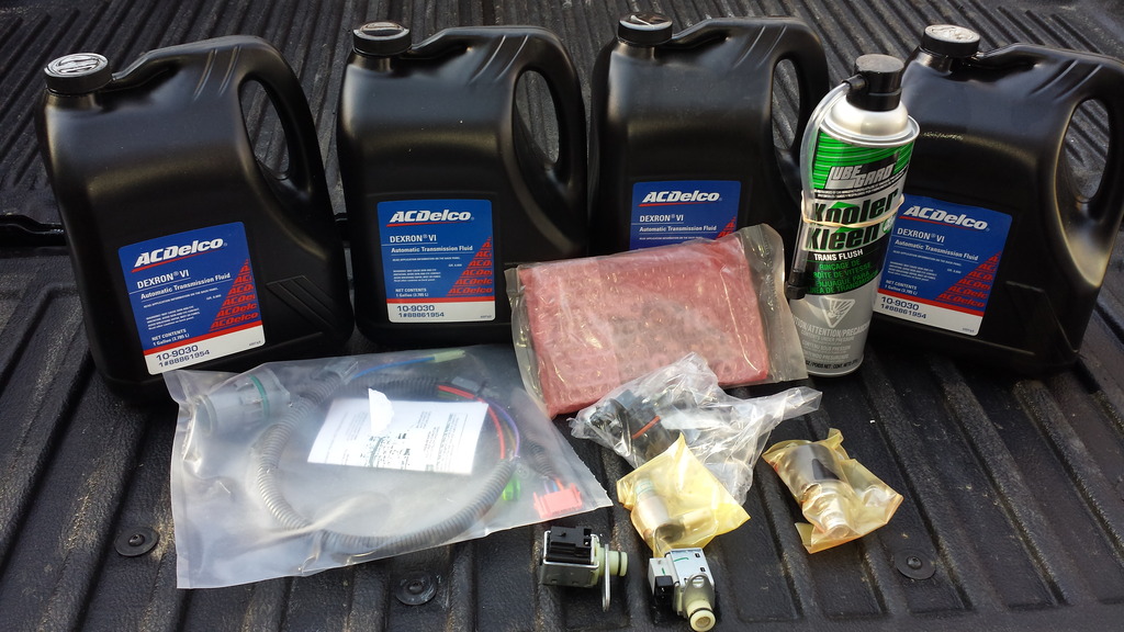

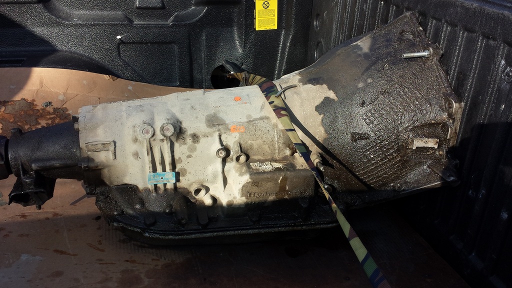

I only ran the truck two WOT pulls with it low on fluid, then added one quart, did another run - no change, added another quart and still no change. Once I came to realize it wasn't going to get any better, I luckily found a '95 80e out of a GMC 2500 that had a blown motor. Picked that up last week and ordered all the parts the same day - the custom drum and sprag was the last to arrive today.
Dropped the trans off Saturday and he's picking up all the parts tomorrow. Hopefully within the next week or two he'll have it finished.
