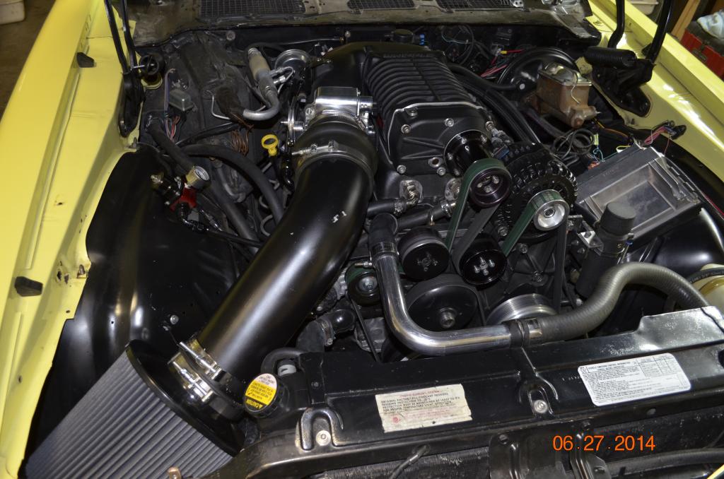

Made mine out of aluminum. 5" diameter pipe. Largest AEM Dryflow filter made with 5" inlet. Used a 5"-4" coupler on the TB.

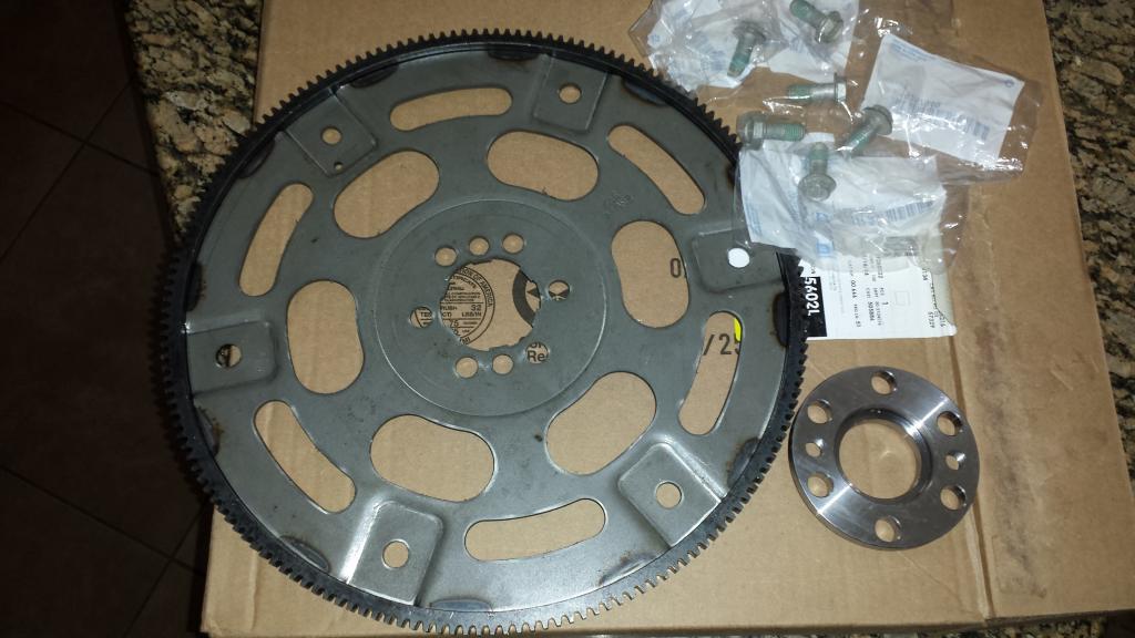

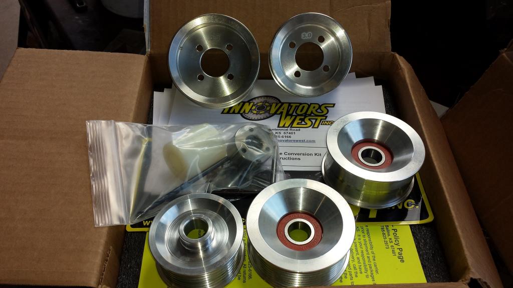

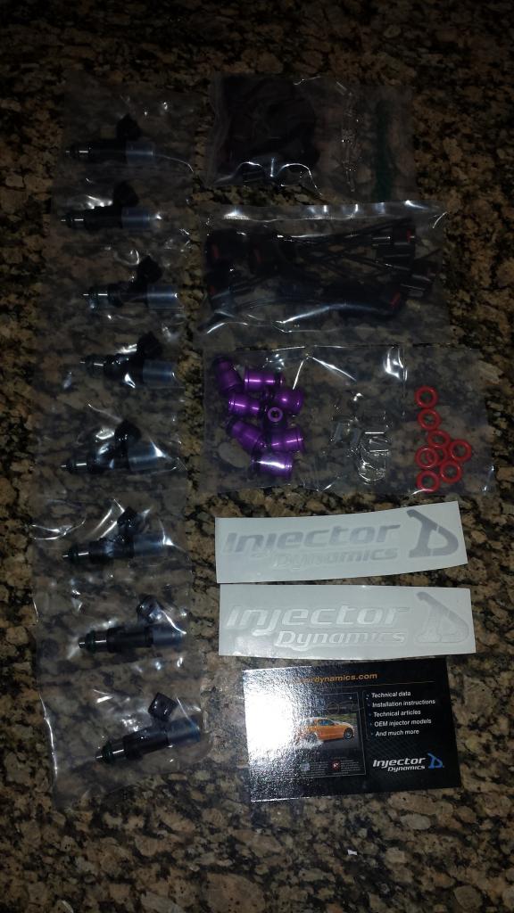

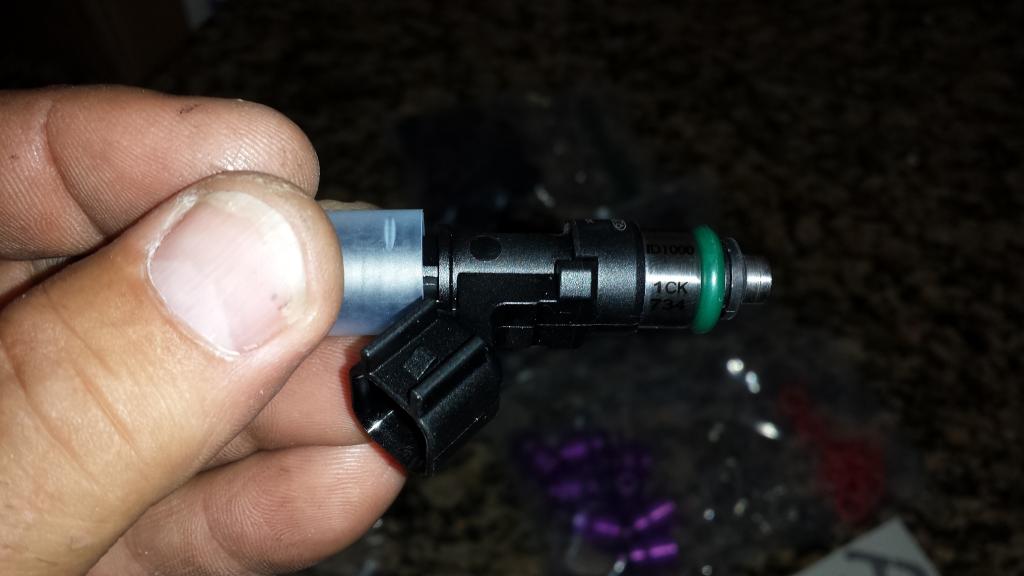

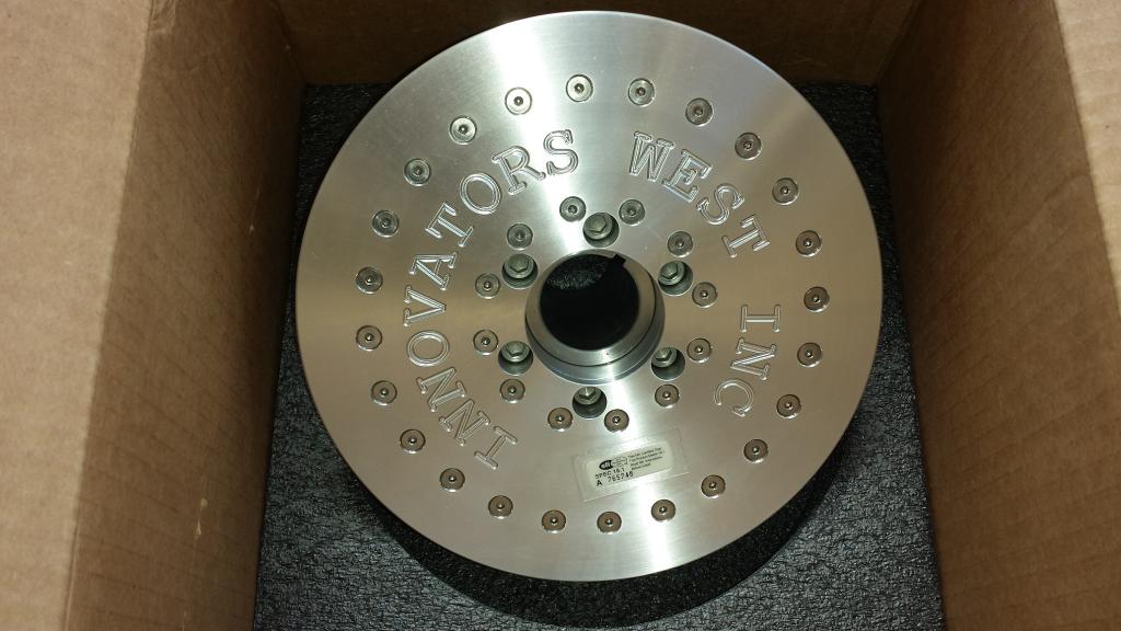

A few necessities showed up today on my doorstep...

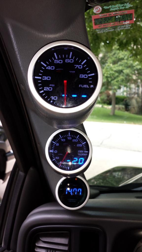

got my gauges installed today too...

Looks good, does innovators west make those blower pullies also? Gauges look good.
Old 07-16-2014, 09:09 PM
  #120
L8ERBRO's Avatar
Join Date: Jan 2014
Location: Olathe, KS
Posts: 341
Received 0 Likes on 0 Posts
Yeah, now I just need to figure out what size belt to get!
