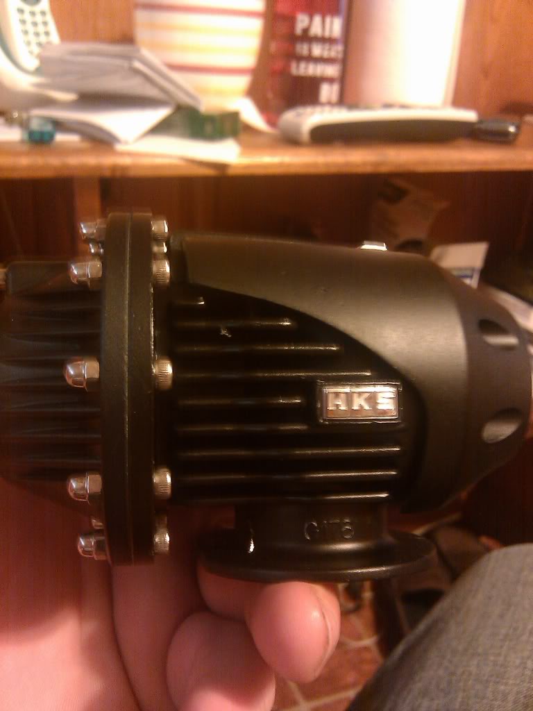

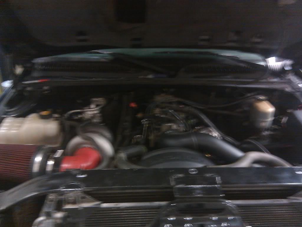

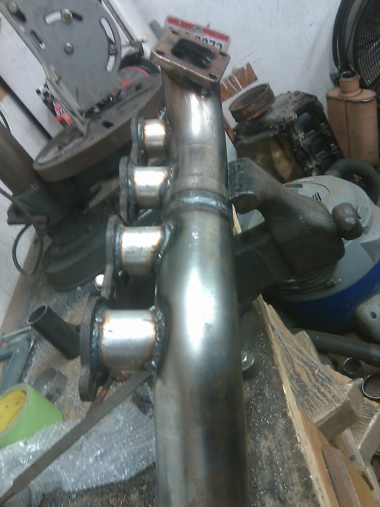

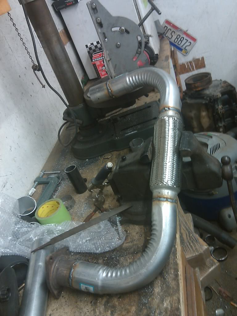

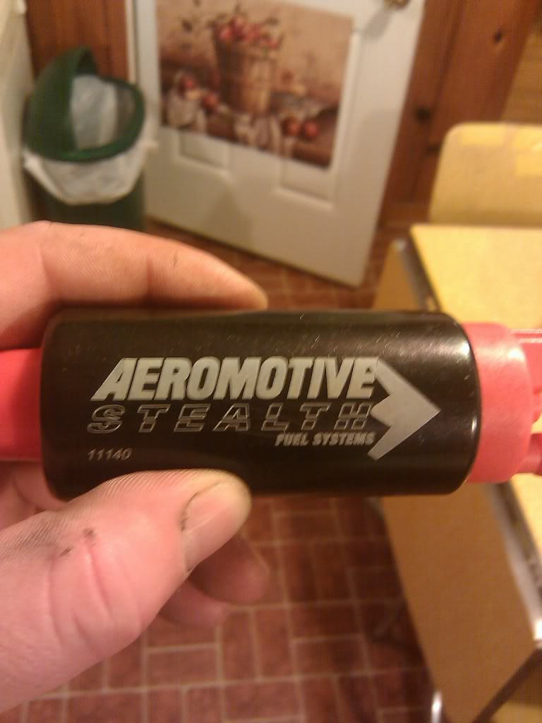

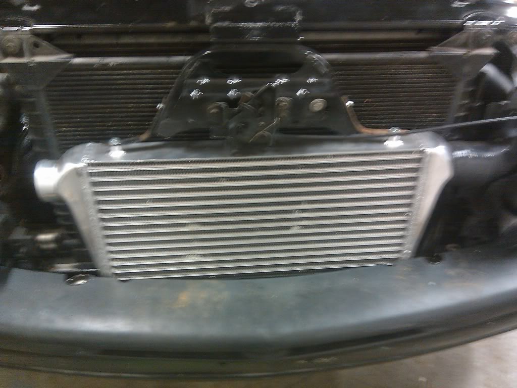

Ive been here for awhile never done a build thread so why not. I bought it awhile back its just your basic 210xxx mile 5.3 rcsb silverado. I did the basic upgrades and all the free mods muffler tune cat delete cold air intake and a 100 shot. well after blowing up the stock 4l60 trans i wanted something with alittle more stregnth to it so I installed a built th350 and bumped the jets to a 150 and loved the truck. well just like everyone else i cought the turbo fever so i had no choice. ove the past month the boys and I been hammering out a turbo kit, it is a ebay gt45 turbo with the 105 ar home made log 60lb injectors aeromotive 340 pump hks bov 4 inch down pipe. as of tonight the truck is complete and the plan is to take it tomorrow evening to get speed denisty tuned. this is my first turbo truck so im freaking excited lol well on to the pics

Your MAF needs to be after the turbo not before if your using it...
