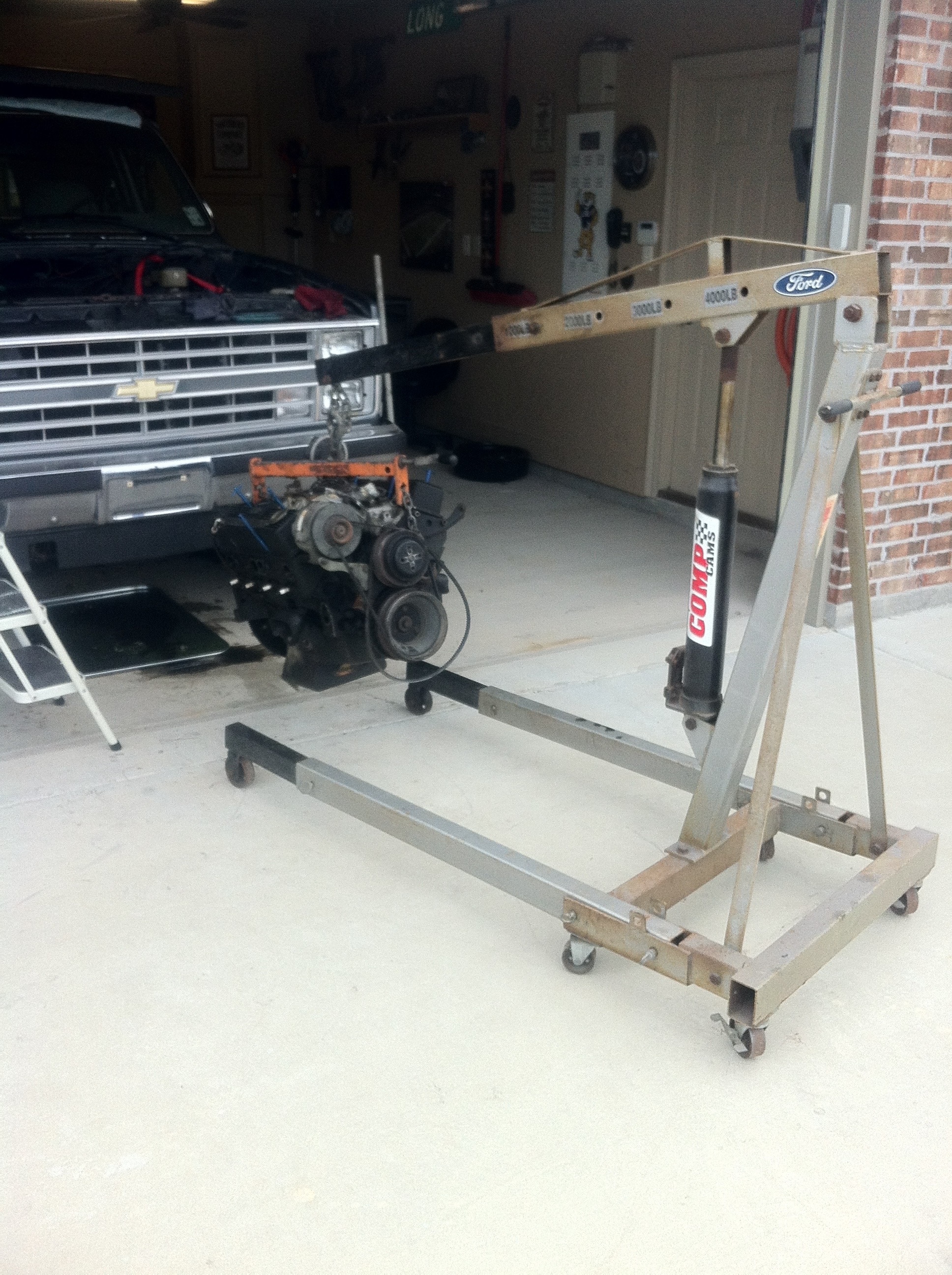

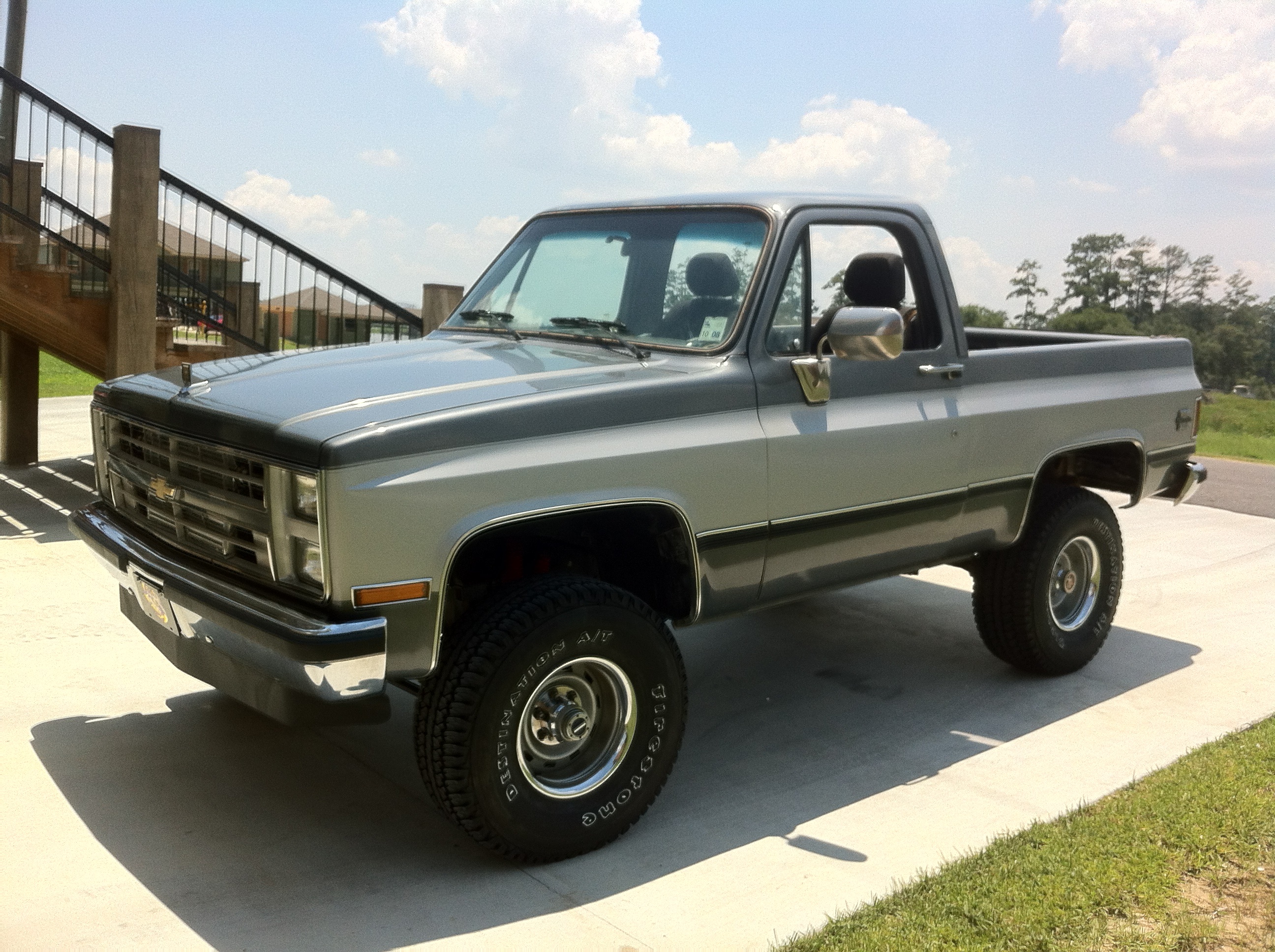

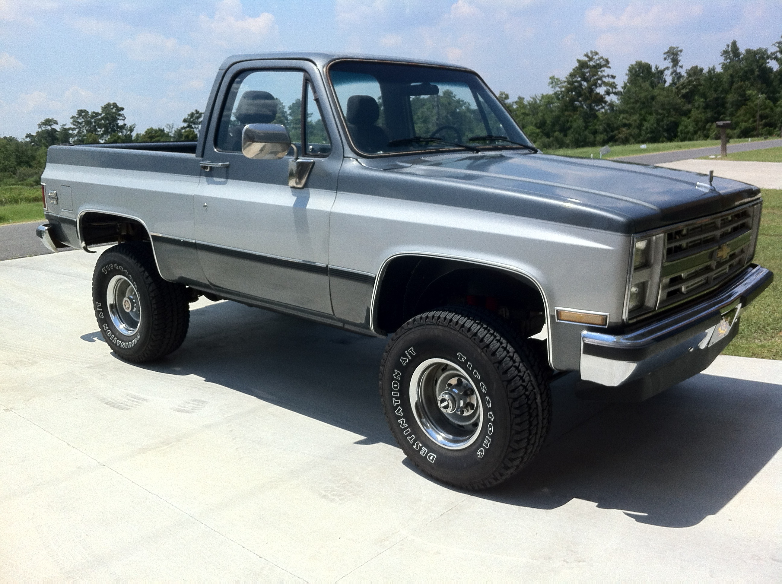

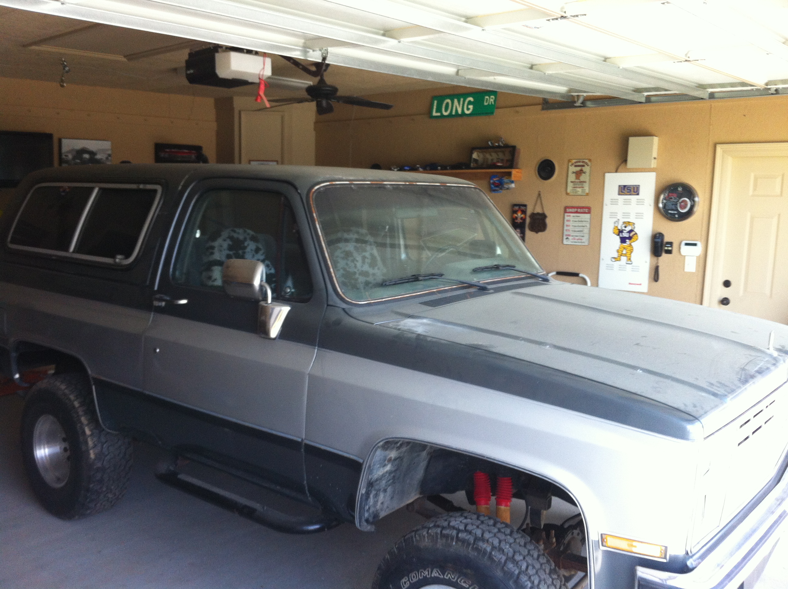

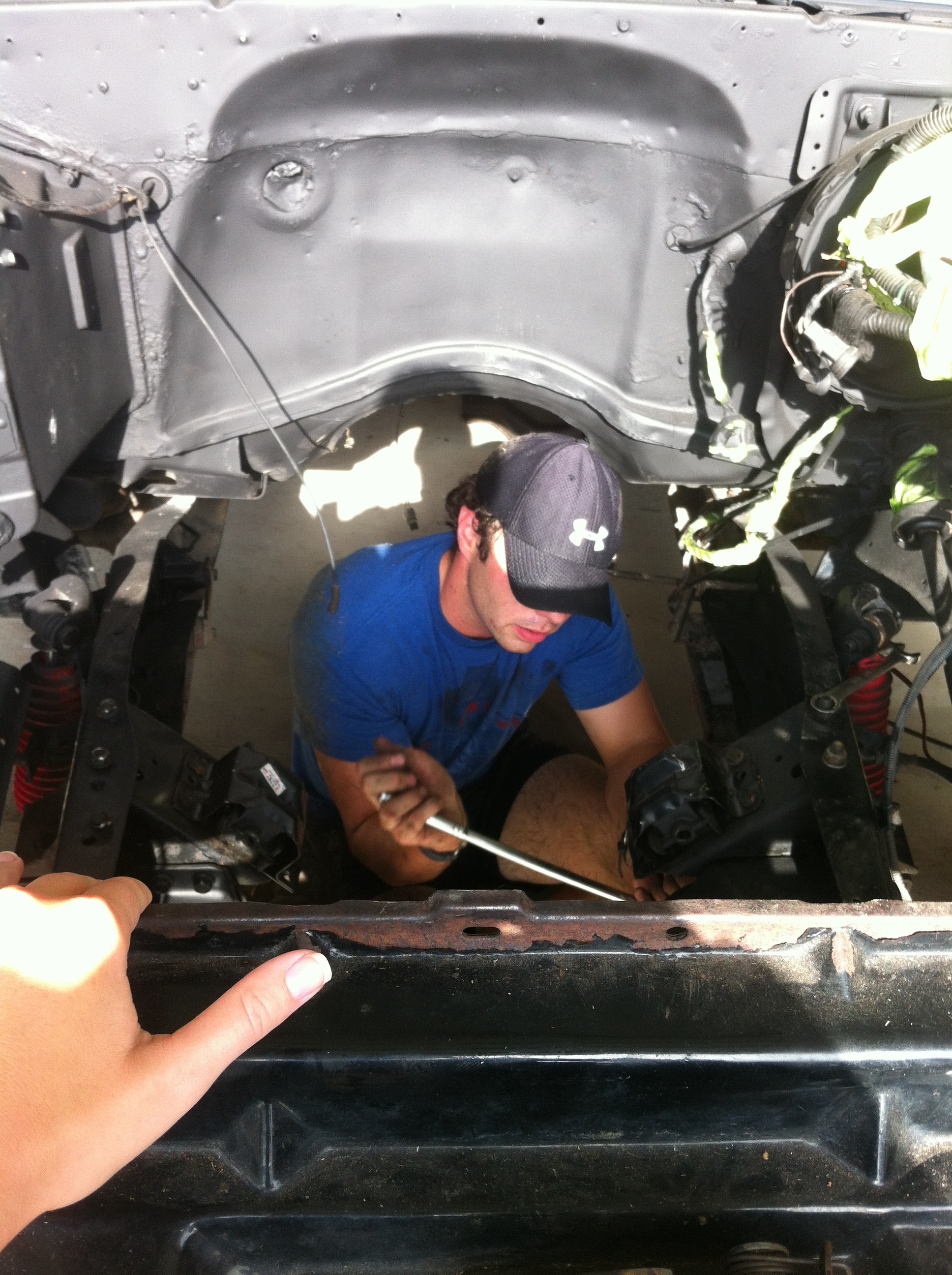

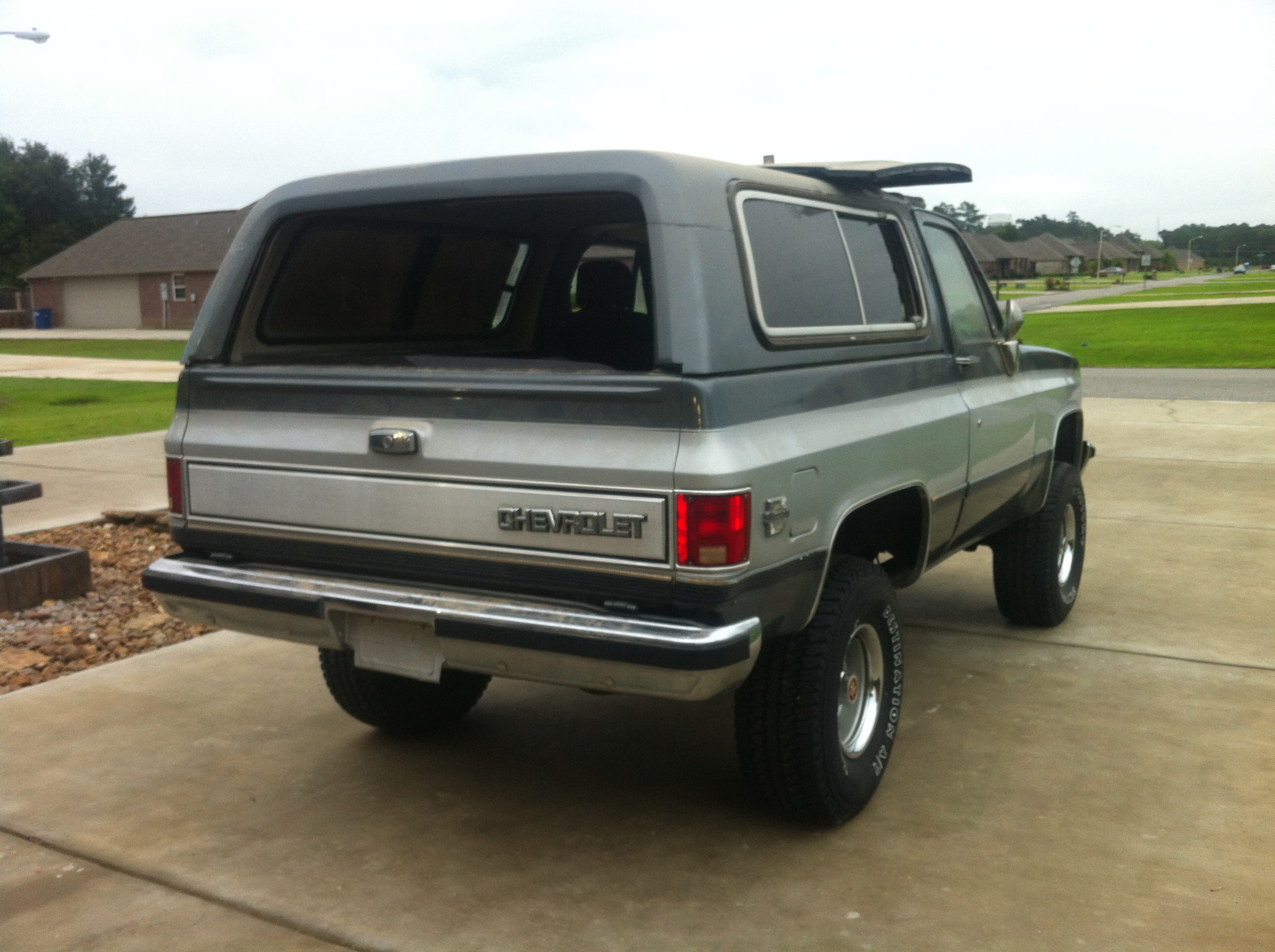

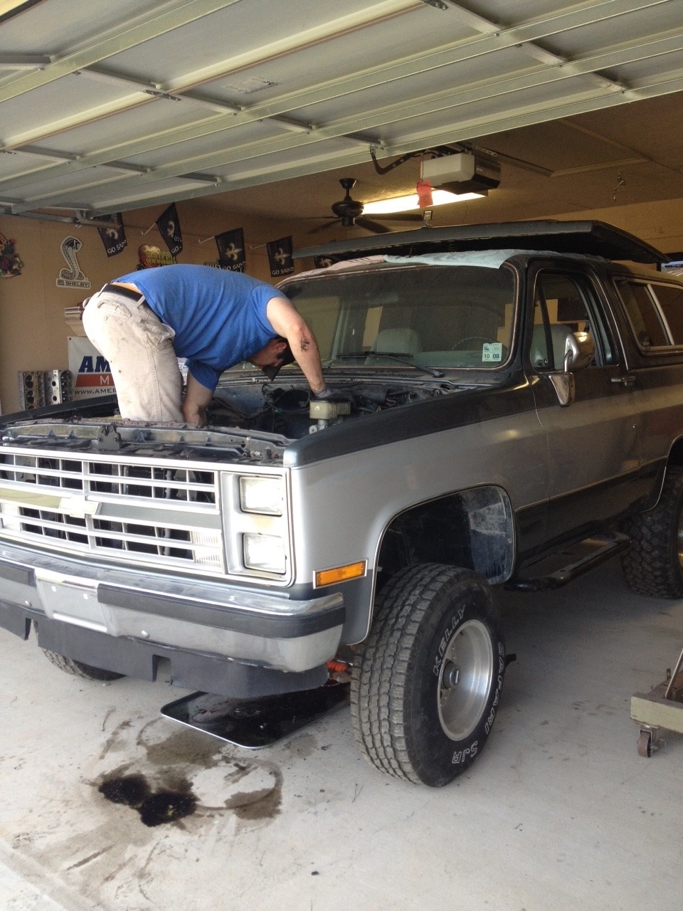

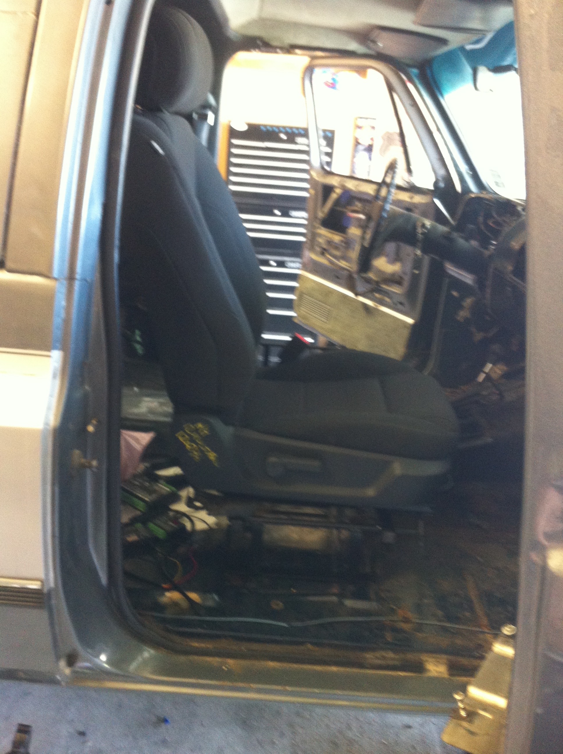

Ok guys I had lost a lot of my pics, and was finally able to recover them. So i'm going to pretty much copy over what I put on 67-72chevytrucks.com Thank you all for checking out my rig. I turned on e-mail notifications, so hopefully I can respond a lot faster this time. The first few pics are when I first got it and tear down.
1986 K5
Engine
• Stock 5.3 crank and rods. Pistons came from a 4.8, as you can see they are now flattop instead of dished.
• Clevite crankshaft and rod bearings.
• Durabond cam bearings
• ARP rod bolts and Brian Tooley head studs.
• Z06 camshaft
• LS9 headgaskets
• LS7 lifters
• TSP hardened pushrods
• Brian Tooley dual valvesprings
• New TSP oil pump
• LS6 timing chain
• 340 Aeromotive Stealth Fuel pump intank
• ½ fuel lines
• 60lb Siemens injectors
• Mallory fuel regulator
• Mighty Mouse catch can
• GT45 Turbo
• JGS BOV and wastegate
• A/A intercooler
• 3” s/s intake piping
• 4” downpipe w/ Dynomax bullet
• Speed density tuned
New radiator w/ electric fans
Transmission
4L80E
• Rebuilt by Jake’s Performance transmission
• 2800 stall
• B&M deep pan
• B&M transmission cooler with aux. fan
• Fresh rebuild on NP208 transfer case
Axles
• 14B semi-floating axle in rear
o 3.73 gears
o Gov-lock
o Dutchman custom 6 lug axles
o Lugnut 4x4 custom disc brakes
o Blue Torch Fabrication diff cover
• Stock 10 bolt up front for now
Wheels/Tires/Suspension
• 15” Rally wheels
• 33x12.50 Firestone destination A/T
• 2” lift w/ Bilstein shocks
Interior
• 2012 Mustang GT seats
• Helicopter seat belts front and rear
• Custom roll cage
• Rubber form fitted floors
• Dakota digital VHX instrument cluster
Exterior
• Softopper soft top “money well spent”
• Truck tailgate
• N-Fab steps
• Exterior is mostly stock, few rock chips here and there
Attached Thumbnails Turbo 4x4 K5-img_0299.jpg   Turbo 4x4 K5-img_0300.jpg   Turbo 4x4 K5-img_0301.jpg   Turbo 4x4 K5-img_0333.jpg   Turbo 4x4 K5-img_0332.jpg

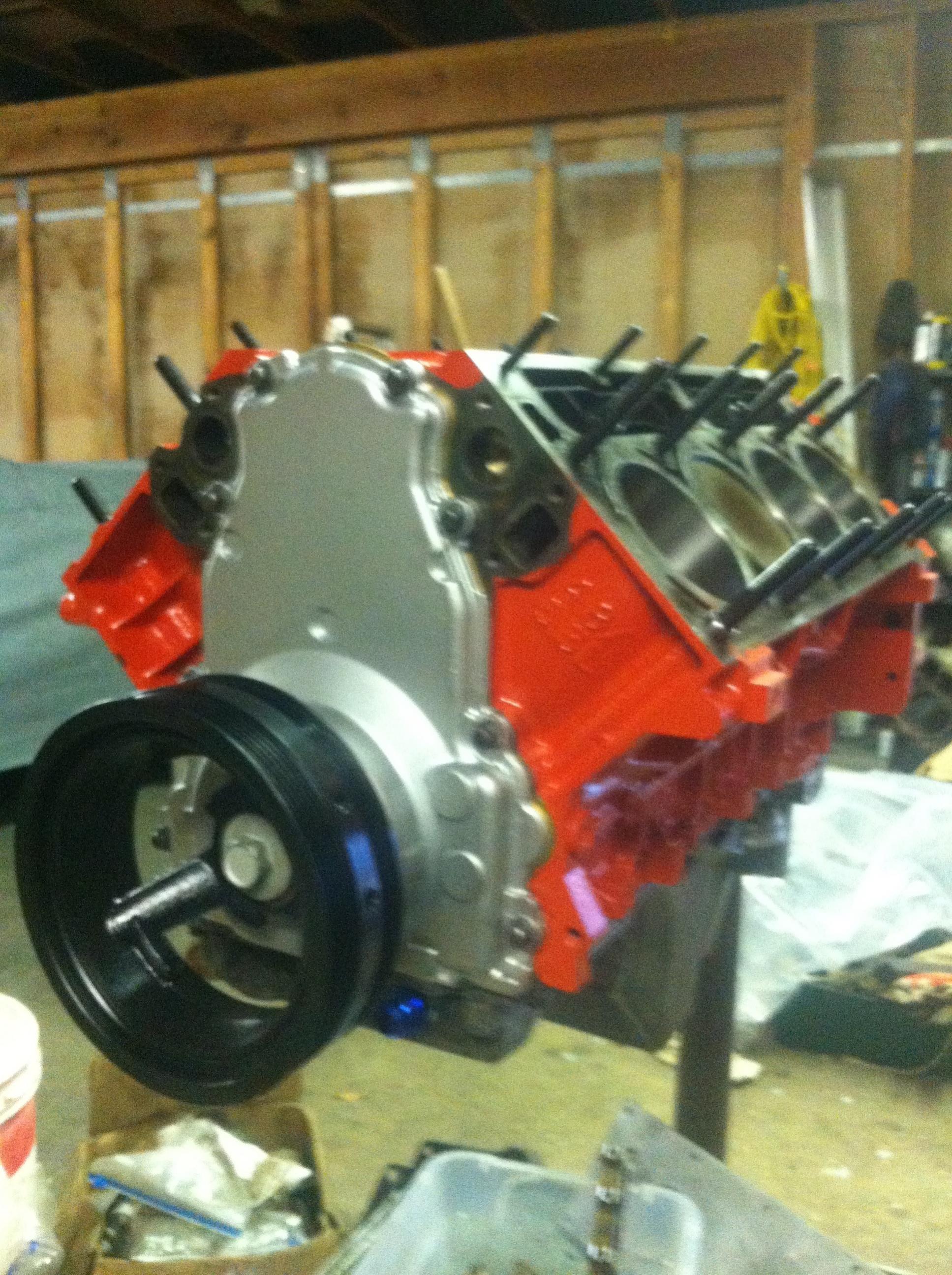

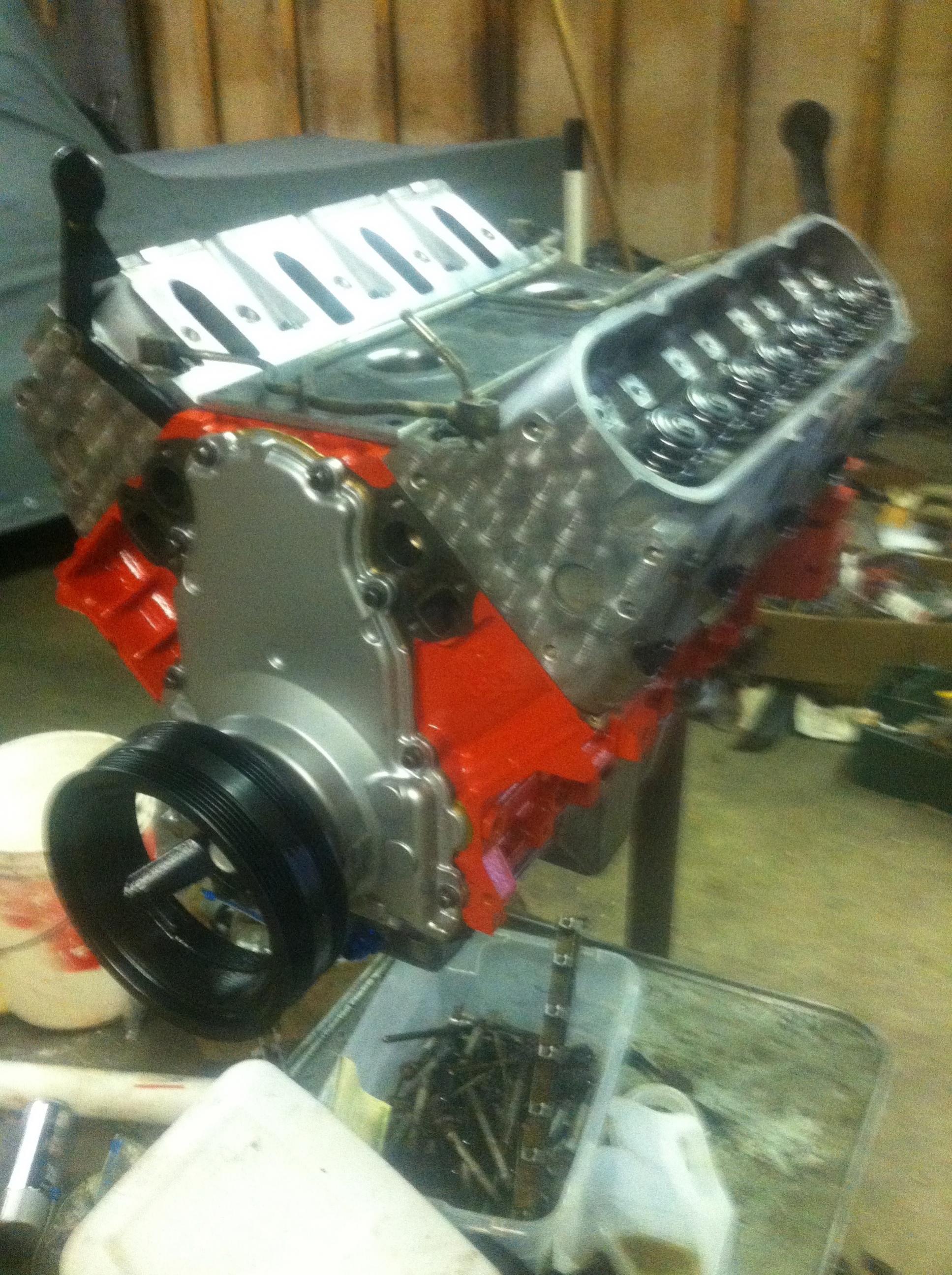

Engine build pics, I didn't start taking pics until after I had the bottom end together. All new clevite bearings on crank and rods, durabond on cam bearings. ARP rod bolts.
Attached Thumbnails Turbo 4x4 K5-img_0198.jpg   Turbo 4x4 K5-img_0348.jpg   Turbo 4x4 K5-img_0351.jpg   Turbo 4x4 K5-img_0306.jpg

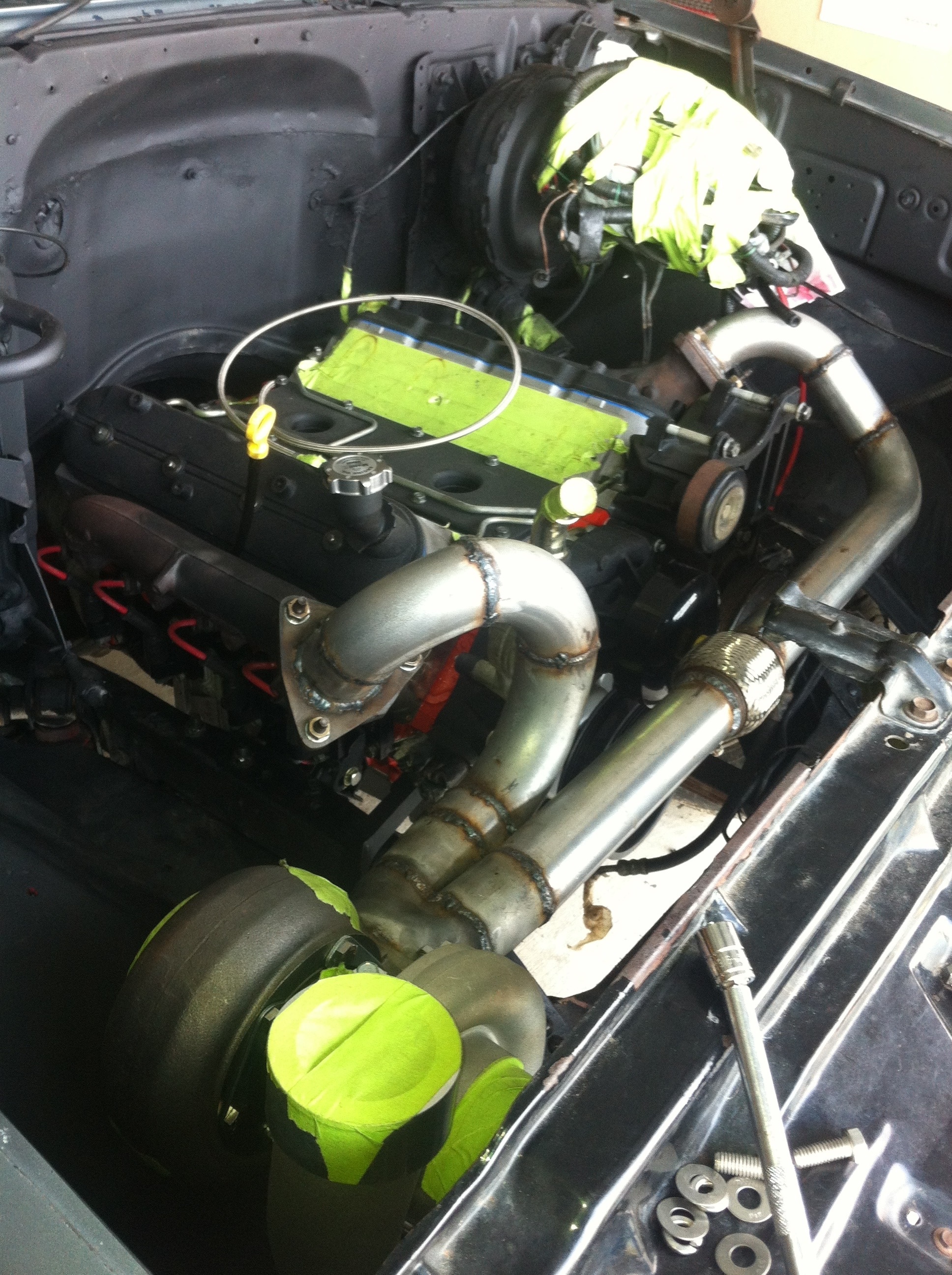

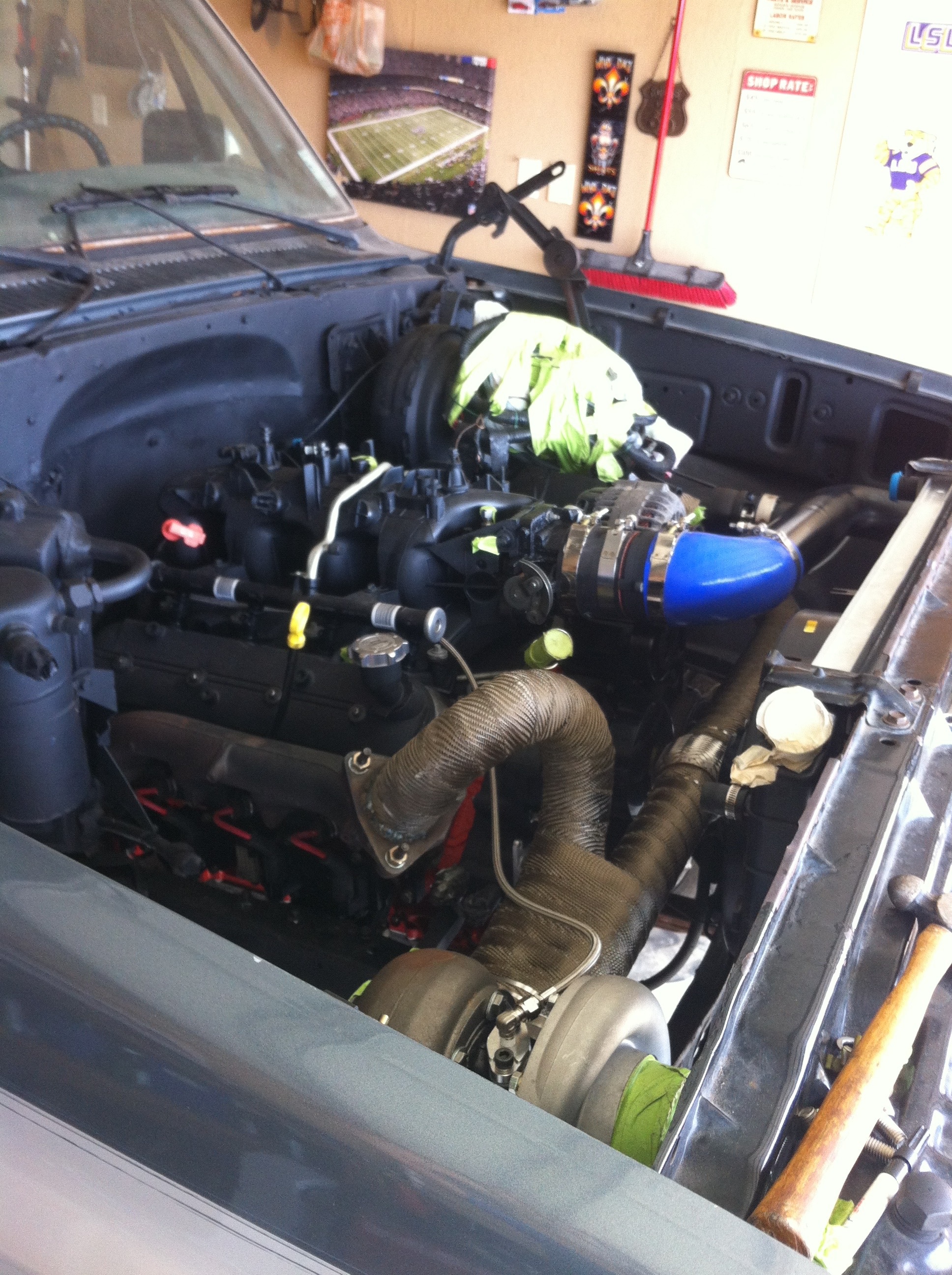

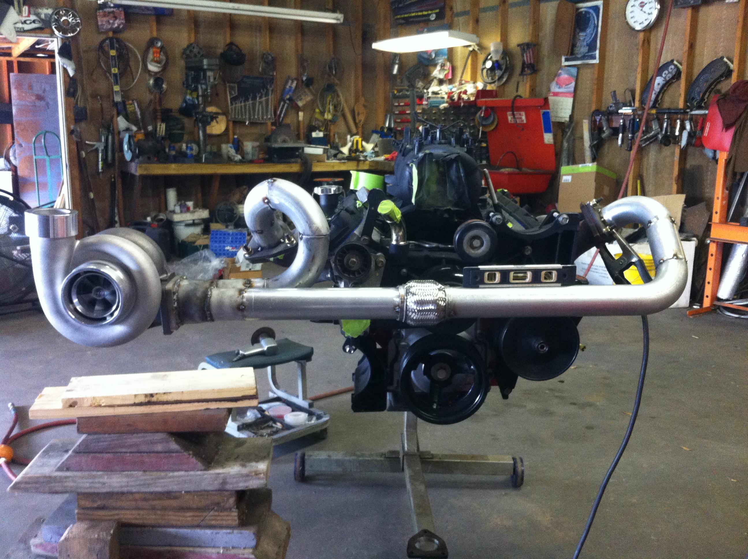

Hotside mockup. Gotta love large engine bays.

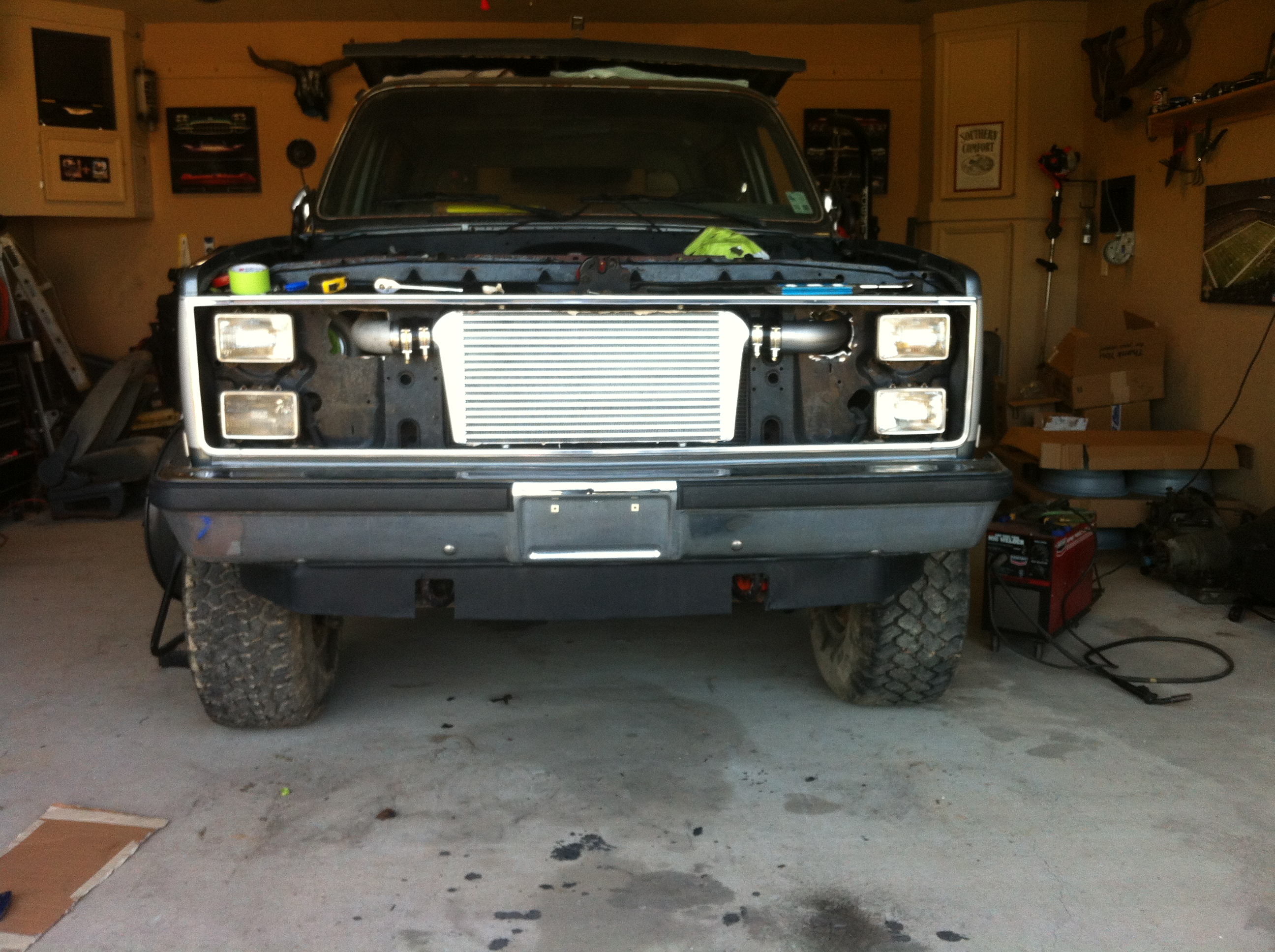

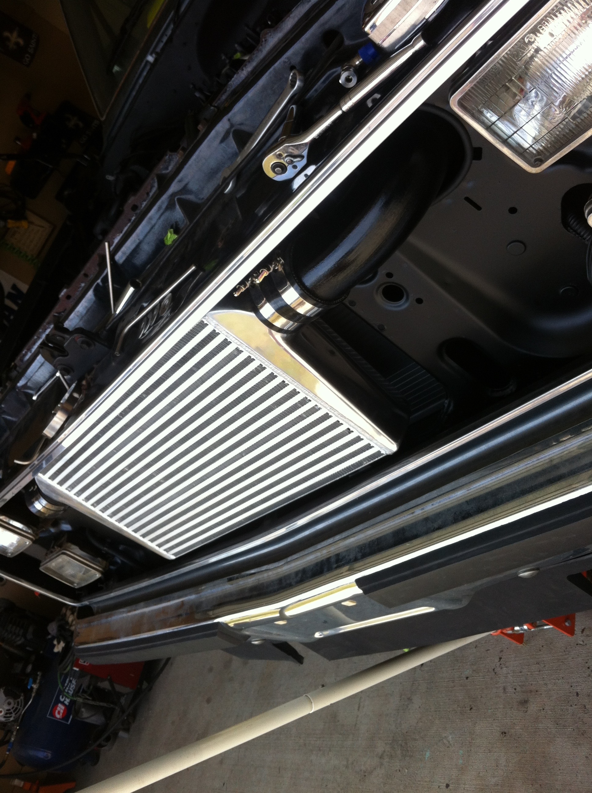

It fits! The coldside is fabbed up in the pics. The coldside is 3" S/S. Gotta love intercooler mockup pics.

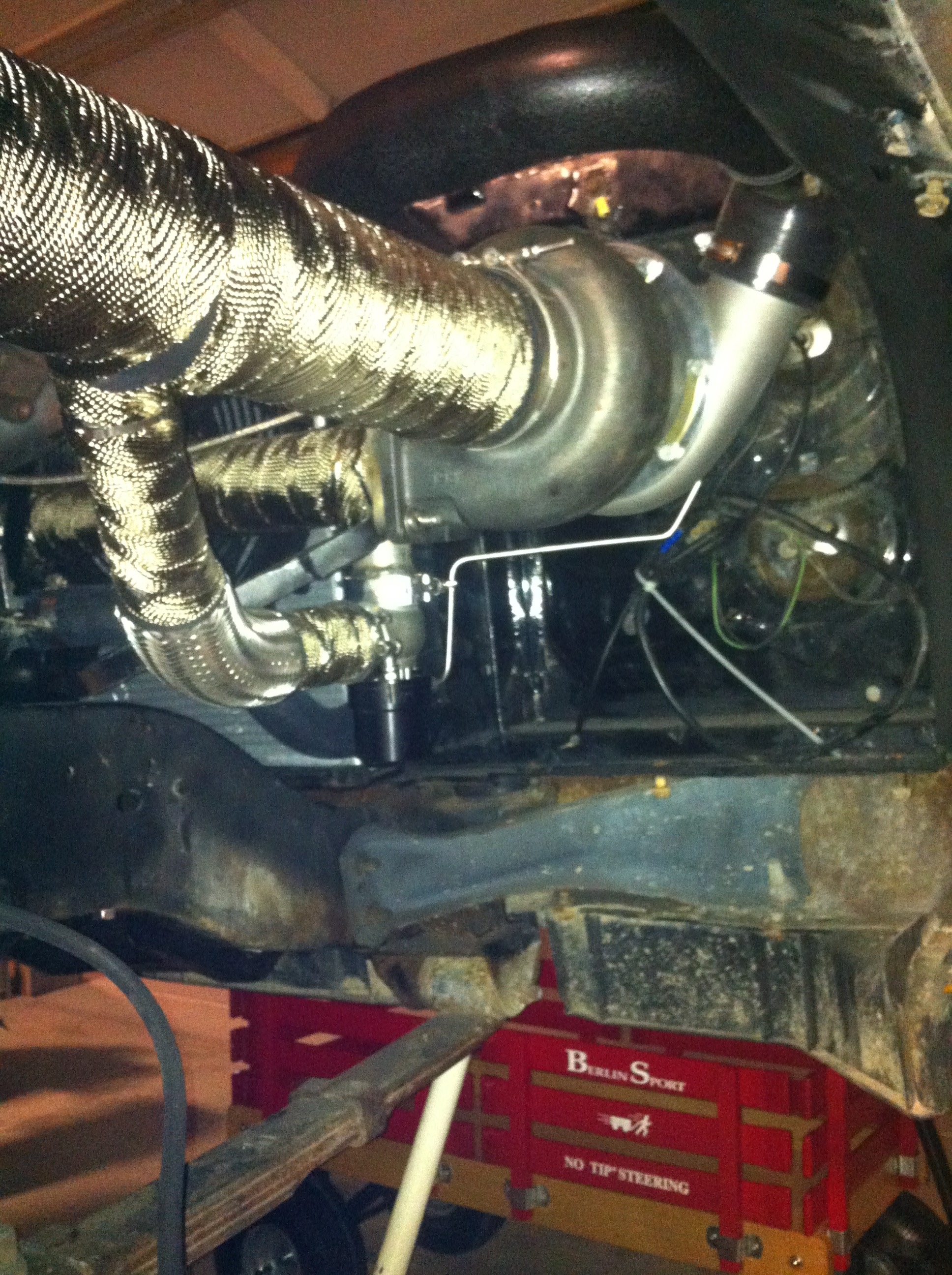

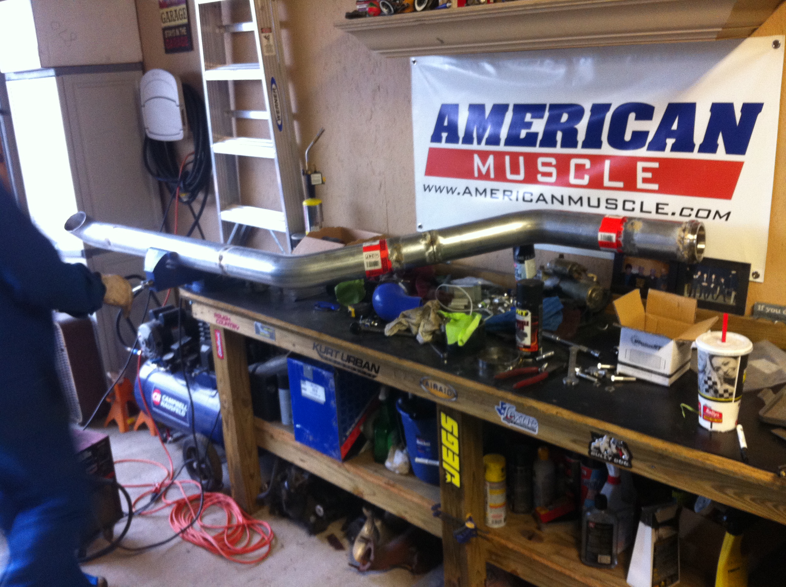

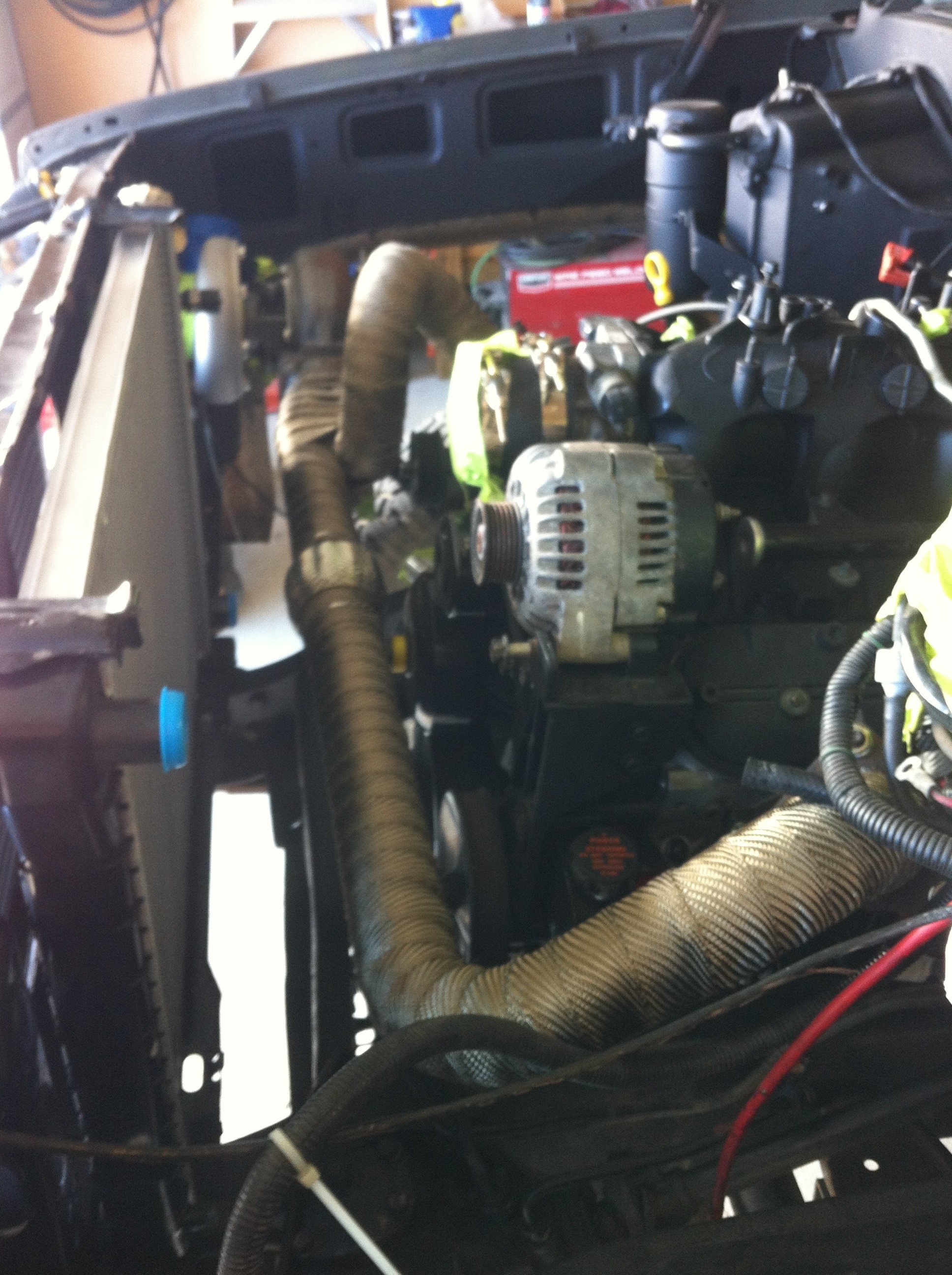

DEI carbon fiber header wrap to help cool things down a bit in the engine bay. Also the fabrication of the anaconda size down pipe. The inner fenderwell wasn't installed in the pic, but is later modified to completely hide the downpipe. The Dynomax bullet isn't in the pipe in the pic, but is added later on.
Attached Thumbnails Turbo 4x4 K5-img_0489.jpg   Turbo 4x4 K5-img_0490.jpg   Turbo 4x4 K5-img_0495.jpg   Turbo 4x4 K5-img_0501.jpg   Turbo 4x4 K5-img_0502.jpg

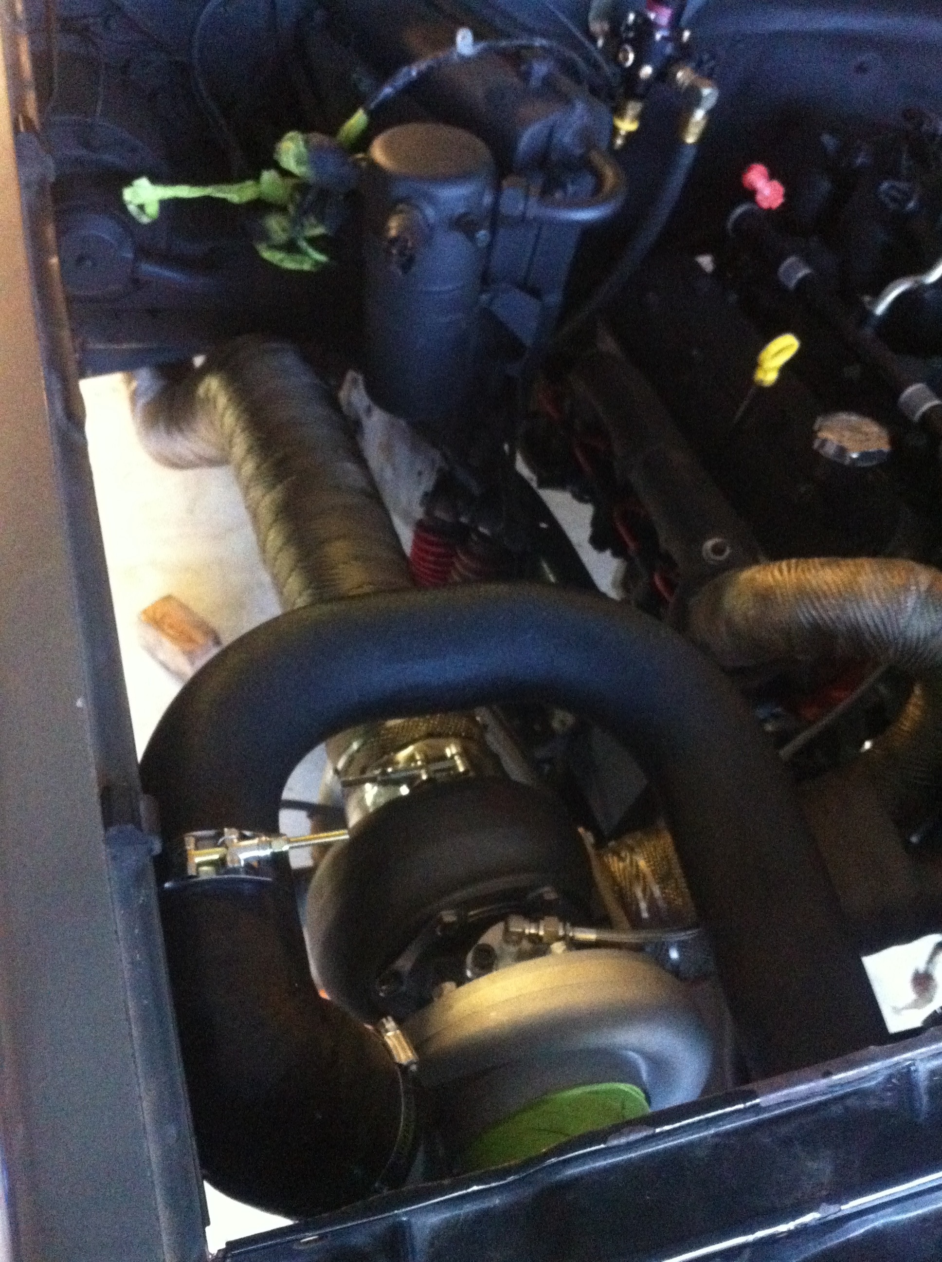

Downpipe wrapped and installed. The blow-off valve and wastegate sensing lines are ran in s/s tubing. The header wrap isn't that shiny, must have been the flash. Cold-side piping painted in wrinkle black paint. If you notice there is a MAF currently installed. This is taken out later on in the build to just use speed density.

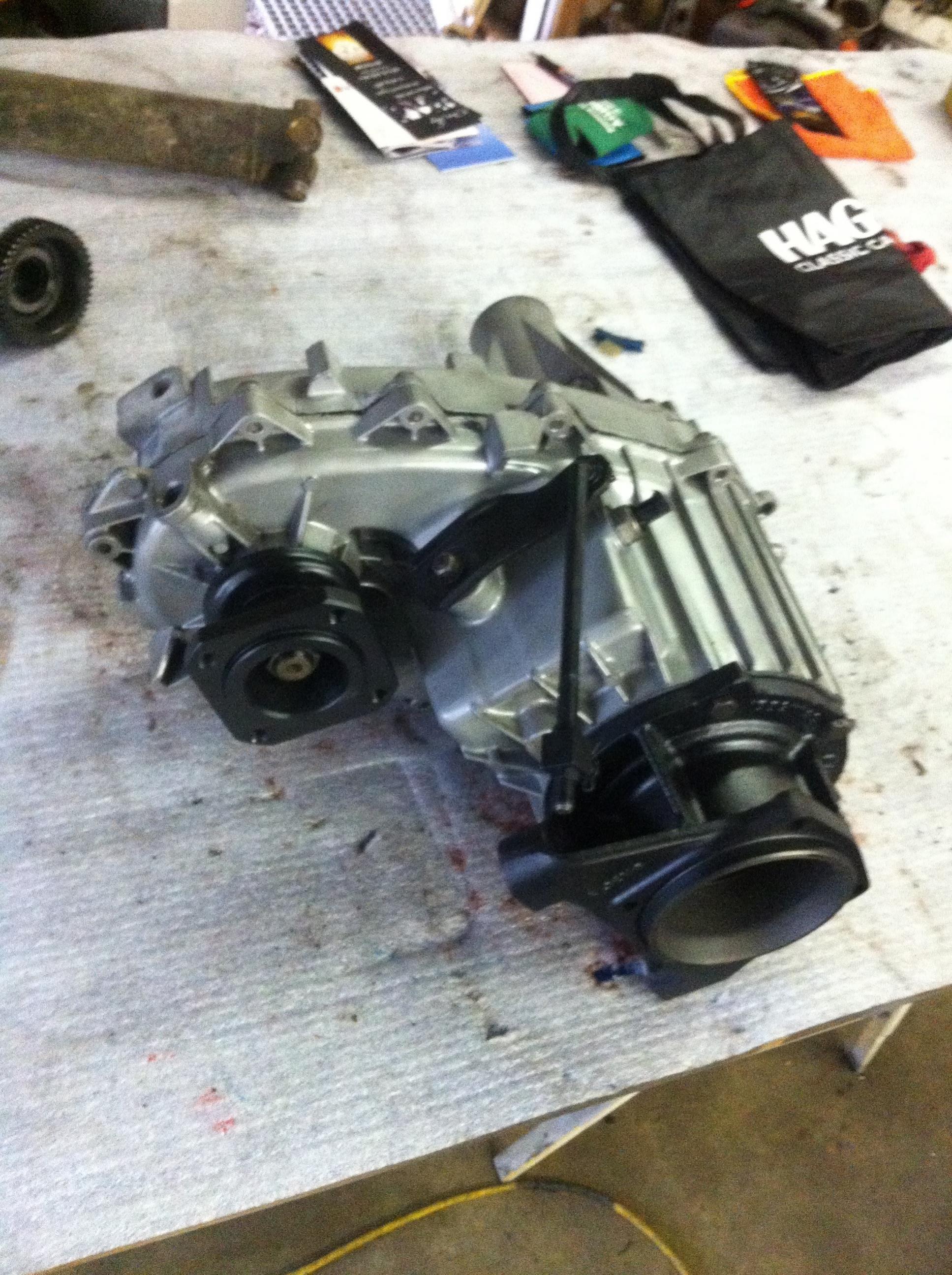

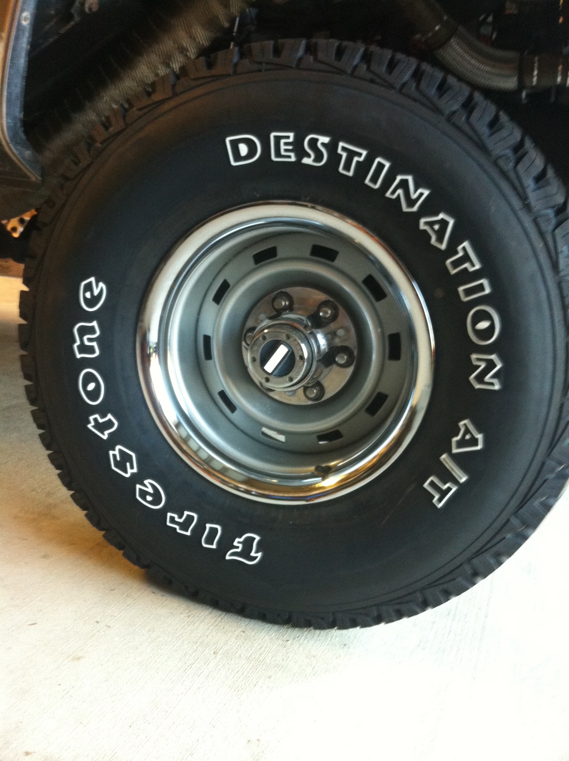

Rally wheels. Grille fitment came out good. We only had to take it off about 34 times.Fresh rebuild of the NP208 transfer case. We had to install a 32 spline input shaft to be able to slide it onto the 4L80E, so we did a complete rebuild and cleaned it up. New front spoiler also.

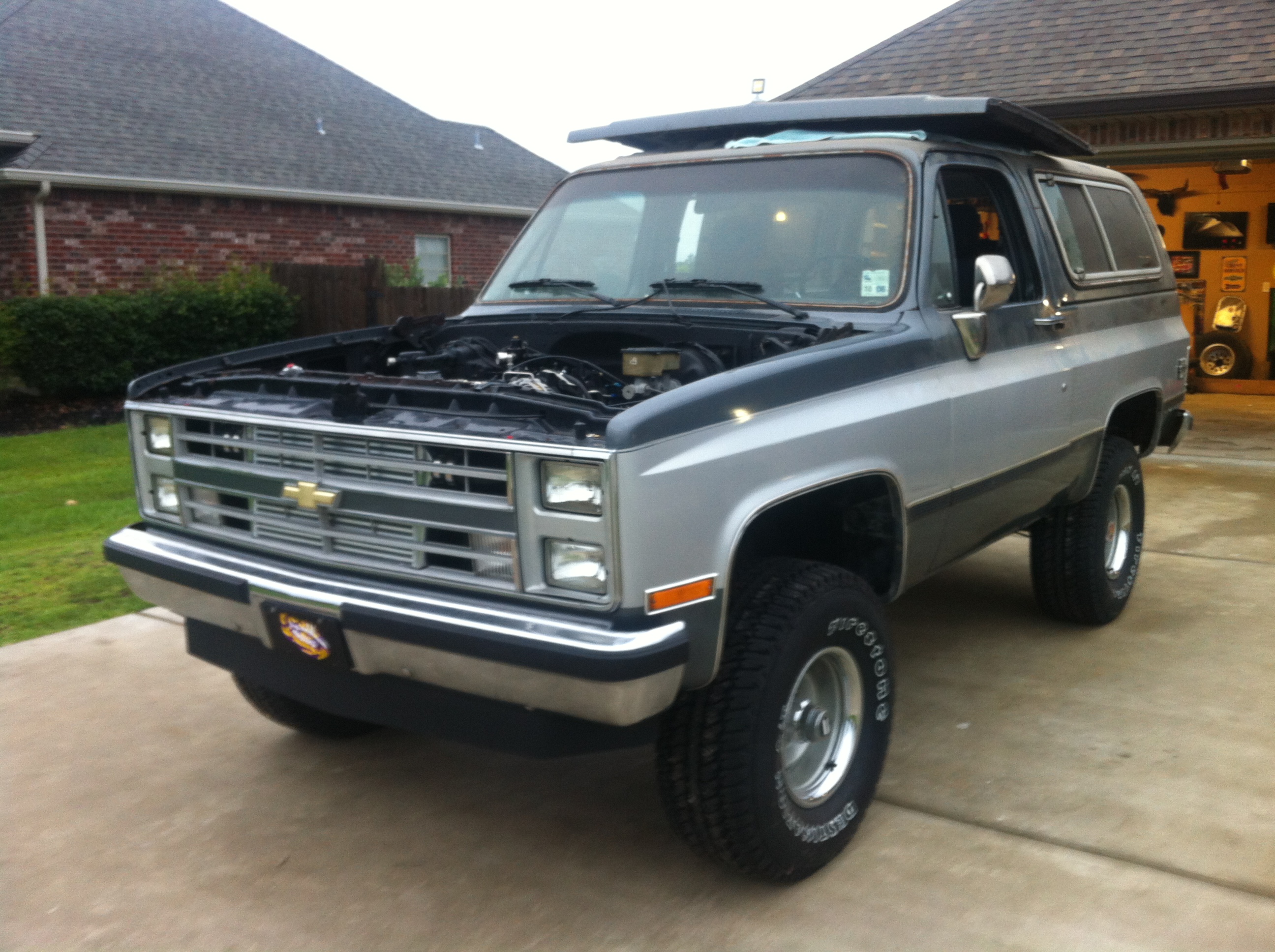

Turbo peeking through the grill. It now has a filter on it. 2012 Mustang seat fitment. My old man and my wiring bud helping out with getting it cranked. Last two are of it's first time pulling out under it's own power.

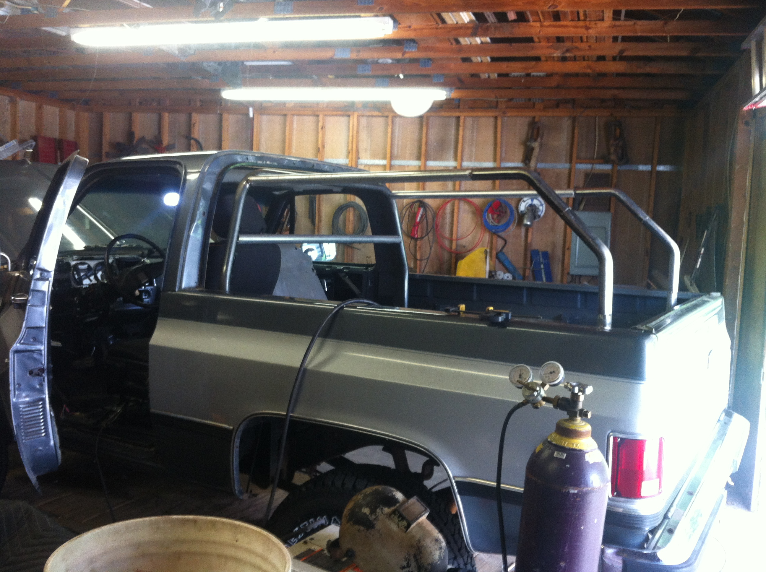

Maiden voyage to a buddies house with the top off of course. Shortly thereafter the roll cage started to be fabbed.
Attached Thumbnails Turbo 4x4 K5-img_0677.jpg   Turbo 4x4 K5-img_0678.jpg   Turbo 4x4 K5-img_0679.jpg   Turbo 4x4 K5-img_0689.jpg   Turbo 4x4 K5-img_0690.jpg
