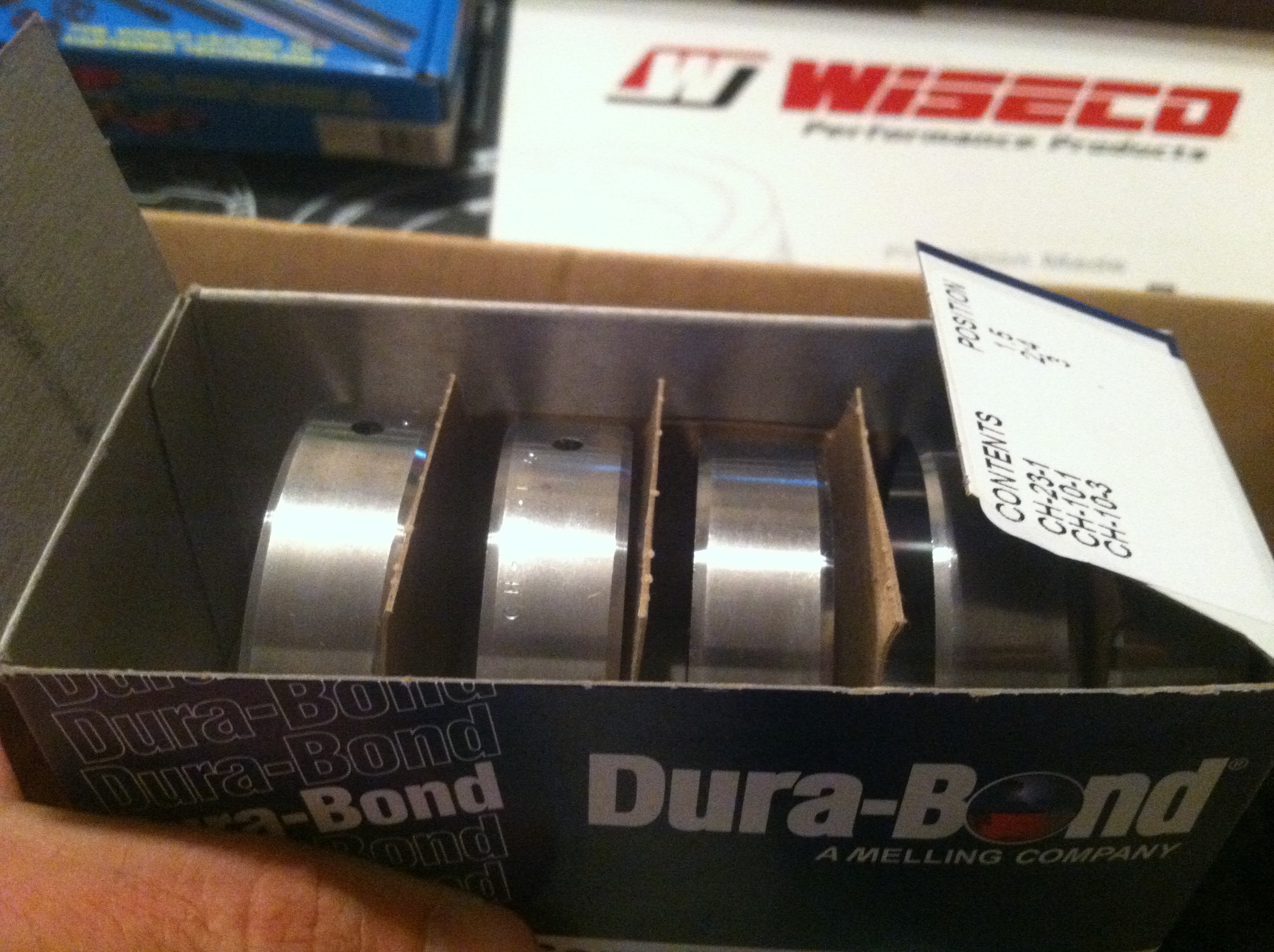

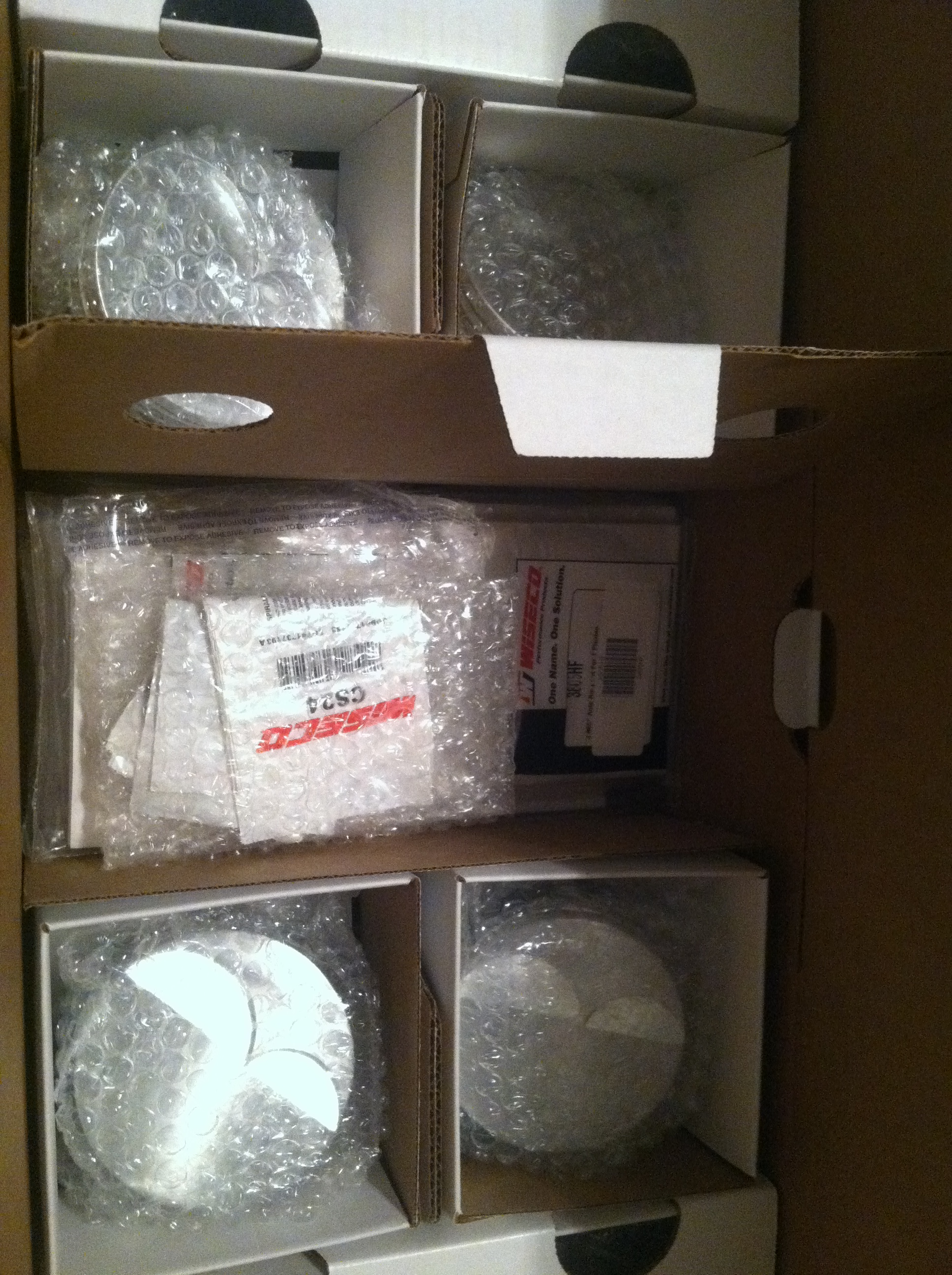

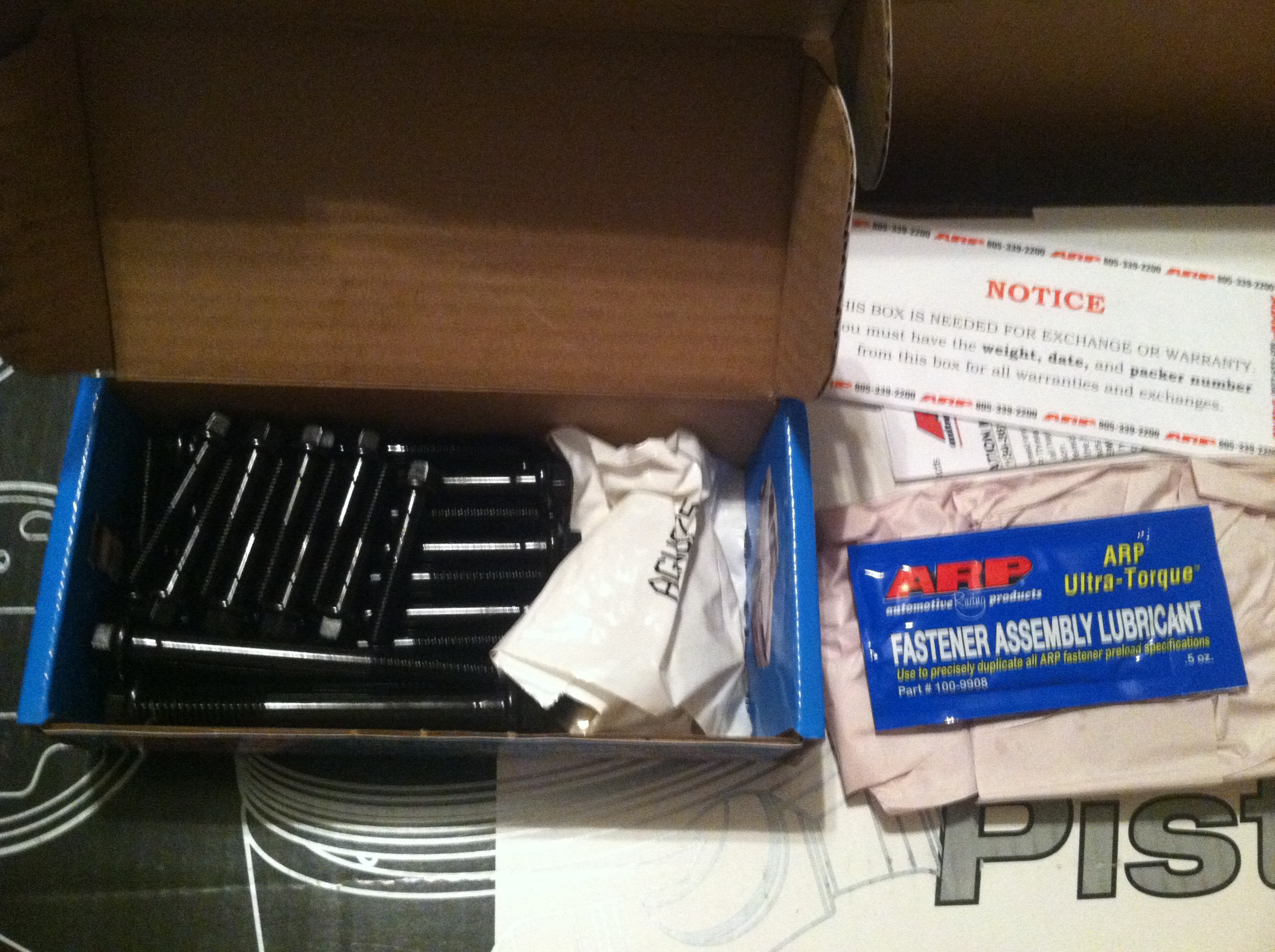

Hey guys, im about to get things rolling with this engine build and i wanted to move it over to the projects thread to get more traffic. I have been posting over in the Internal engine modifications thread so you can check that out to see what has been going up until now. The engine will be going to the machine shop next monday while i still acquire parts and get things ready. I will try to get pics up
Attached Thumbnails Take 2-Mild L33 build-127.jpg   Take 2-Mild L33 build-128.jpg   Take 2-Mild L33 build-129.jpg   Take 2-Mild L33 build-130.jpg

Here are a couple of the pics. I cant post some of the others because their size is too big to upload. Any ideas how to change that?

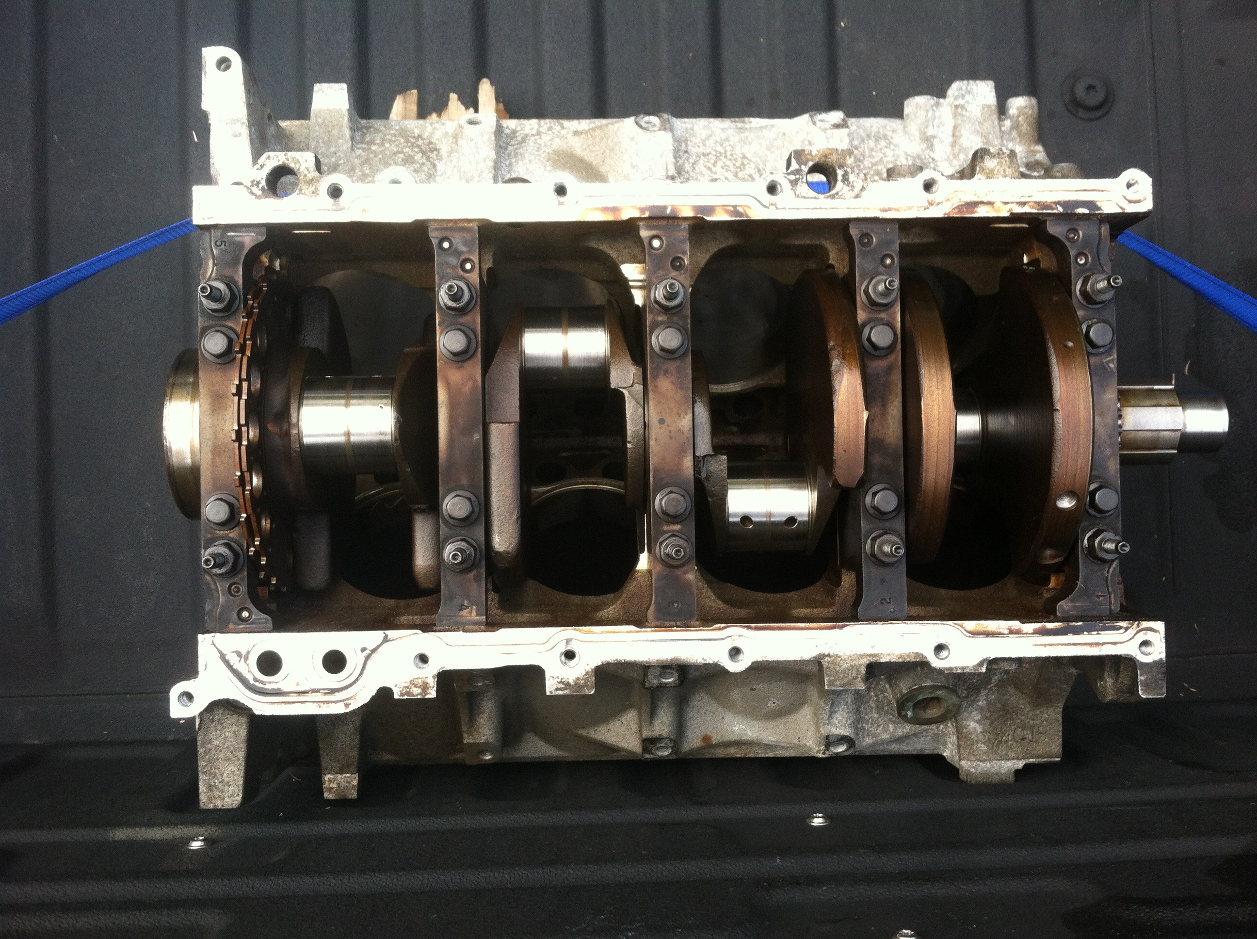

Another update: dropped the engine off at RPM this morning. Should hopefully be hearing something late next week. A couple pics of the block before we dropped it off.
