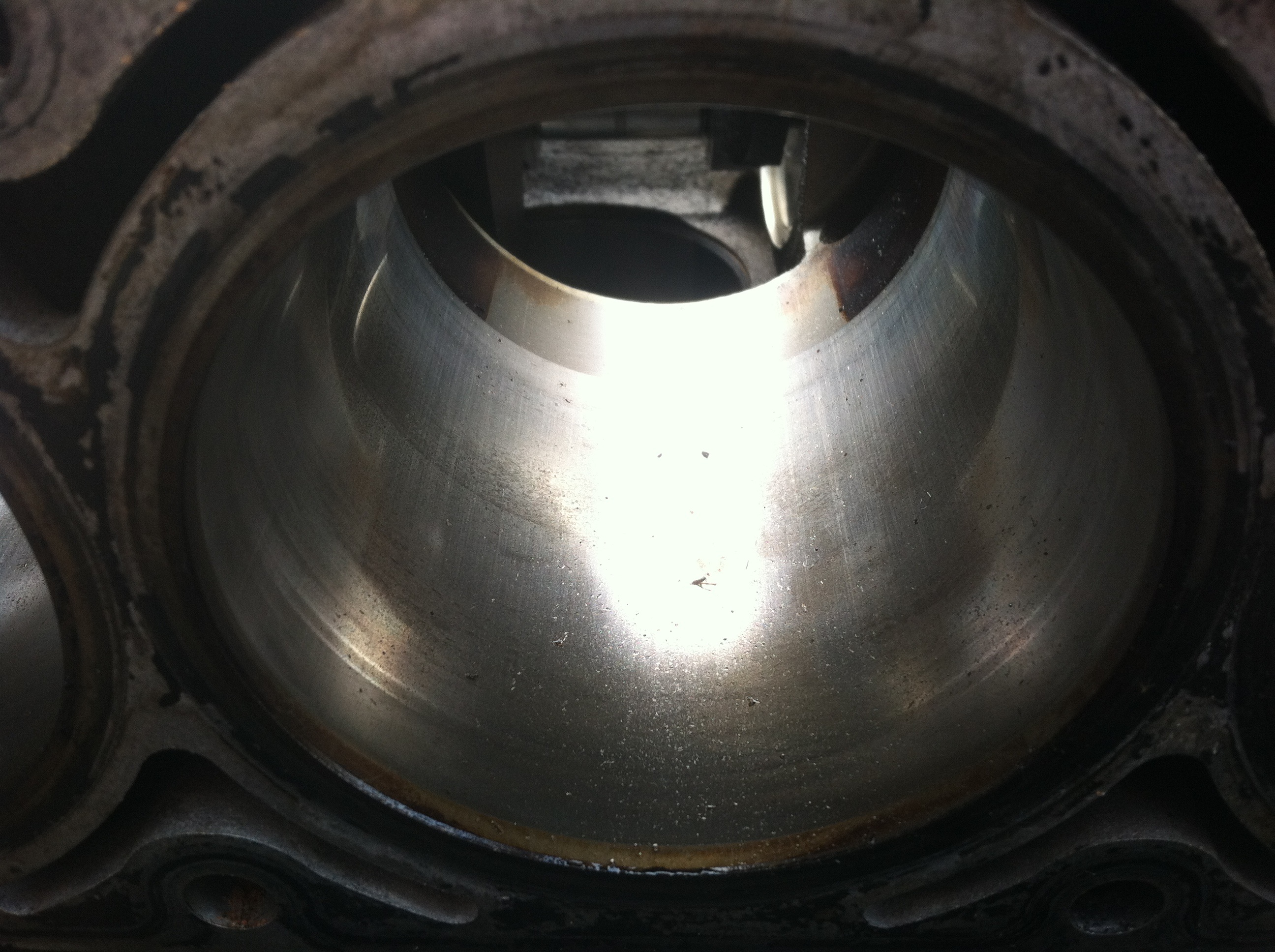

A bore shot

Looks pretty standard for a used motor.
What would you like to know?
