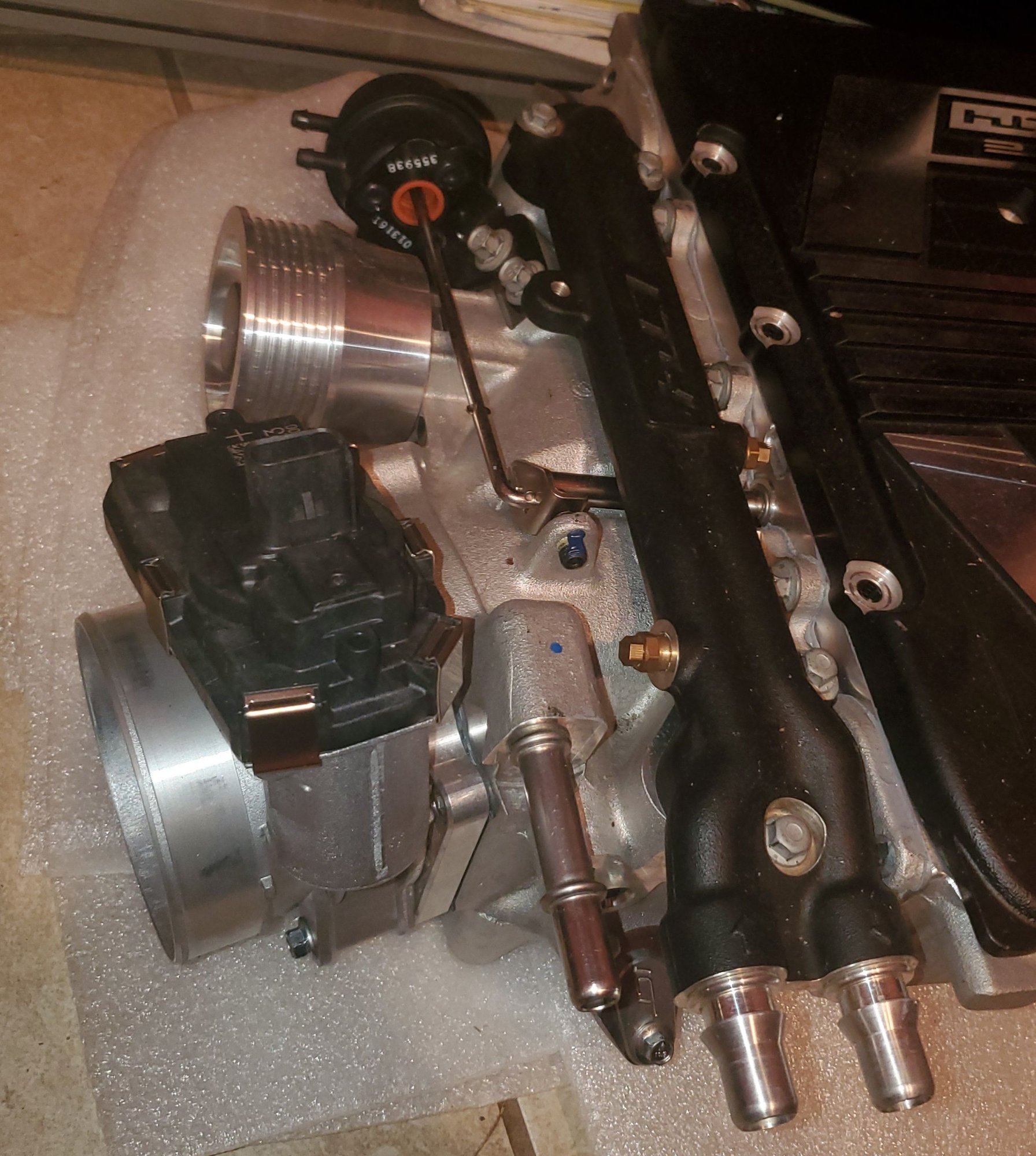

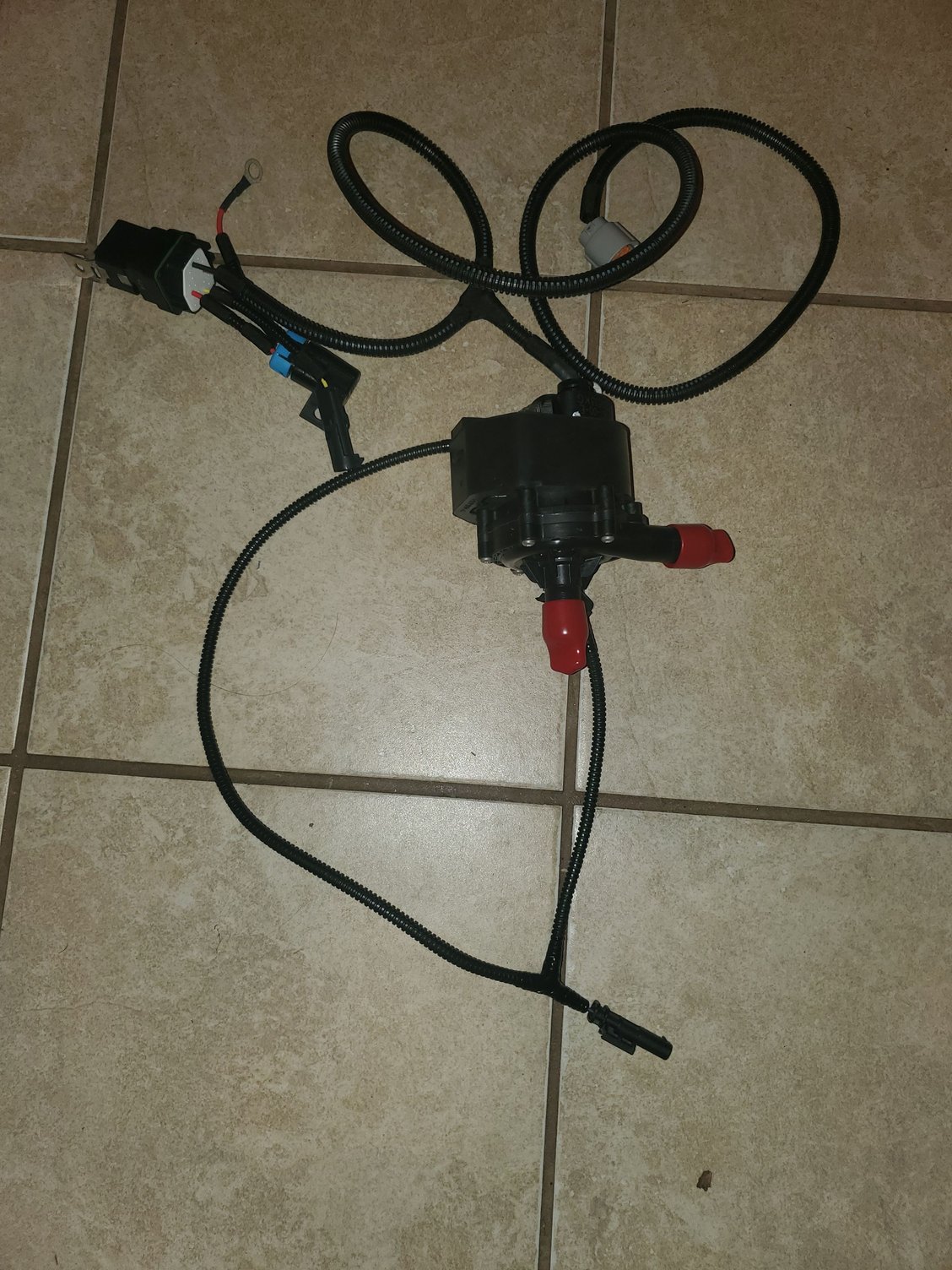

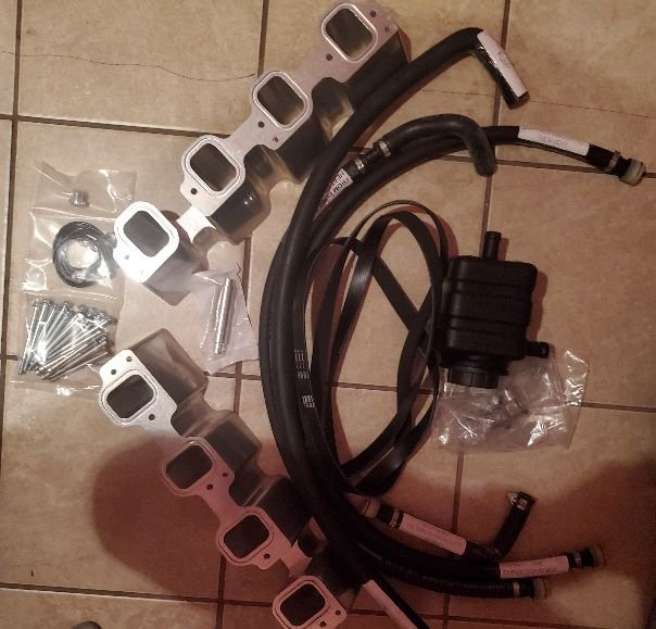

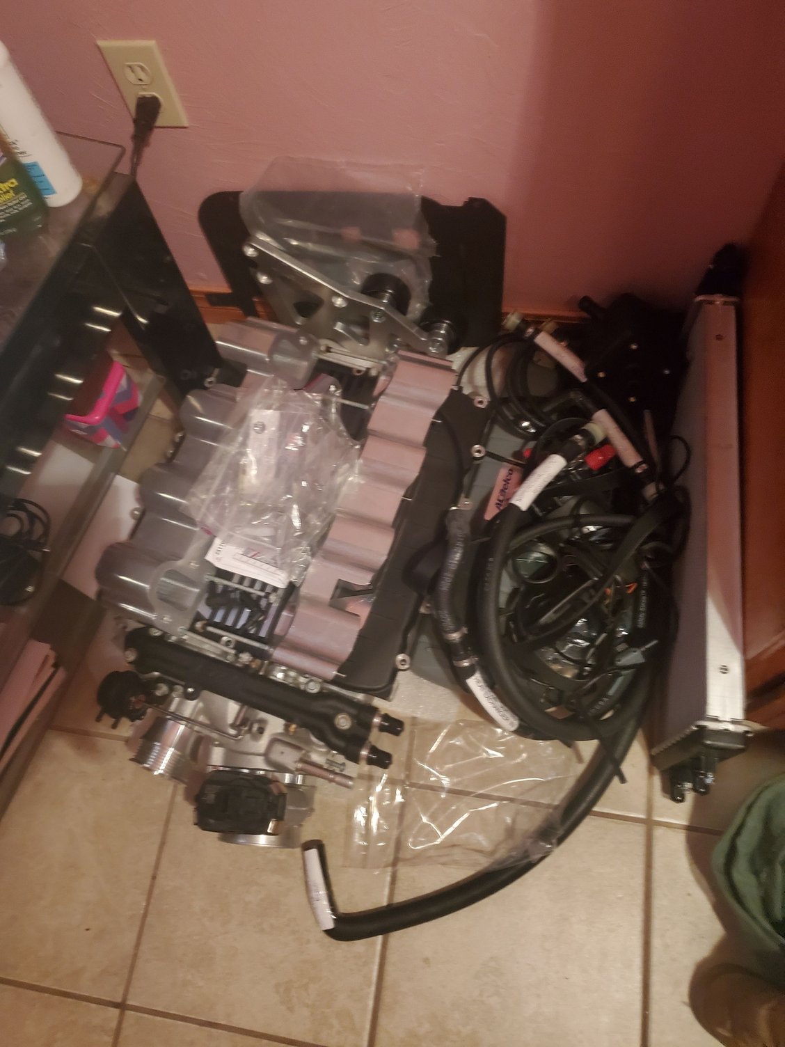

here is a pictures of all the parts I've amassed. I purchased alot of stuff through ADM performance and ICT billet.
LT4 supercharger Kit
LT4 adapters and hose kit
lt4 supercharger
Lt4 throttle body and adm pulley on lt4 supercharger
GM varimax Intercooler pump and harnesses
More pictures to come tomorrow!

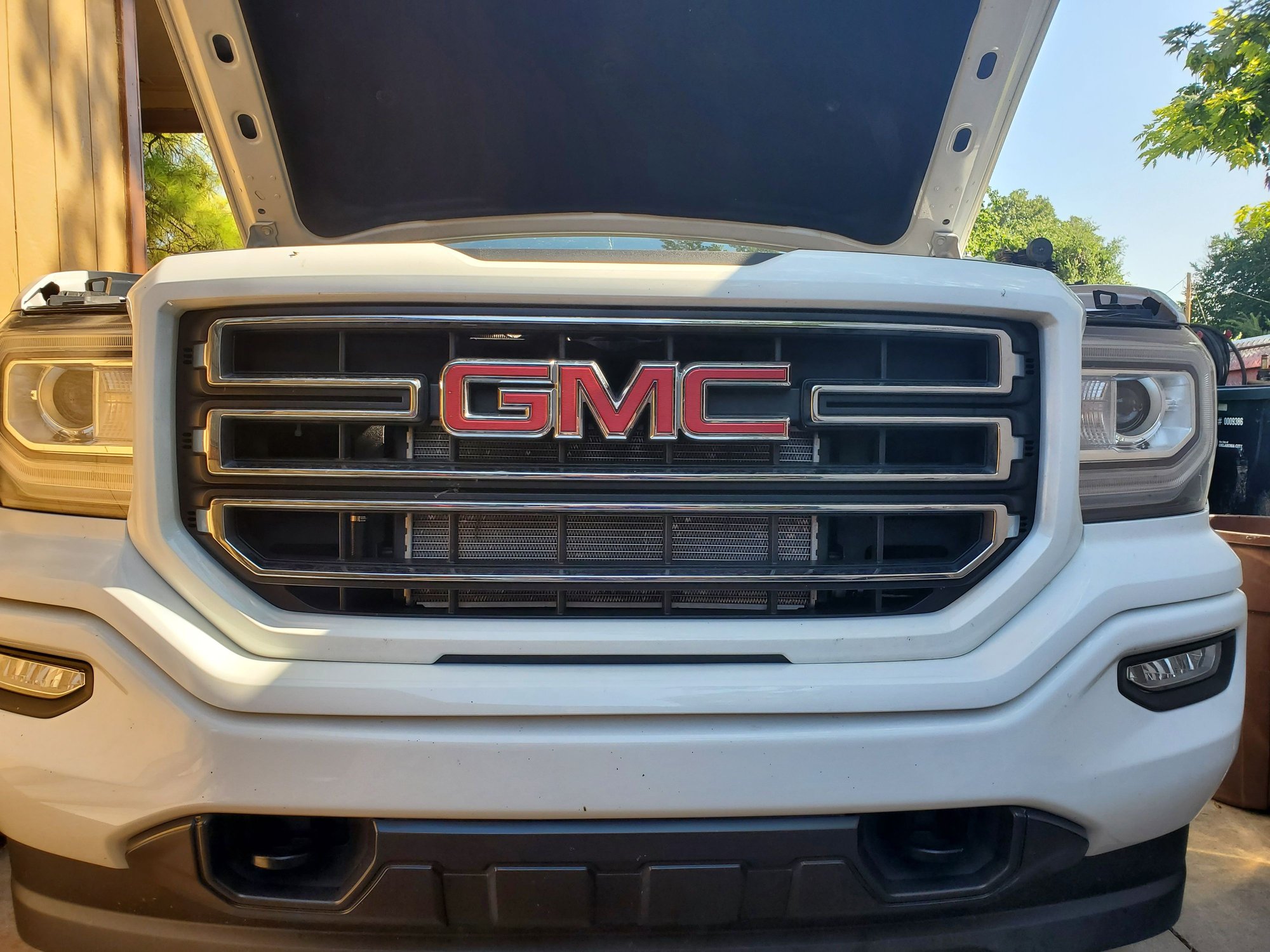

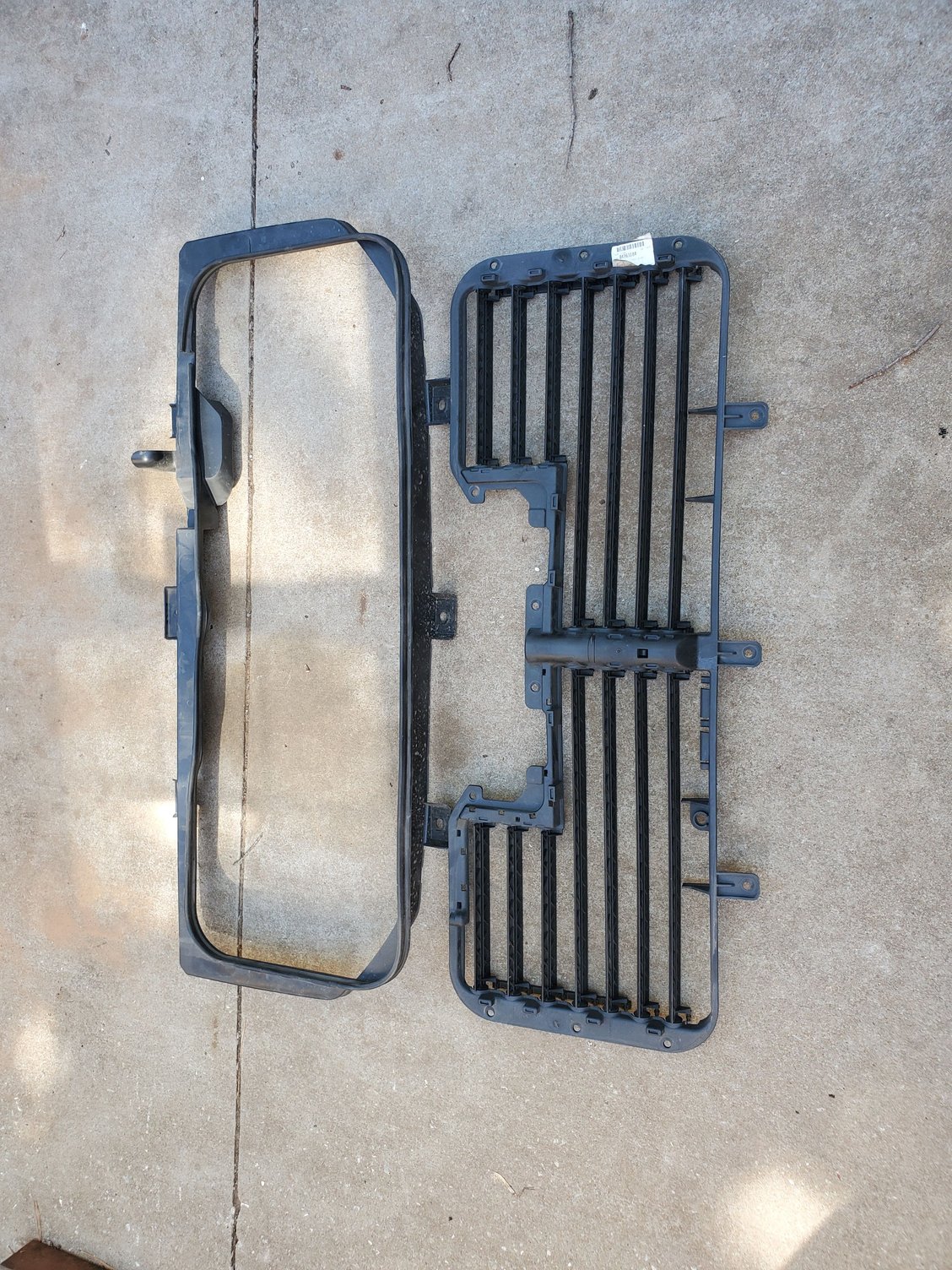

I didn't know the 2018 models have active air shutters!?
Old Jul 18, 2020 | 06:17 PM
LS-1 Powered's Avatar
Joined: May 2007
Posts: 120
Likes: 22
From: OK
Teaser pic! Love how that heat exchanger looks in there.

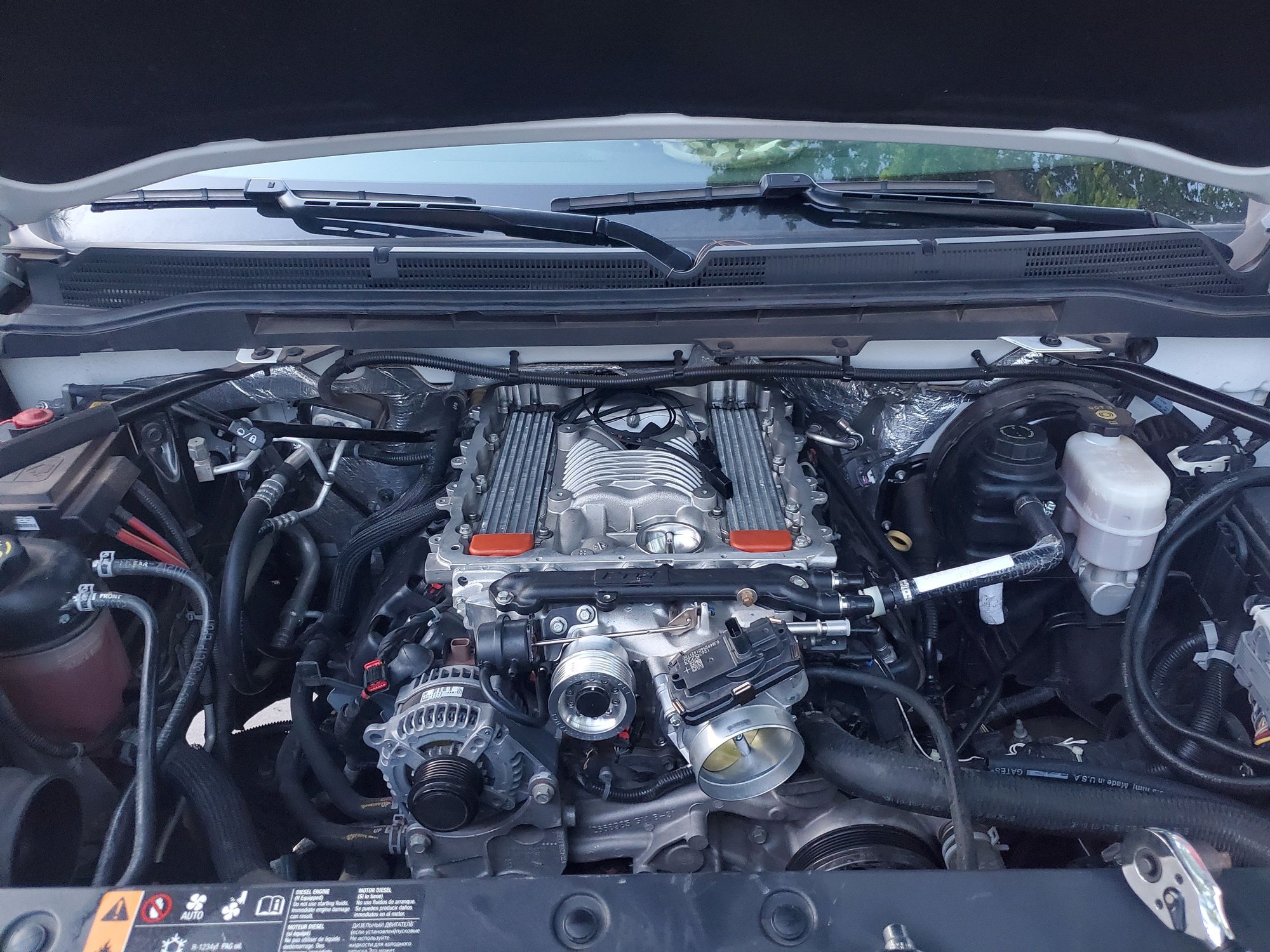

Old Jul 19, 2020 | 09:10 PM
Joined: May 2007
Posts: 120
Likes: 22
From: OK
didn't get to finish before dark but made lots of progress! I actually had to install the SC twice because there was a metal sleeve on the underside of supercharger that was hitting the adapters and not allowing the supercharger to sit flush. I had to grind it down a bit and then the SC finally sat down on the adapters evenly.
Old Jul 19, 2020 | 09:13 PM
Joined: May 2007
Posts: 120
Likes: 22
From: OK
the metal sleeve is where the arrow in red is pointing. Disregard the yellow circle.
