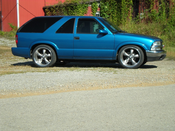

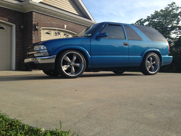

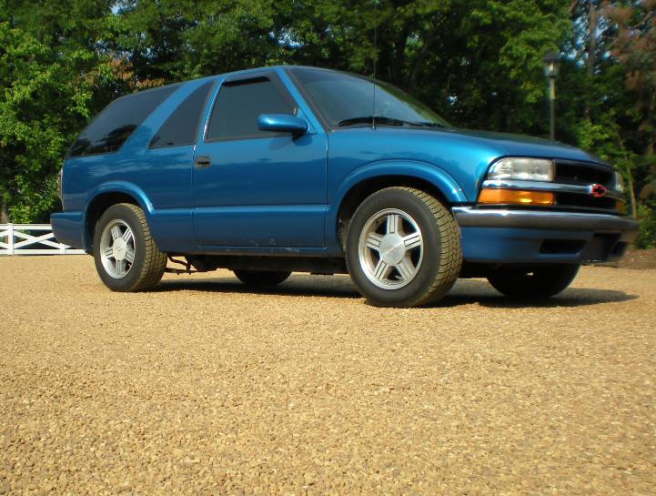

A few years ago I drove down to Georgia and bought this. It didn't have much done to it as seen in the pictures below. It's a 2000 Space Blue 2dr 2wd base model.

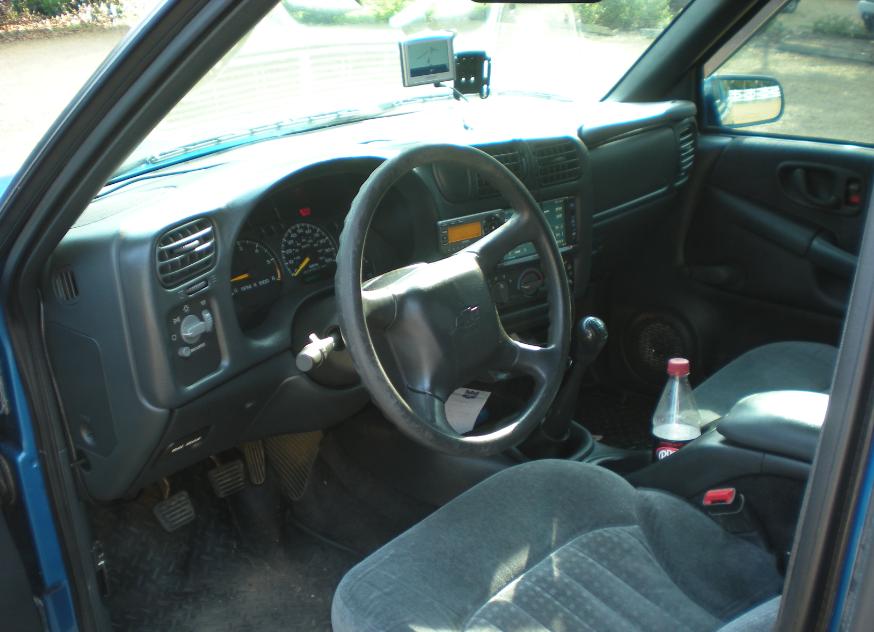

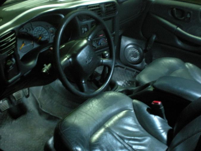

Notice how the double DIN is mounted in the older style dash bezel and it also sticks out far.

Interior:
Leather seats

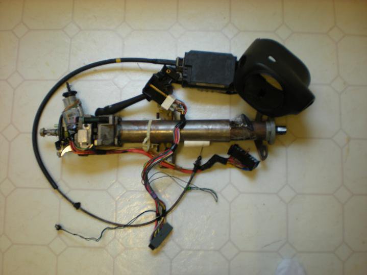

Converted straight column to tilt w/ cruise
Double DIN dash bezel
Over 100 SMD LED's
Lloyd's floor mats
Envoy handles
Blue SMD LED's for gauges and HVAC
Alero needles
Tilt colum. It sucked driving all the way home without tilt or cruise.

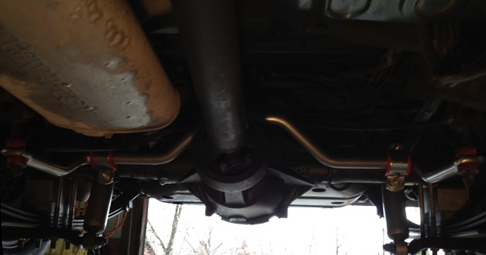

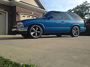

Lowered 4/4.5:
2" DJM coils
2" Belltech spindles
Pulled leaf
2" blocks
1/2" blocks
4* shims
Set back plates

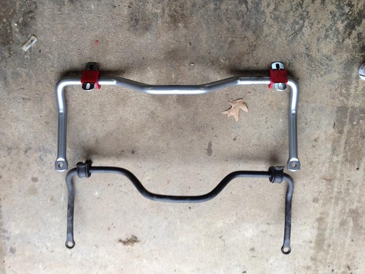

Belltech rear sway bar (won in a giveaway)
Street Performance shocks all around
Belltech sway bar comparison.

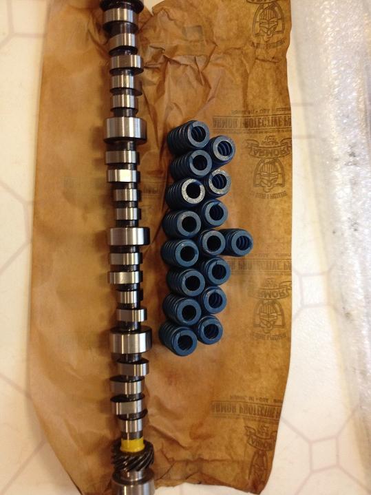

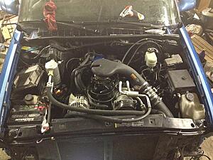

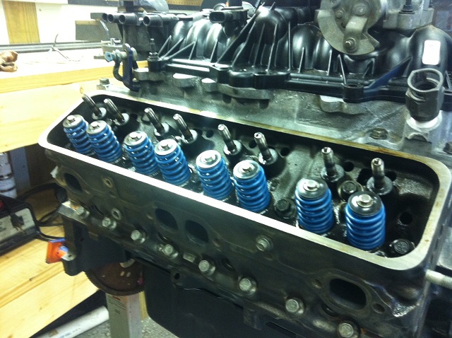

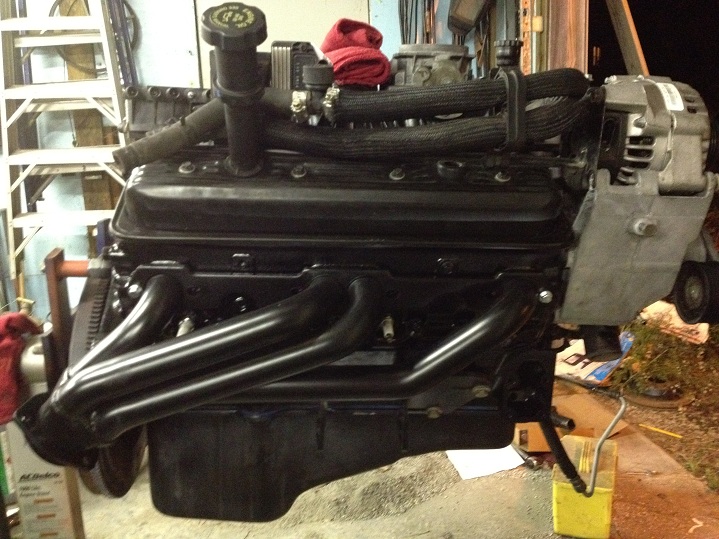

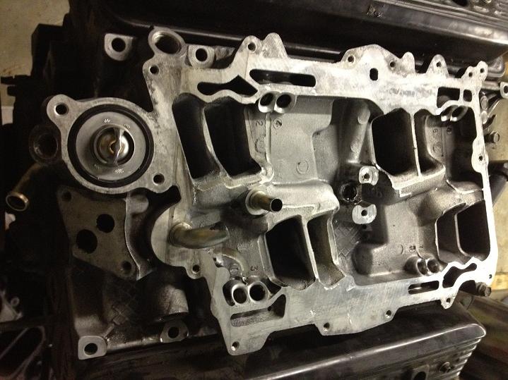

Engine:
350 Vortec
LT4 Hotcam
LS6 springs
Repinned for 411 PCM
K&N intake
Deleted EGR
Patriot headers
2.5" exhaust pipe
40 series Flowmaster
180* thermostat
Dodge Intrepid e-fans ran off of PCM

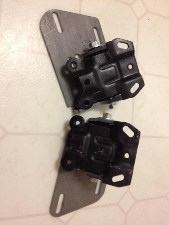

JTR brackets
2.8 mounts

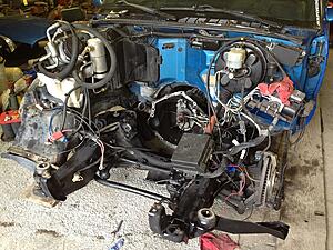

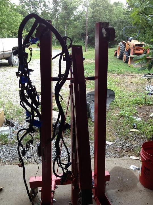

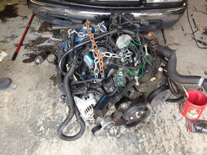

Harness labeled and removed:

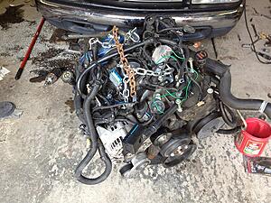

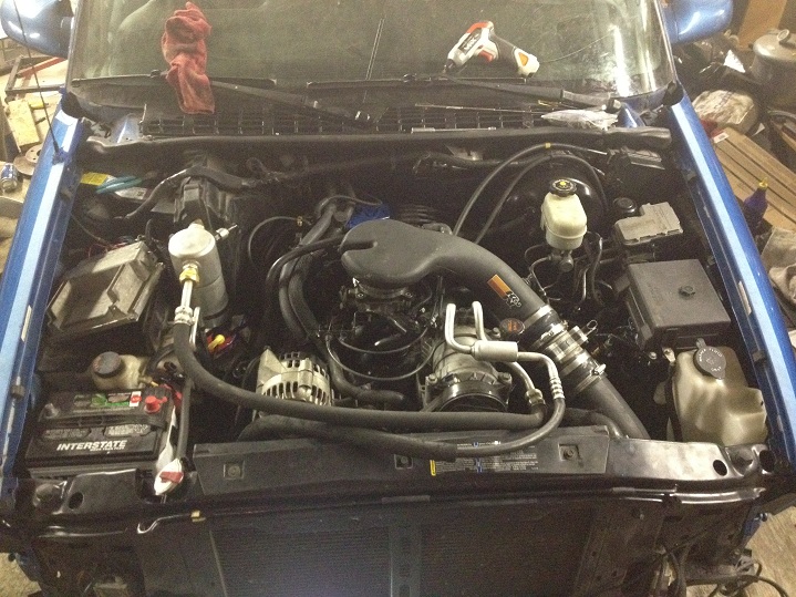

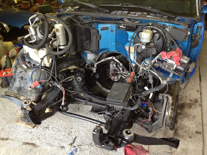

bye bye 4.3:

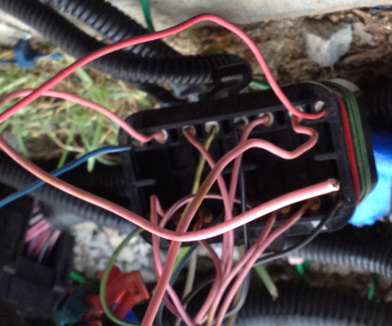

Repinning stock harness for the extra 2 cylinders.
Everything about together.

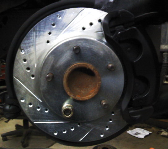

Core short throw shifter w/ Hurst arm and ball
Cross drilled/slotted rotors

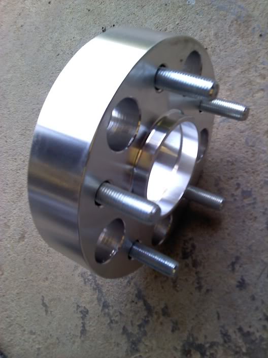

1.5" hub centric rear wheel spacers
Flaming River u-joint steering mod

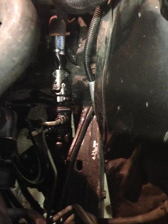

ZQ8 quick ratio steering box

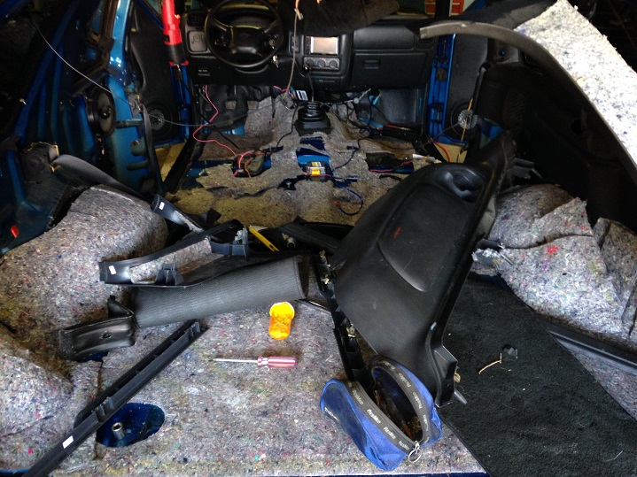

First I ripped some of the plastic panels off:

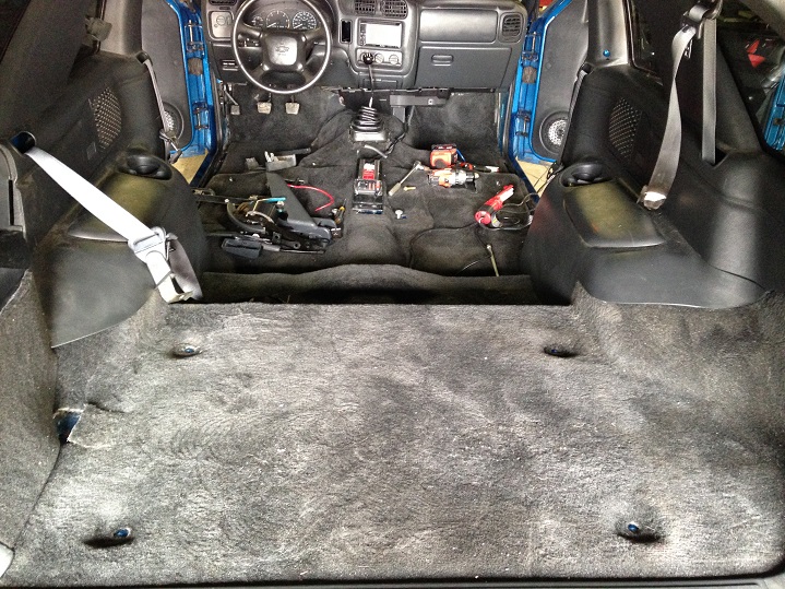

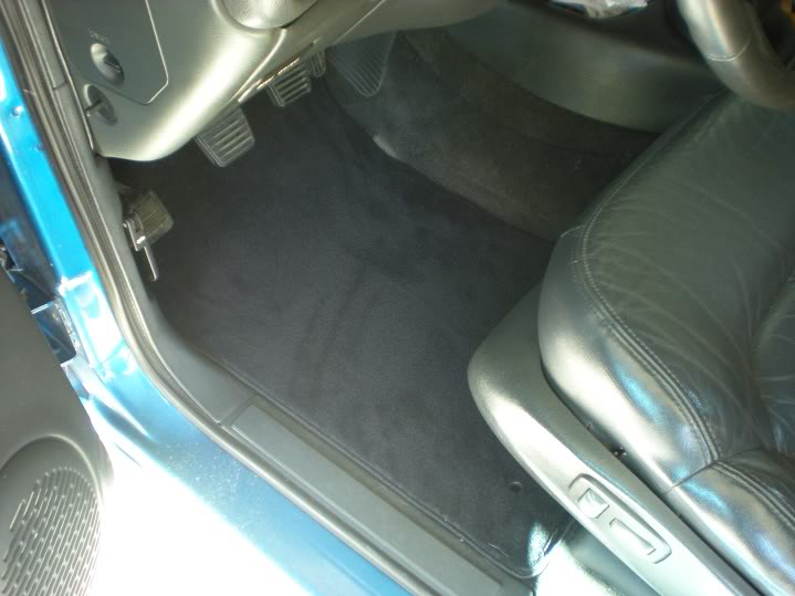

Then both sections of the carpet(looks like it came out of the junkyard):
Stained carpet before a good pressure wash(forgot to get an after pic, but it really made the carpet look better):
Back in. The cargo carpet looks real light here, but I think it's just how the sun was hitting it. Also notice how the carpet is covering the accelerator up. I didn't notice this until I got everything back together and cranked it. lol)

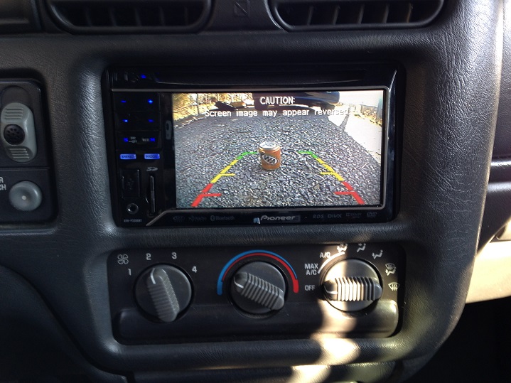

$20 rearview camera. Remember the original double DIN head unit I posted earlier in this post? This is my new one. I bought a double DIN dash bezel and made this one sit in like it should.
The camera's power only comes on when in reverse.

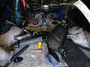

When I had the carpet out I ran:
A power wire under the jute backing all the way to the back and through the tailgate boot for the new rear glass release.
An accessory wire under it to the driver side seat so it now has power and heat.
For the camera I ran the RC wire with an on/off wire to the rear where the on/off wire and power for the camera are connected to the back up lights.
The camera wire is ran up through the floor via a plastic cap that was there from the factory.
I also put Gorilla Tape where all of the metal on metal contacts were. I haven't driven it much, but it seems to have made a difference.
Everything is taped down with Gorilla Tape as well.

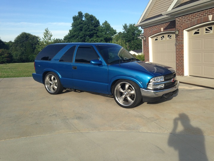

I purchased some Chemical Guys buffing compound and went over the entire Blazer.
