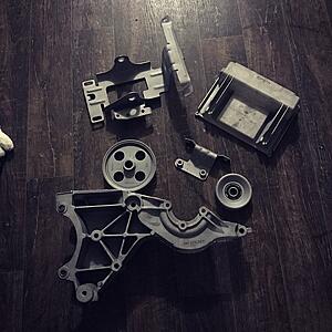

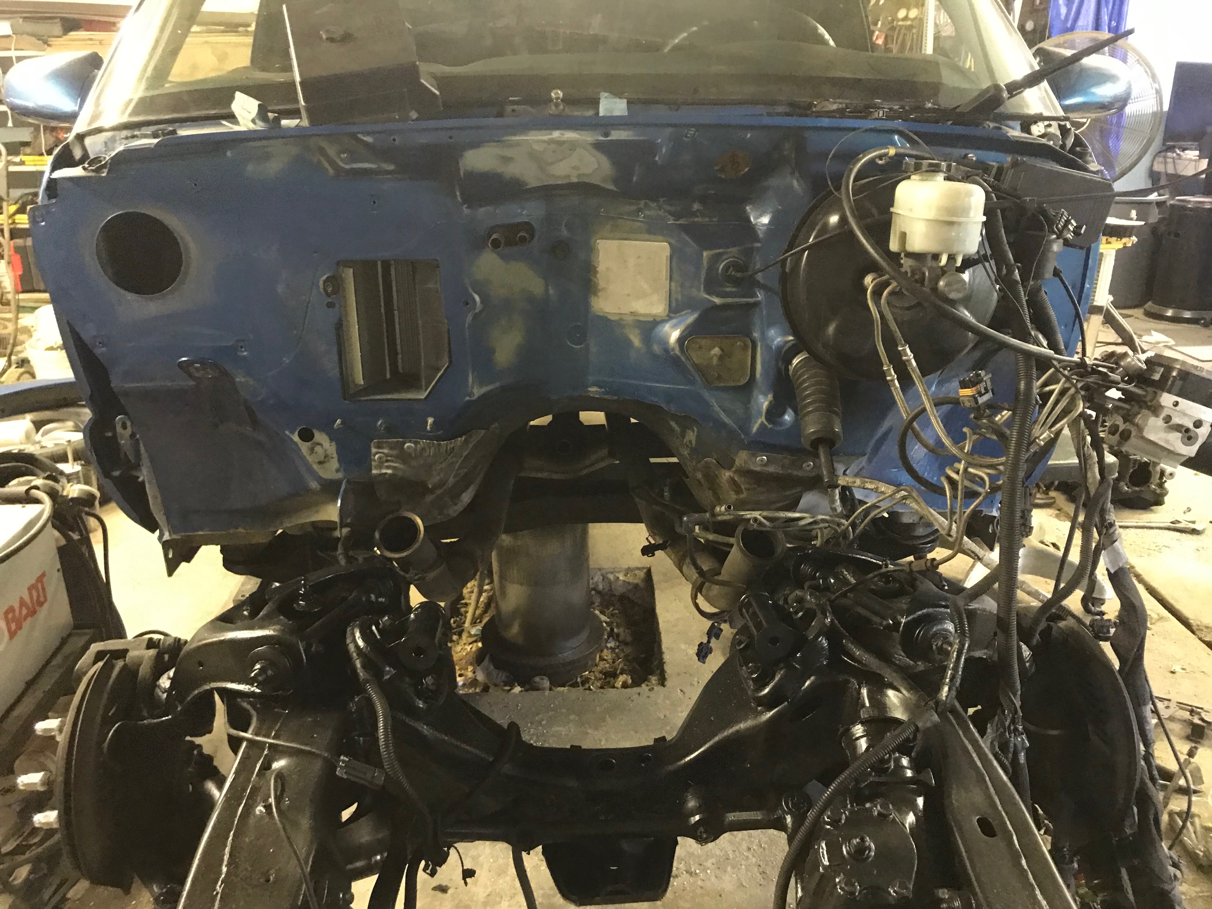

So I repainted the firewall.
Had some things bead blasted
Here's where I'm at today.

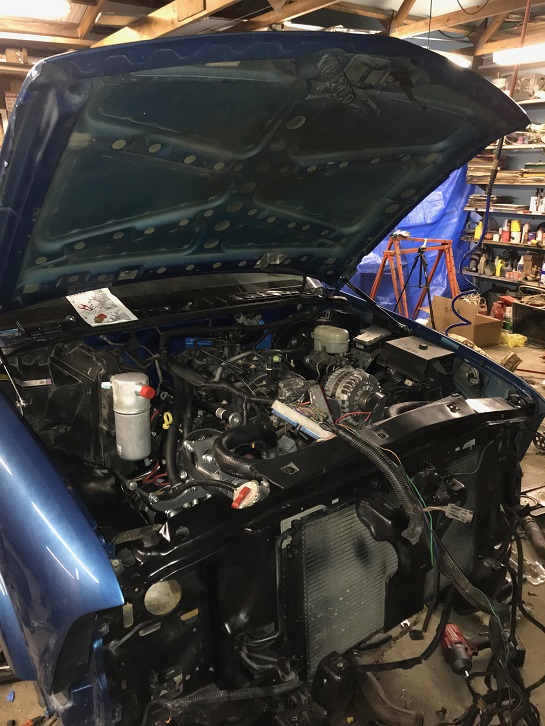

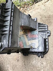

So the steering shaft clears.
Notched the AC box.
The aluminum block 5.3 raised me up about an inch
ZQ8 Blazer

Quote:
Originally Posted by
ZQ8 Blazer
Does it still need fluids?
BudRacing
Find More Posts by BudRacing
May 6, 2019 | 06:52 PM
29
ZQ8 Blazer
May 2012
56
BudRacing
At the time of the picture it did, but I’ve added all of them now and it didn’t change much if any.
