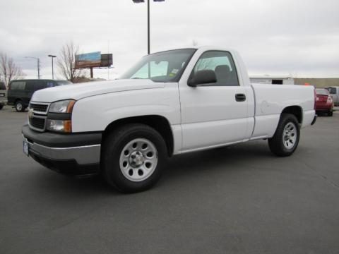

when i brought her home with 18k, paid 11,000 for it, 07 classic 4x4 4.8 4l60e:

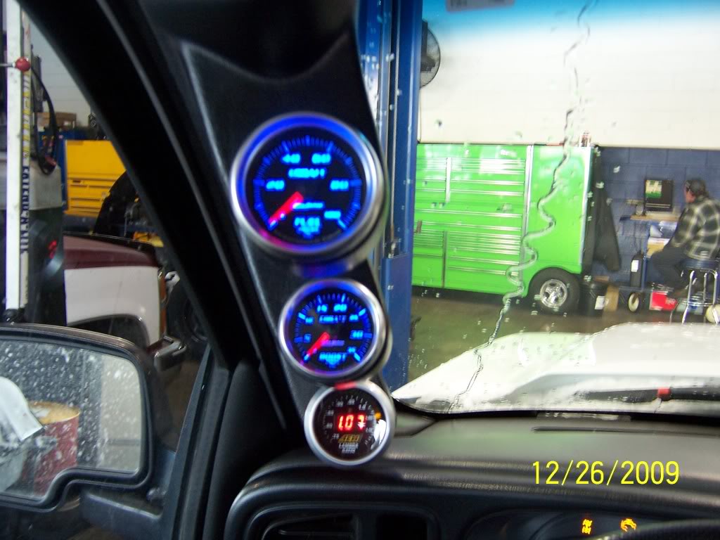

Added gauges, SS cluster and TBSS steering wheel/airbag next:

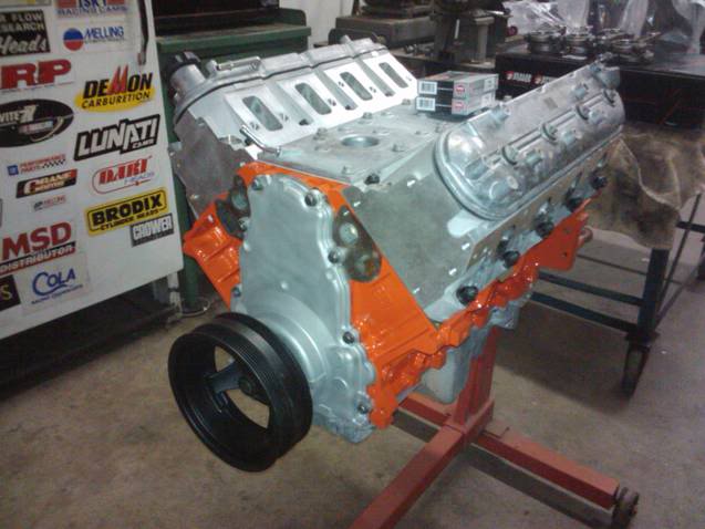

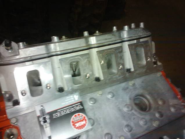

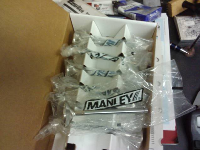

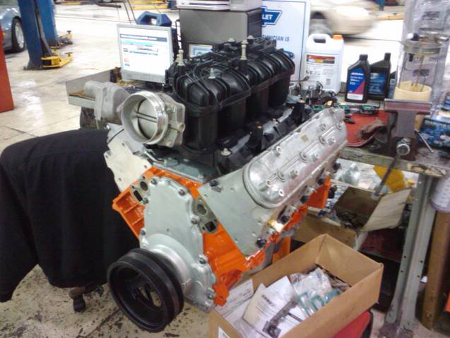

started building a LS2 with ported L92 heads, Vortech V2 kit and a comp TSP 224R cam:

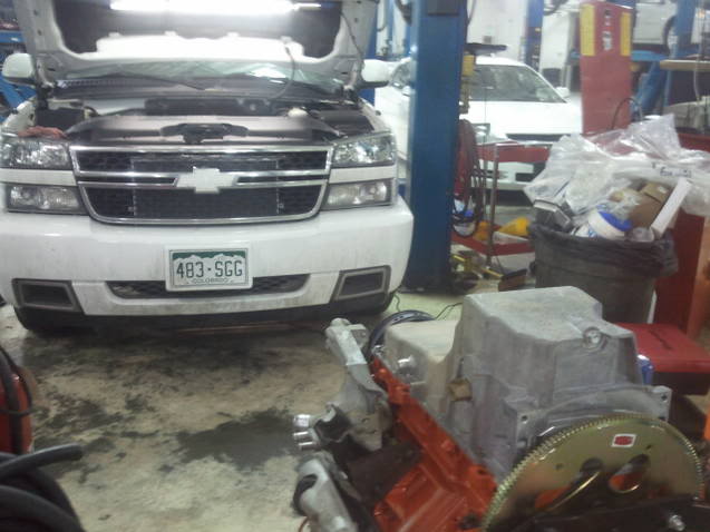

Got the LS2 running, added a WTA IC setup:
(Made 524 to the wheels on 7 psi running pretty lean, didn't get to finish because it spun a rod bearing on the next dyno pull........... found out engine was built way too loose by a local engine builder... sold it all and started slowly building my forged 370)

Started to build this junkyard LQ9 with 80k, added some off the shelf LS3 heads and a used LS7 cam, was built for my buddies 66 Chevelle but he let me borrow it for a while so i could get my truck back on the road while i was building my forged 370:

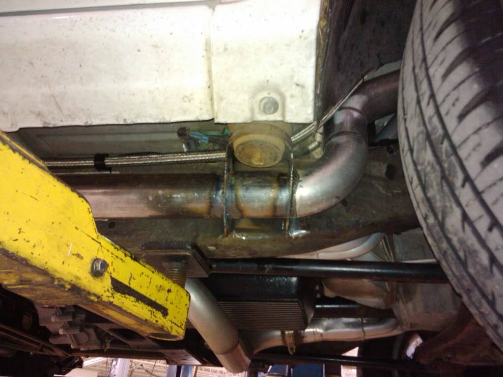

So then i started on the rear mount turbo setup using a TC78 and retaining my ATW setup from my Vortech V2, Ran this setup for a while... ran mid 14's until i got in touch with Shane and Zippy and got a REAL tune, we switched over to a 2 bar SD setup and tossed in a Pro Yank 3600 converter which got me to my best time to date of 11.66 at 115 with a 1.6' on 7-8 psi, we most likely could have got high 10's out of this setup but we were having boost control issues with only 2 test and tunes left before the track closed for the season and my 370 was ready to go in so we just tore it down:

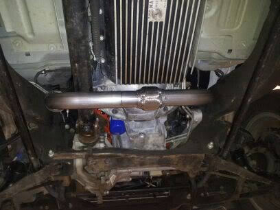

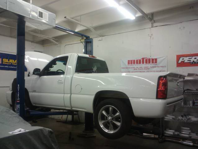

Finally dropped it! Did a 2/4 kit:

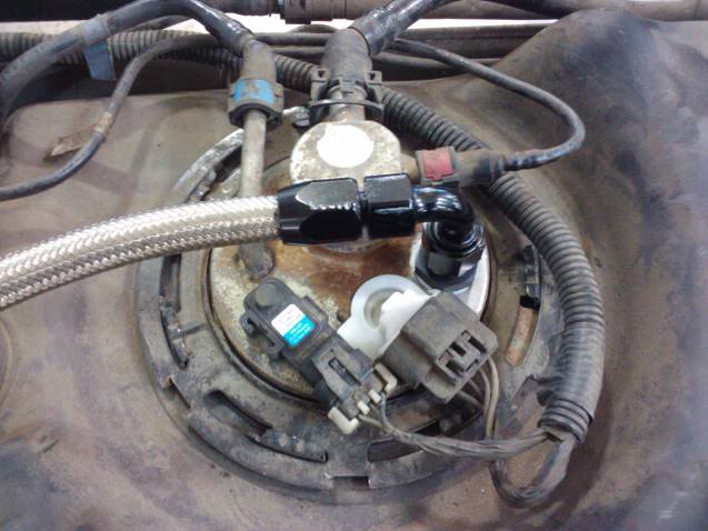

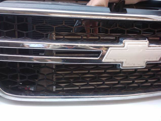

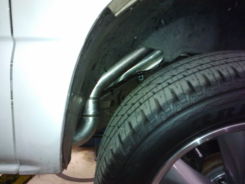

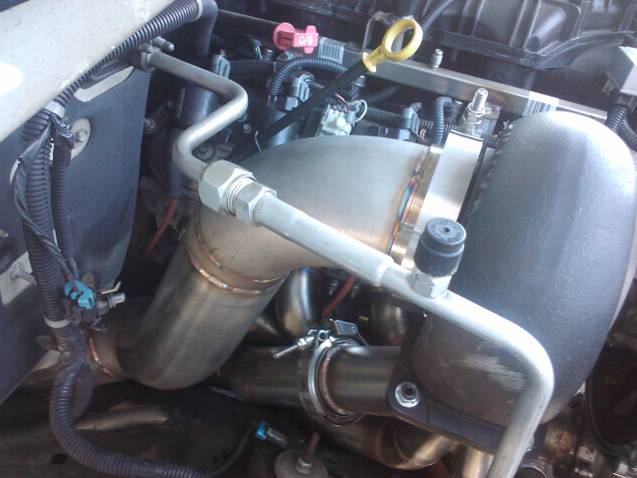

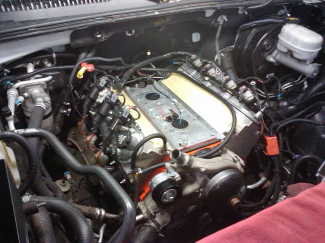

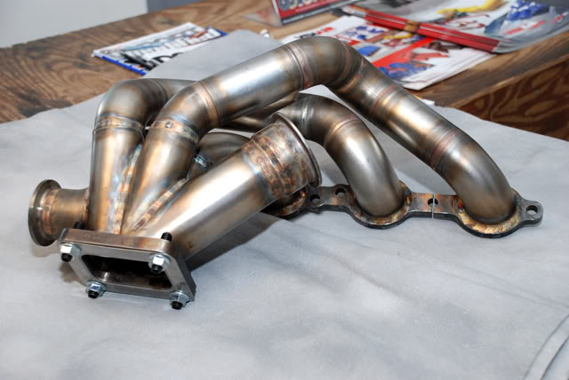

And now the 370 front mount build/install:
Old Jan 23, 2013 | 03:20 PM
89LS1FOXER's Avatar
iTrader: (47)
Posts: 857
From: Aurora, CO
Old Jan 23, 2013 | 03:24 PM
89LS1FOXER's Avatar
iTrader: (47)
Posts: 857
From: Aurora, CO
