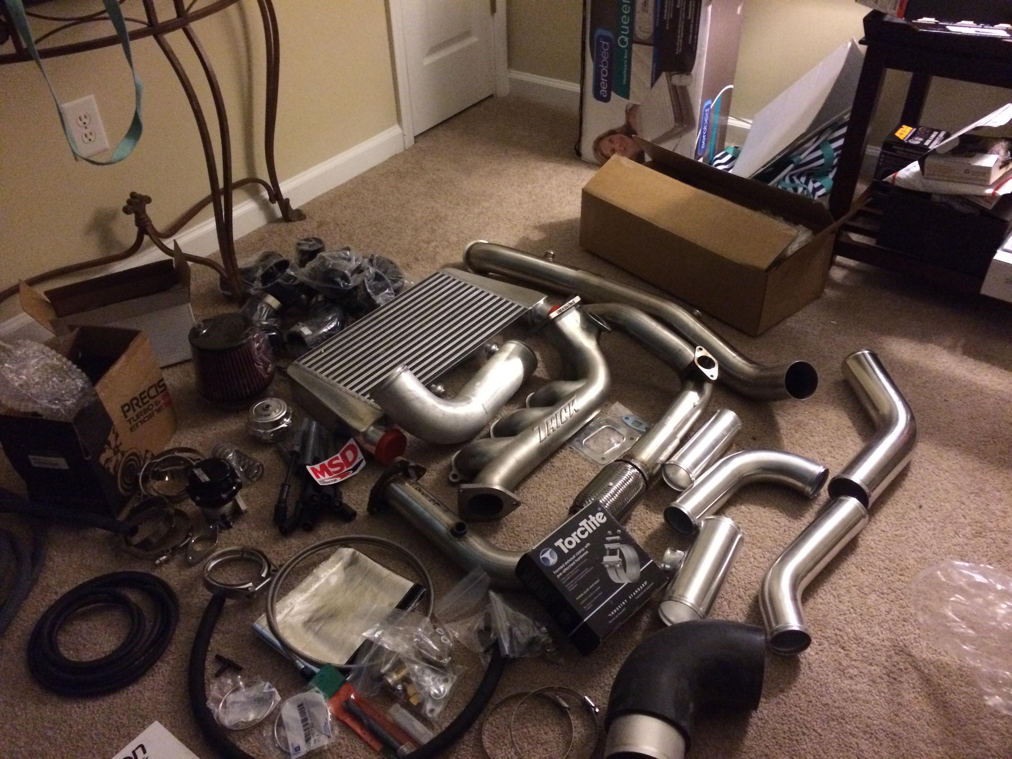

Hey everybody. I want to share with you and would love to keep up have yall share with me your experience and feedback. For my 2006 Silverado reg cab project doing a turbo/80e swapping/ cam. With my current 5.3 with 182,000 Still run strong.
Here that I already ordered-
Stage 3 trick kit with 76 Magunm turbo
From Ebay-
AEROMOTIVE FPR AEI 13109 FUEL PRESSURE REGULATOR
Siemens Deka 80lb EV1 High Impedance Fuel Injector (8)
Chevy LS1 LS6 Billet Aluminum Fuel Injector Rail Kit
WALBRO E85 RACING FUEL PUMP F90000267 450LPH IN TANK W-INSTALL KIT
Will take fuel system to shop do convert return style.
I finished order gauge
AEM 30-4100 DIGITAL WIDEBAND UEGO CONTROLLER AIR FUEL RATIO
But I need two more to go for fuel pressure and boost gauge. Maybe get AEM UEGO since like see all match gauges.
Right now I am focus buy a used 4l80E transmission. Which shift kit I can look at transgo? JUst say HD2 that all? Leave me comment for that. Yes I will get me circle D 3200 stall/ 40,000 trans cooler.
Hey I have problem understanding how to hook up for manual boost for my turbo. Trick say something from Wastegate to BOV? Is there any instruction or picture can I see it? It would be helpful. This is gonna be my first time own boost! I have this truck since 8 years when I bought first brand new and paid off. So I can play with my hobby and learning some experience.
Cam- give me some idea good for n.a then boost can share mix that cam will like it. How about Isky triple cam? My goal max 700 hp for this motor if possible,. But for sure daily drive maybe 500-600.
Here pictures-

On the boost control and BOV hose routing is easy. One of intake vacuum to the BOV. Next, turbo housing connection for boost signal install a fitting run hose from turbo to manual boost control from controller to bottom of wastegate. top of wastegate just vent it. Cam is easy to just call someone in the business and let them pick.
