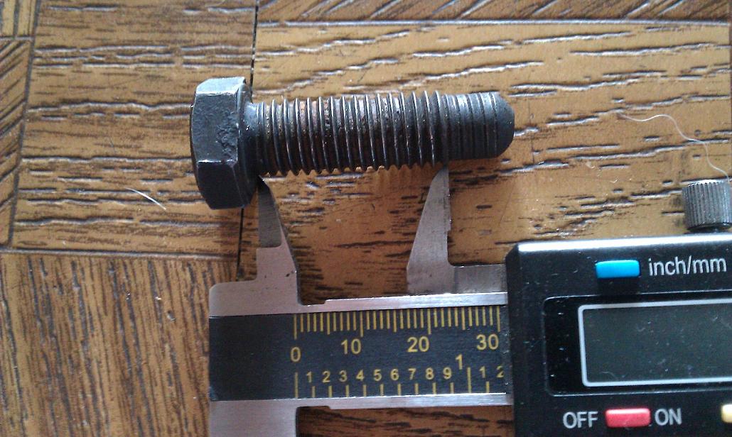

not sure were my calipers are at but there is about 1 1/8 inches of actual thread. I would say 30mm I will try and get you a picture.

30mm of thread and 40mm long... of course the only one I can find doesn't work.
You can always have extra threads but not enough will screw you...
BTW set the pinion up 5 degrees and set the new flanges on at 45 degrees. That way your disc will then be clocked correctly.
