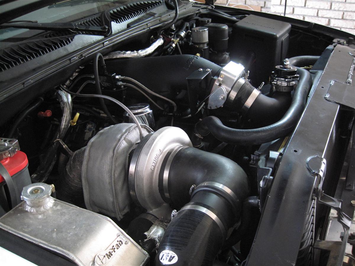

I may have the hot pipes modified instead of the driver side feeding the back of the passenger log, have them both combine at the turbine housing and switch to a T6 at the same time with the same turbo, just T6 exhaust housing....thats a few weeks off though

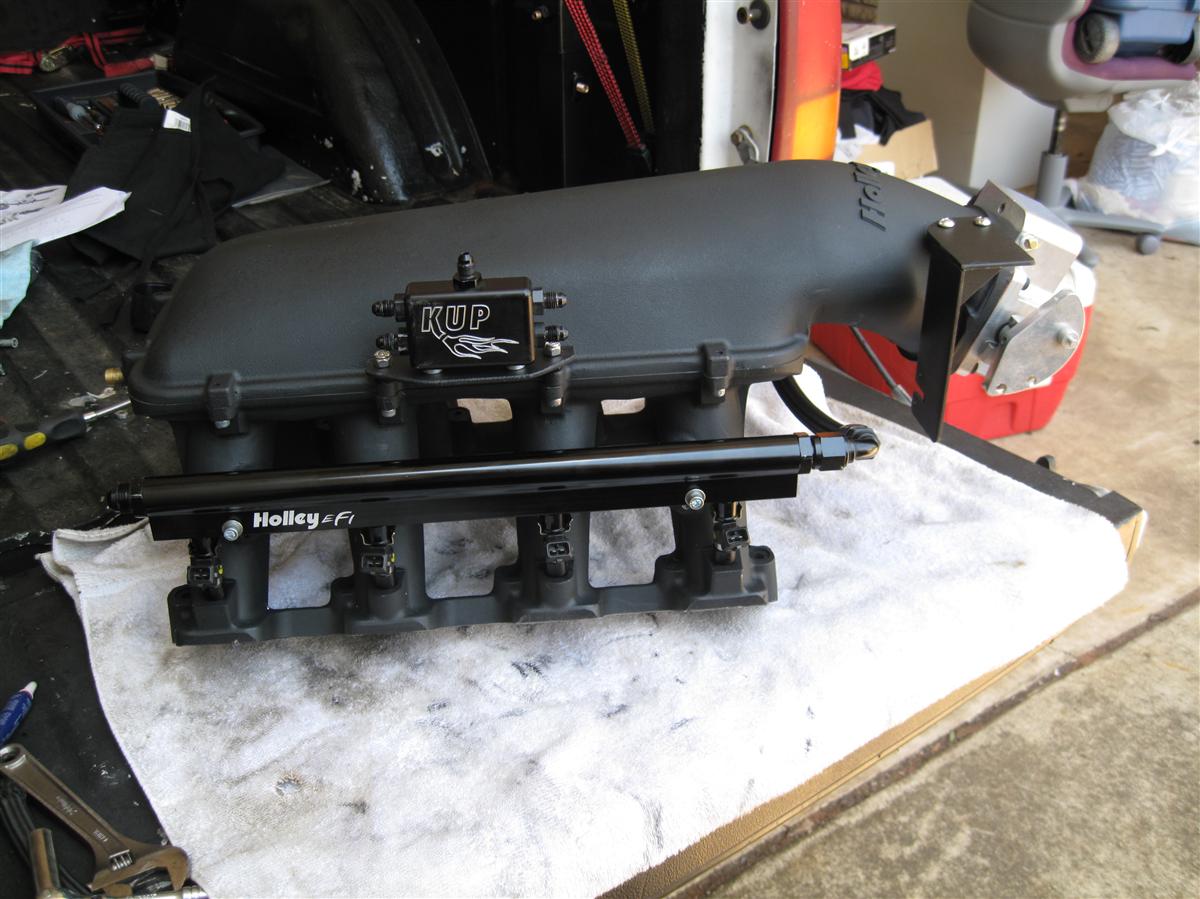

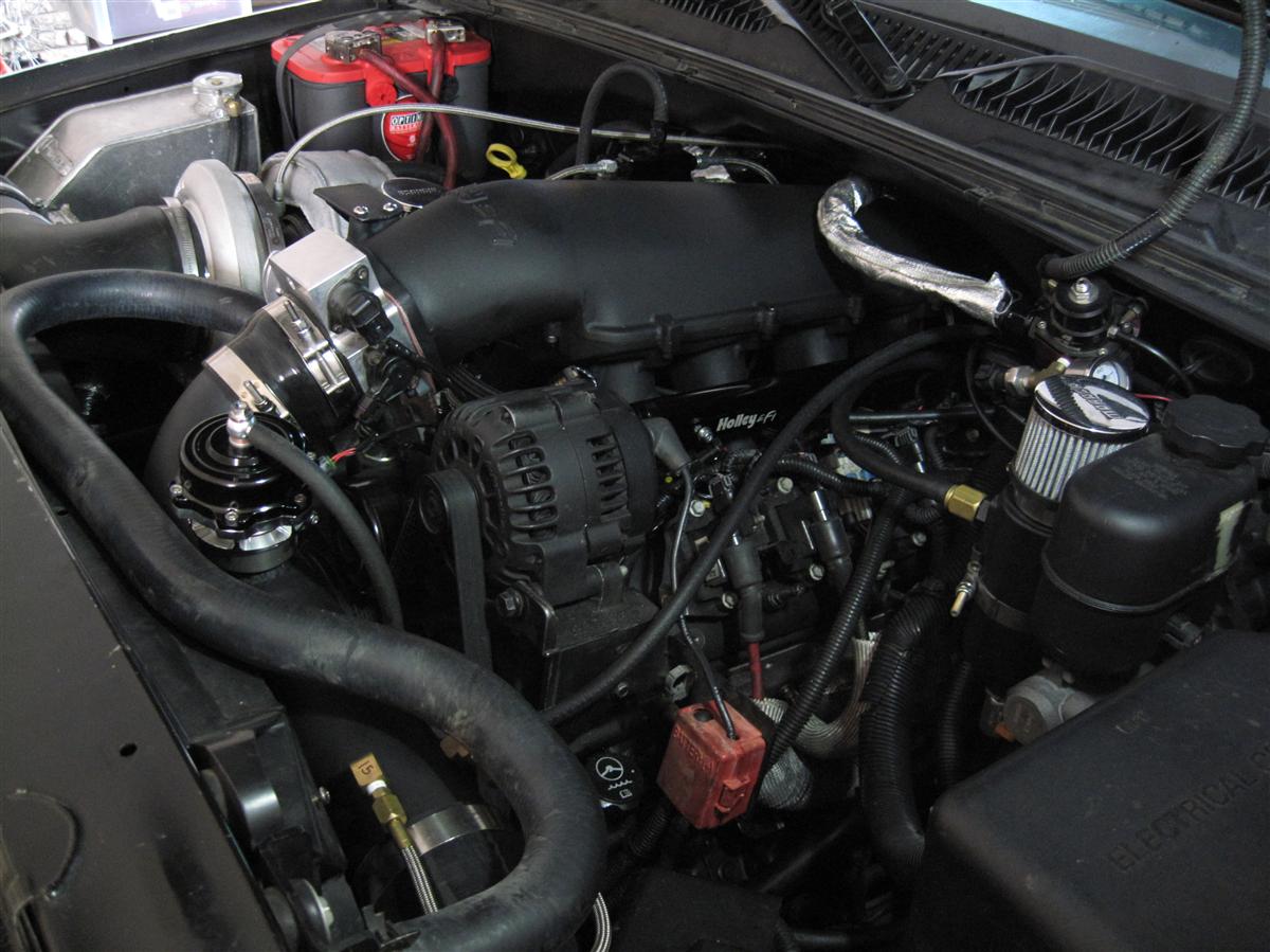

Summit kicked *** on this one! I ordered the fitting I needed at 6:30 last night and it was at my doorstep by 11 this morning! Of course ran into more issues....those studs, especially the rear ones, are A BITCH to get to! I hope I never have to take this intake off lol. The new fuel fitting fits perfectly behind the alternator and I shortened the crossover hose to go under the intake. I had to extend the wires for the alternator, IAC valve, and TPS sensor because I shoved the harness behind the intake. Not a huge deal, just took time.
The coolant block came out really good I think. I used some plastic spacers to keep it off the intake manifold, so it shouldnt add any heat to it. Also adjusted my meth controller to have a slightly higher turn on point and higher initial amount.
I let it idle and made sure there werent any leaks and everything works great. Drive test comes in a few hours when there will be less traffic. The low tonight is 63! I can honestly say this took way longer than I thought it would, but damn does it look sexy!
