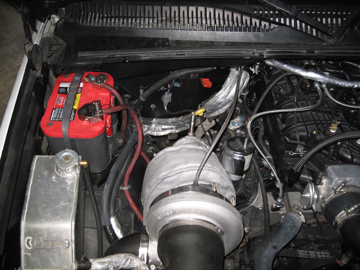

Finished a couple things lately....Reed sent me a 1.25 AR housing to try out which I did tonight and I must say it felt like it really helped on the top end and lag doesn't seem to be affect an appreciable amount, so thats a win.
Also finished moving my battery to the passenger side to make room for a bigger custom meth tank I have in mind...

looking pretty good! I kinda like the battery over there..

I do as well...I left everything else basically. The 0 gauge wire from the positive on the battery goes to the red junction box by the alternator (wire goes under the engine), and I have a 4ga wire from that same stud to the main fuse box. The 0 gauge wire from the negative on the bettery goes to the bolt you can barely see in the front of the passenger side head. I have another 0 gauge from the rear driver side head to the factory ground stud on the firewall, and I have a 4gauge wire from the bracket under the stock battery that is connected to the fuse box hooked on that same stud on the firewall. The only thing I may do later is add a ground directly from the battery to the frame, but I have zero issues how it is so I think it is good enough. I already had all of the wire from previous projects, just needed $5 worth of ring terminals from home depot for the 4ga.
