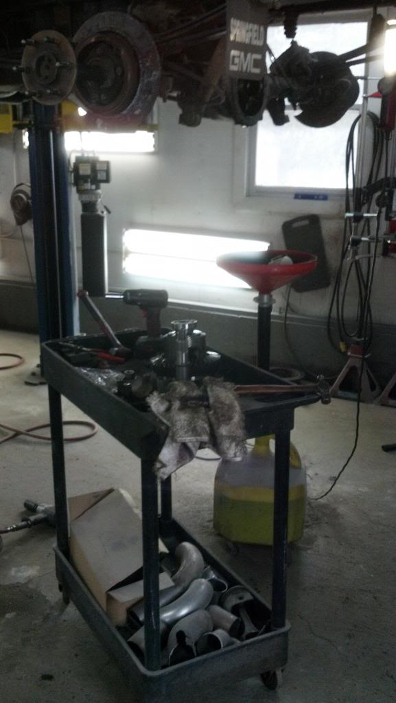

Ever since the 4.88's were put in the rear end had a slight whine/howl that's been progressively getting worse and worse. Truck has maybe, MAYBE 175 miles on it. Decided to yank the rear and apart and see what the deal was.

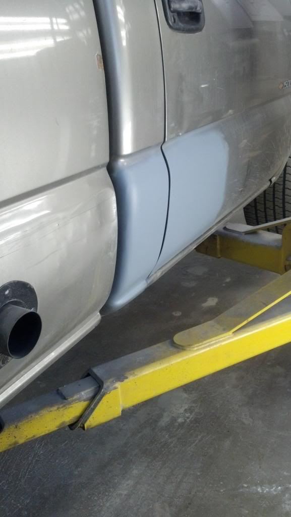

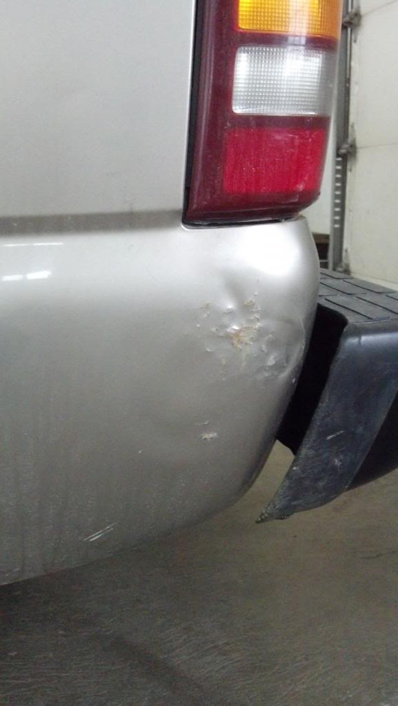

With the truck being down for a bit, I decided to have my father do some body work on the truck and clean it up a bit.

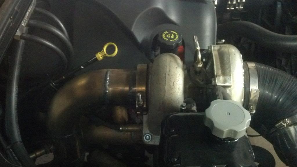

Annddd, here's some good engine bay pics since I don't think I've uploaded any good ones of just the bay yet.
