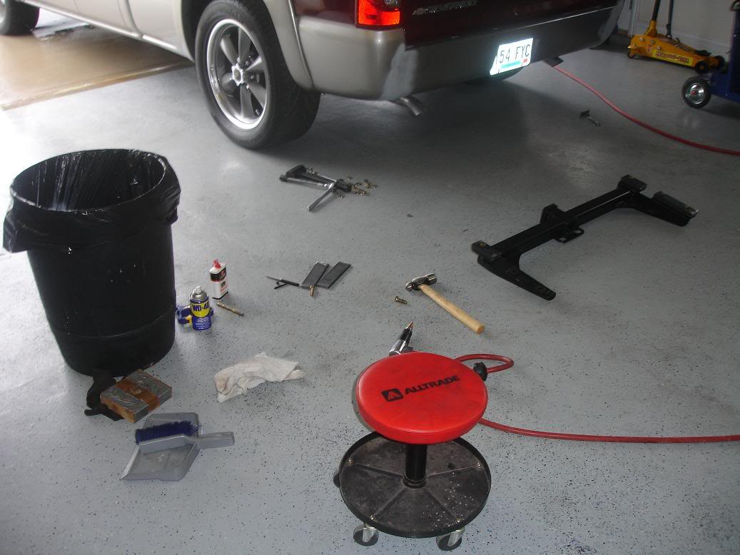

Thanks Dewey. Funny you should ask about the license plate bracket. Just getting ready to go out and work on it. Two things I can do that I see. Just thought of the other yesterday. 1> The bracket will actually travel up far enough, it's just hitting the actual pan. So to fix that I'd have to trim the upper license plate reveal. Don't feel comfortable doing that. Has to be perfectly square/straight and I don't know if there is enough there to trim. I think I'd wind up screwing that up. So I'm going with 2> Drop the actual hitch. It needs to come down about 3/4". I've bought some flat bar and going to space the hitch down where it mounts to the frame. Get to test out my new plasma cutter.

All of this just to get the hitch to go into place with the license flip I bought.
Doesn't look like much but damn a lot of time fabricating these spacers. First cut them to length with the plasma. Grind on them a while to clean the burrs up. Use the hitch to mark where the holes need to be. Drill with the largest bit I have 3/8", then open them up with a step bit.
Here is the idea. Two 3/8" thick flats to lower the 3/4" I think I need to make it work.
