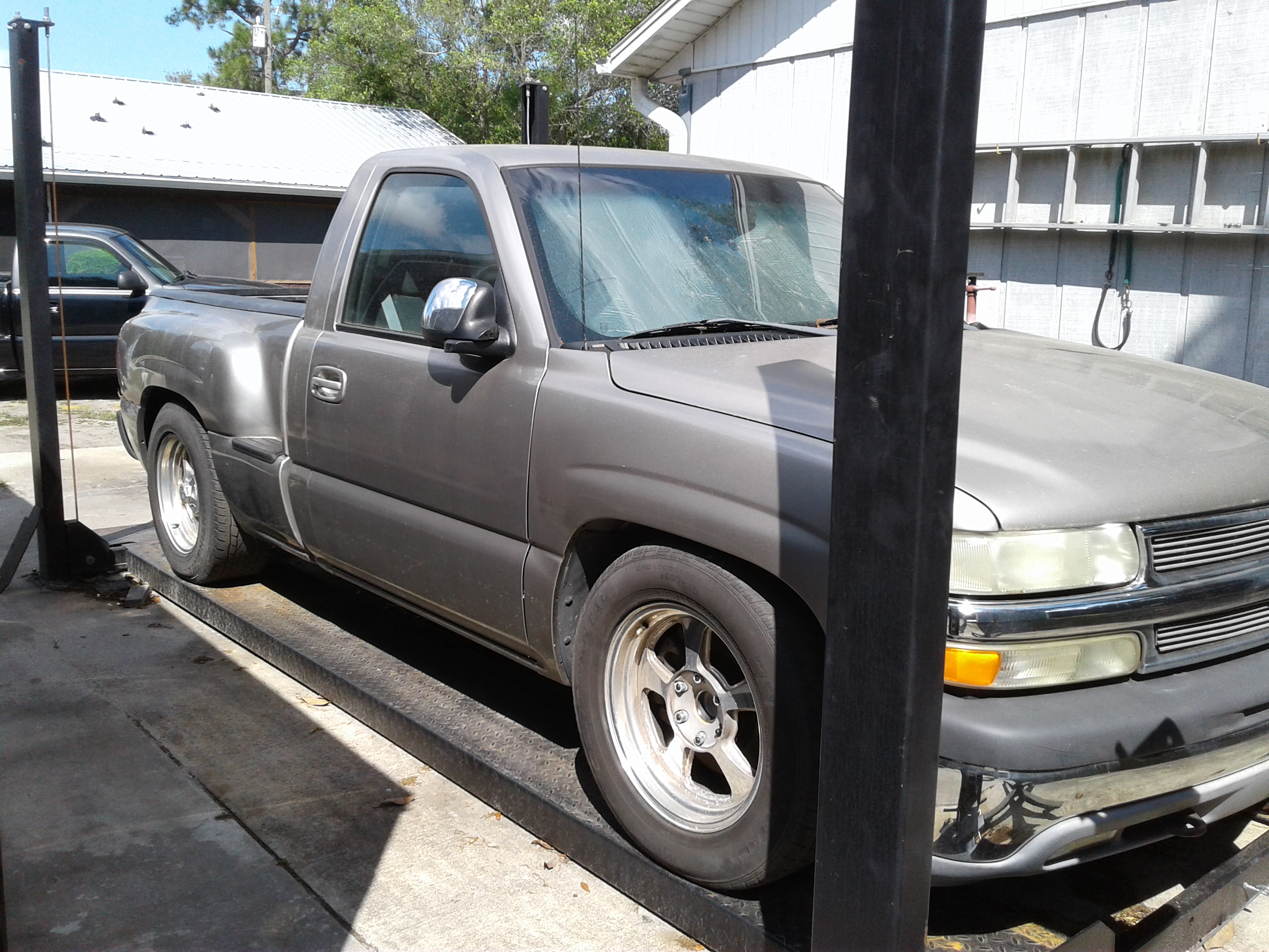

Finally got around to installing my spindles. Checked pinion angle, going to need the shims, not a fun job. Have all of my parts for the top end upgrades. Hope to hit the dyno and retune by May.
