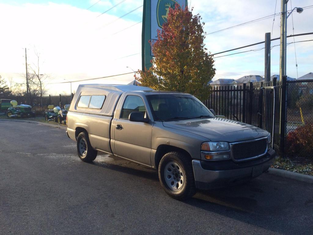

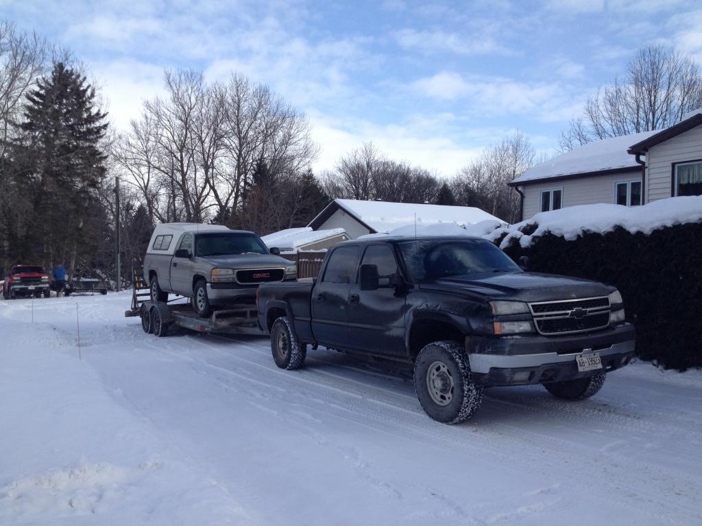

I picked this 02 gmc up off a friend knowing it needed head gaskets. From what I've read and gathered felpro gaskets are the way to go ? Correct me if I'm wrong. Also anything else I should do while I have the heads off ? Should I keep my stock heads or pick some other ones up , if they turn out to be crack? I do plan on putting a turbo on this truck and turn it into a play truck. Anyways here's a couple pics of what this thing looks like.

Cap has to go! I can't even pay anyone to take this thing away though lol.
