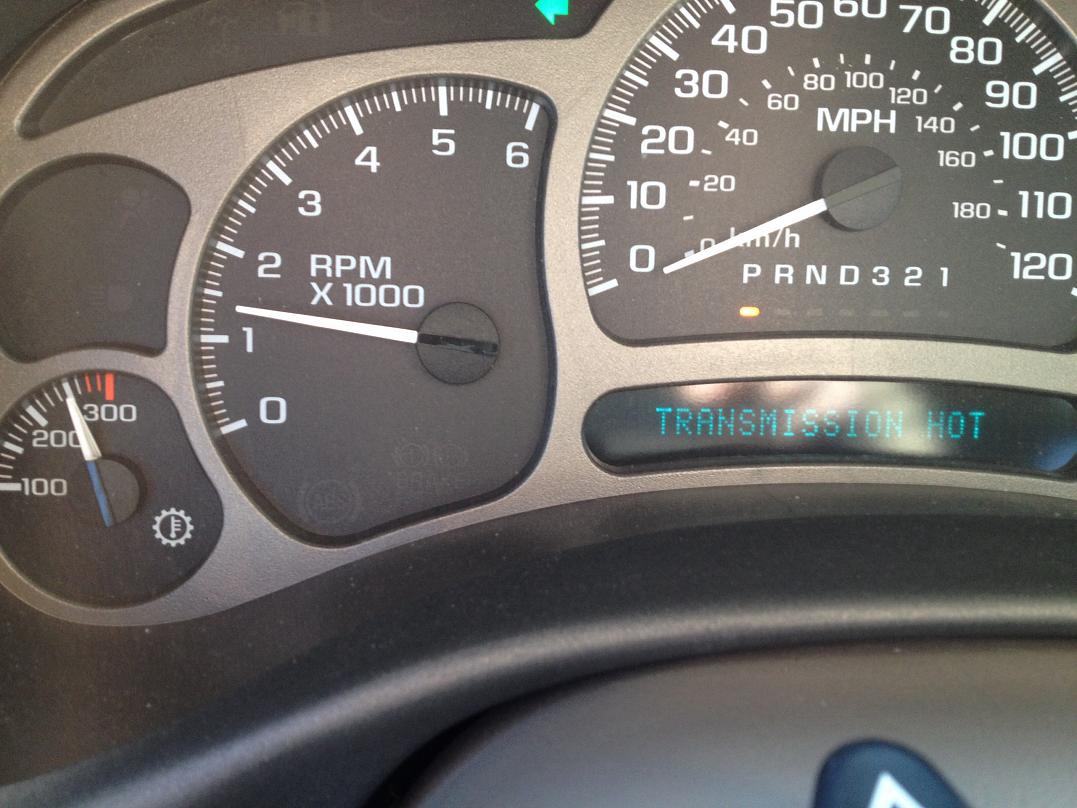

Old Mar 24, 2014 | 06:49 PM
  #80
lsxperformance's Avatar
Joined: Jul 2010
Posts: 789
From: Waverly, Ne
Ya I'm gonna go though the Trans before the converter goes in and have everything checked. It's been real hot for long periods of time when pullin. It dosent slip other than the converter and it only does this with a loaded trailer. With an empty one it's just fine. Soo strange..
