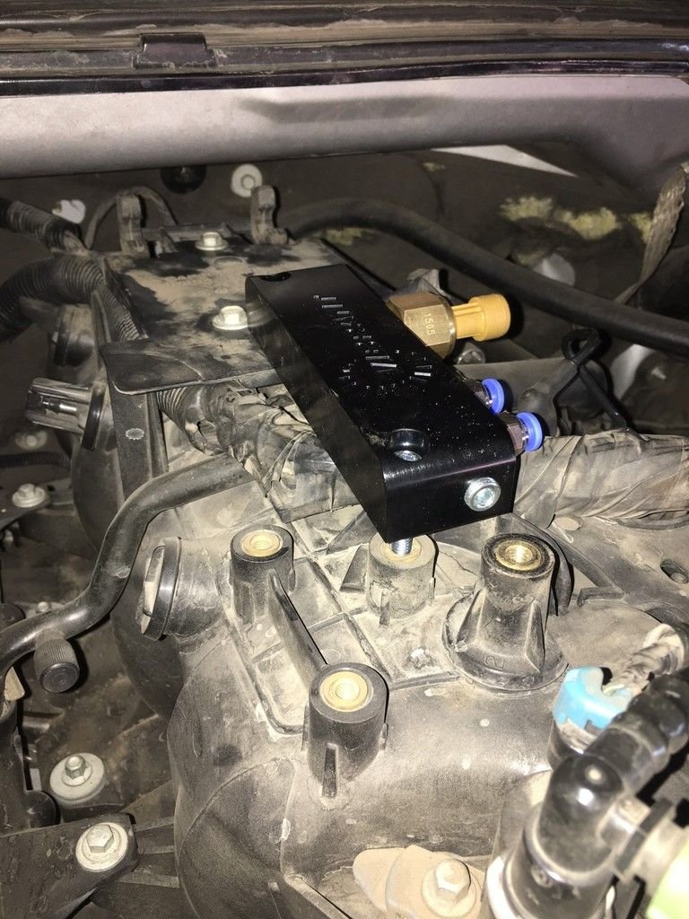

Got my vacuum manifold mounted and connected. was able to hide it under the engine cover. I drilled a hole in the plastic piece in the back and bolted the manifold down and this lined up perfectly with an unused threaded bolt hole in the top of the intake . this also lined up perfectly with the vacuum port i intended to use. it is the vacuum port that supplies the stock regulator on the rail. The bolt for the engine cover is close to the manifold and some of the excess plastic on the cover had to be trimmed to clear the manifold. trimmed it up and engine cover sits down completely and now the manifold is completely hidden from sight and very short runs of line to manifold. found some random hose that had 90 degree bends that I cut down to fit my application and could not ask for a better fit.
now that I have ports available I am ready to mount and install my aeromotive fuel pressure regulator into my factory return line. I just need to make a bracket so I can mount it...
