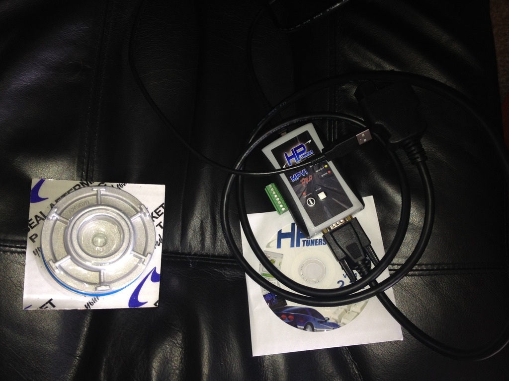

Got my servo and HPtuner in the mail today!
also have a AFR500 wideband and efans on the way. decided that I am going with some SS 1 3/4" heads for cost savings and plan on pulling trigger on some new Texas Speed SS header and ORY when they get some in stock. Unless some used kooks or ARH pop up in the meantime.
also decided that I am just going to utilize some stock 243 heads ( get them milled to keep stock CR) and piece together a heavy duty valvetrain instead of paying top $$ for some TAE ported heads. after i determine the setup I want , as far as valvetrain , I will be picking up second hand lifters , springs , rockers , and rods. hoping to keep the heads/complete valvetrain and cam around $1k total.

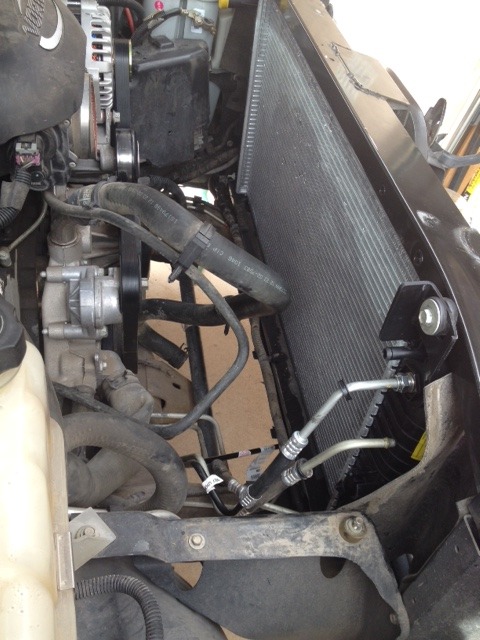

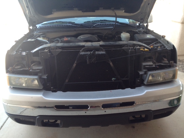

here is engine bay before , you can clearly see the large radiator shroud that is hiding the clutch fan
Here i dropped in the new 34" spectra CU2423 radiator with tranny cooler. You can see that i ran the new line that goes from the radiator tranny cooler OUT to the tru-cool IN (see black cooler line that is plugged in the upper cooler outlet on the radiator).

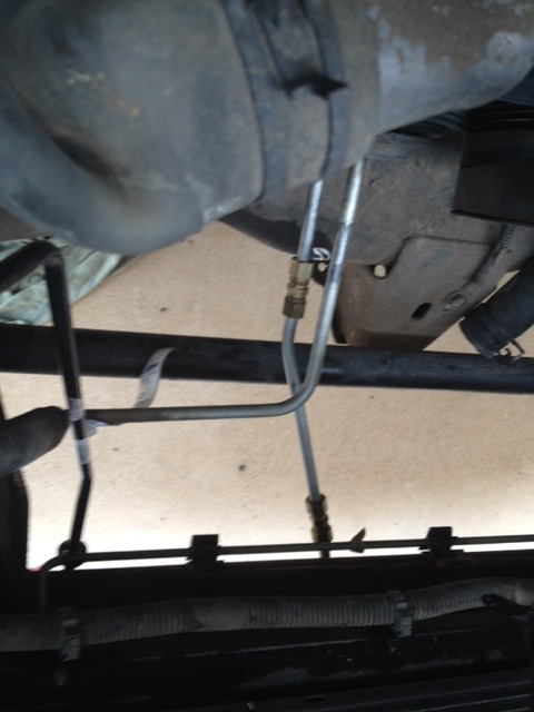

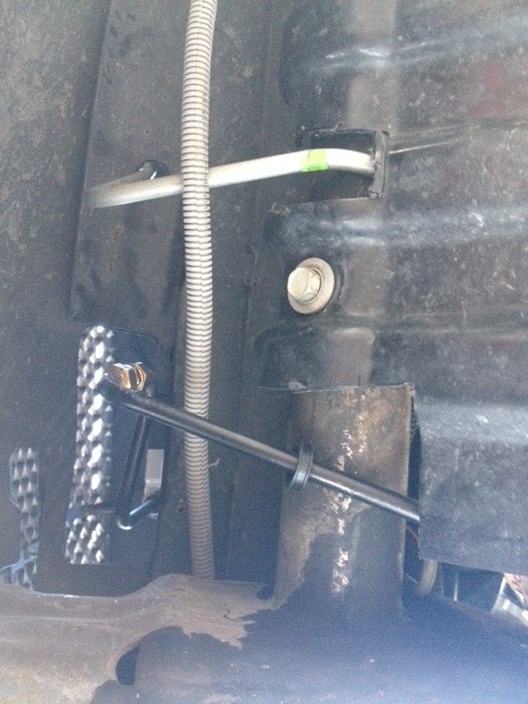

I also ordered the wrong lines so we had to modify the line that came in the mail and cut this into the existing return line to the transmission

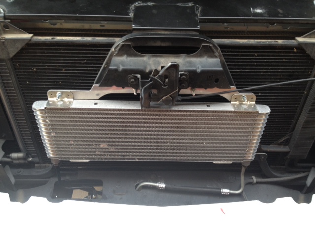

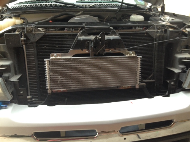

Here is front grill removed to show I did not have the Aux cooler that most tru-cool install threads utilize .
Here is the tru-cool 40k mounted up
Here is the tru-cool with lines installed
custom line installed
had to modify the splash guard to allow the lines through

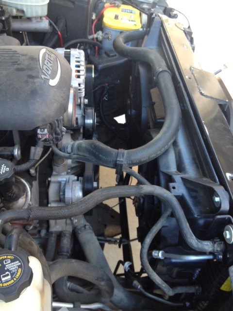

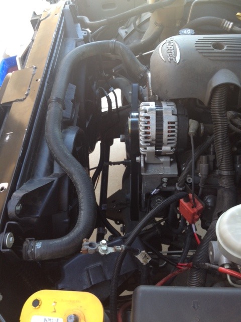

electric fans in and wired up using ls1fans.com harness

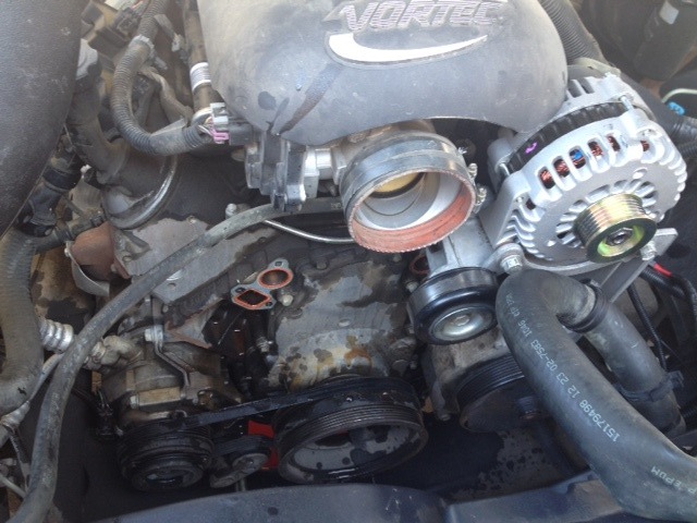

While we were in there we replaced the serpentine belt, the a/c belt and put in a larger 145a alternator. needed to get a little longer serpentine to compensate for the slightly larger pulley on the new alternator.

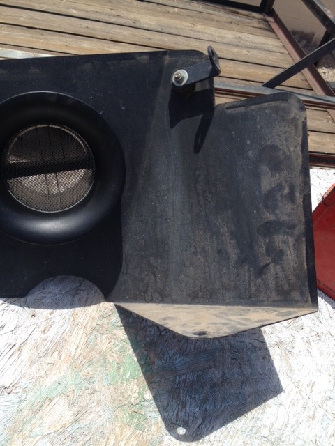

with the 34" radiator, the K&n airbox that I had would not fit. The box uses the empty (now occupied by radiator) radiator mounts . So we cut and bent the box to allow room for hoses and radiator.
before:
after: cut out a section and bent it over, this allowed us to utilize the radiator mount still. We also drilled a new hole for the lower mount.

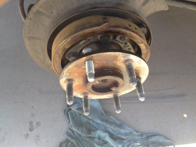

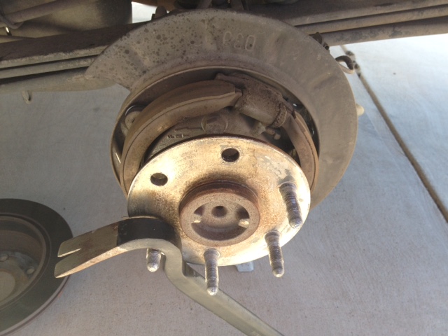

A couple of busted studs that needed replacing
studs removed
new studs going in
new aluminum 17" rims to replace the steely's

truck now has efans and tru-cool 40k tranny cooler!
before:
studs removed
new studs going in

Then when I went to test drive to make sure all works I got back and immediately started leaking fluid on the driveway. water pump just went out!
pulled it off and got a new one from napa. with the new fans already in place all we had to do was remove the belts and the hoses. easy swap.
Installed new pump and thermostat and all is good. fans work as they should , tranny cooler working ( wish I had a temp gauge ) , and new water pump is pumpin.
