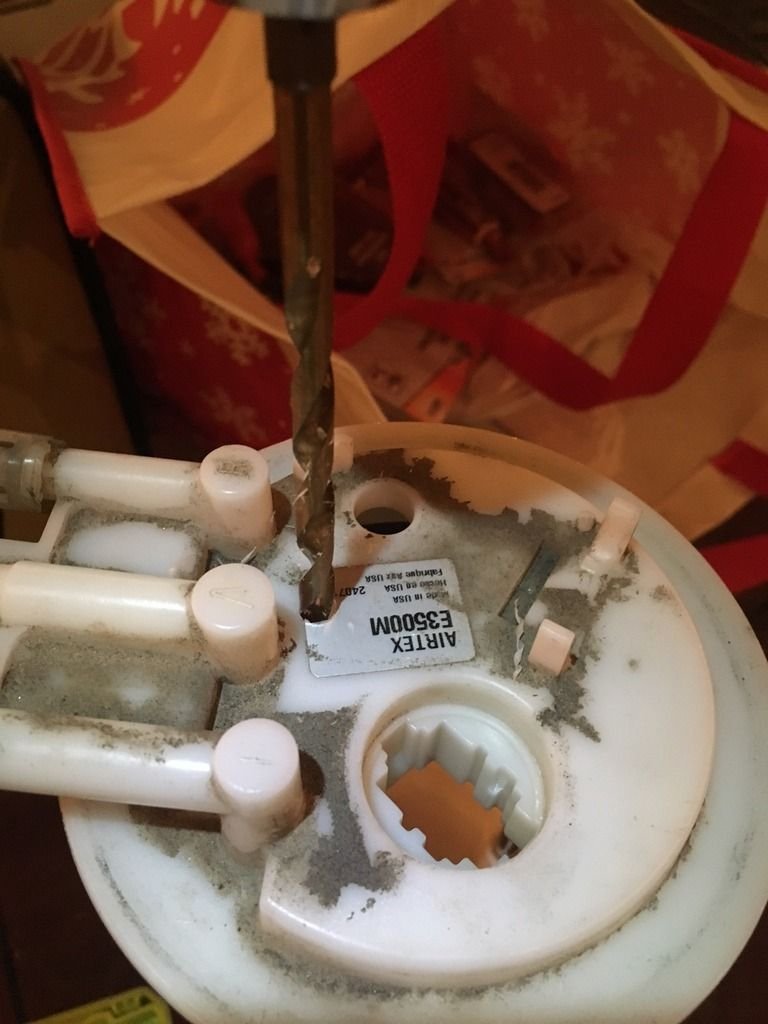

so on my initial tune i ran out of fuel pump when trying to run boost higher than the spring pressure so a second fuel pump was in order. i bought a junkyard fuel bucket to modify and ordered 2 new 450's and started working on putting these together. the 99-03 buckets are a very tight fit for the walbro 450's , they had to be staggered to get them to fit side by side. i ended up clearing out EVERYTHING inside the bucket to make room and just squeezed them down in there.

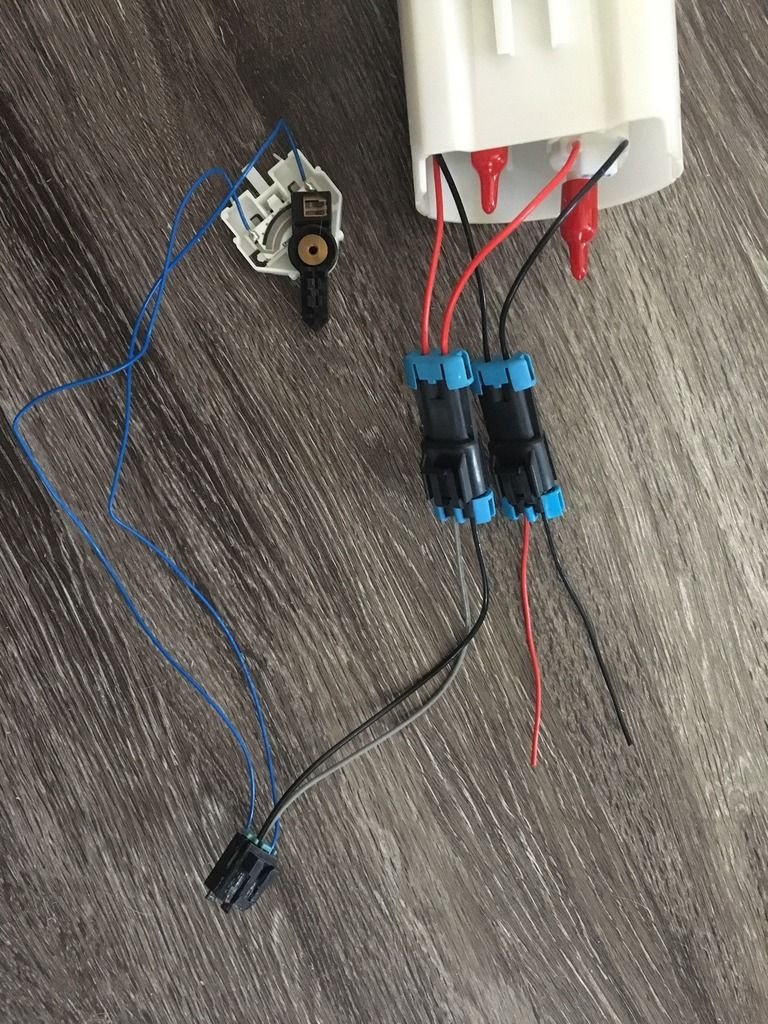

the plan was to build a second separate harness for the second pump. i decided to run the power wires through the factory fuel hat connector and run the grounds separately.
i used the existing connectors that came wired to the fuel pumps and just swapped them so one connector had the grounds and one had the power.
drilled new hole for the stud that will be used for the ground wires

was able to build the harness exactly the way i drew it out in the diagram. built a separate harness for the second pump that is triggered by my eboost2 at a specified boost psi. then i made an intermediate harness that connected both of the power harnesses into the top of the fuel hat. i used the exact same connections on both so that i could swap the main and secondary pumps power around. my thoughts were that if my main pump fails , i could just swap the connectors (i have them accessible from under the truck with no tools required) and use the other pump as the main pump.

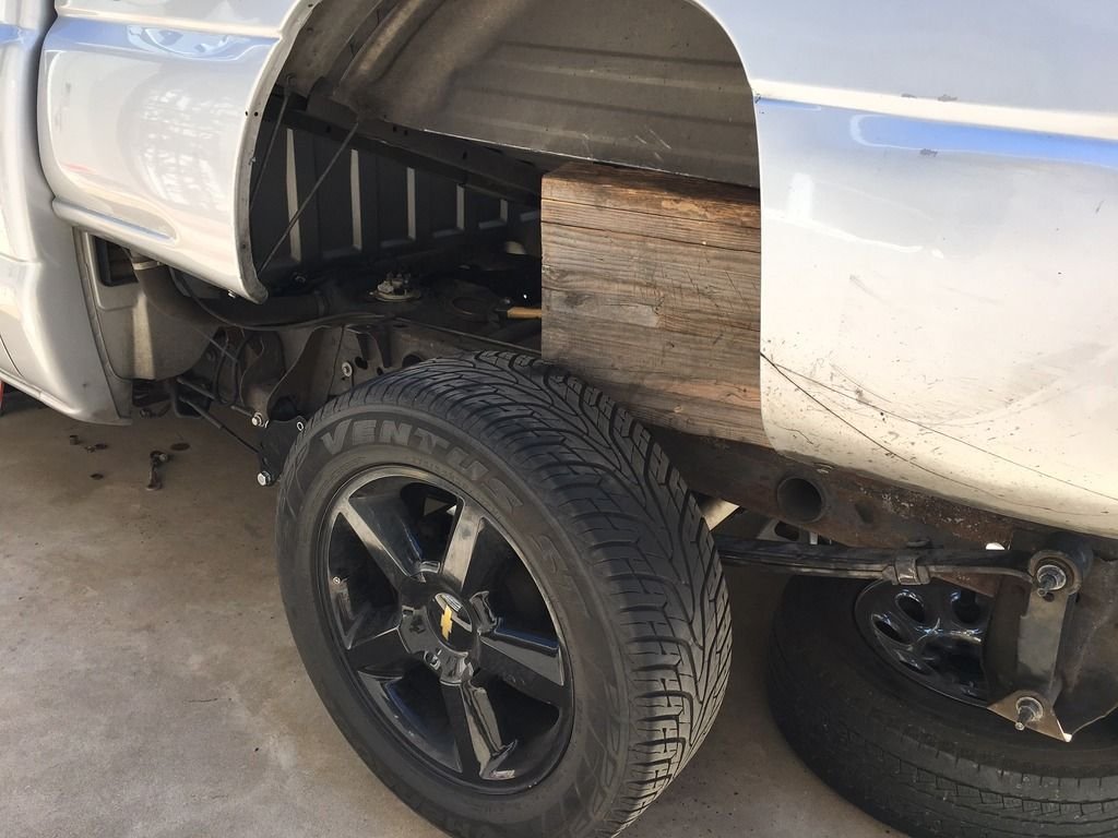

now i had to figure out how to install it solo. saw lots of people just tilting the bed so i tried this out. i kept my heavy bed topper on and made this step more difficult than it should have, took a few tries to get the piece of wood in there but i got it! **** was heavy.

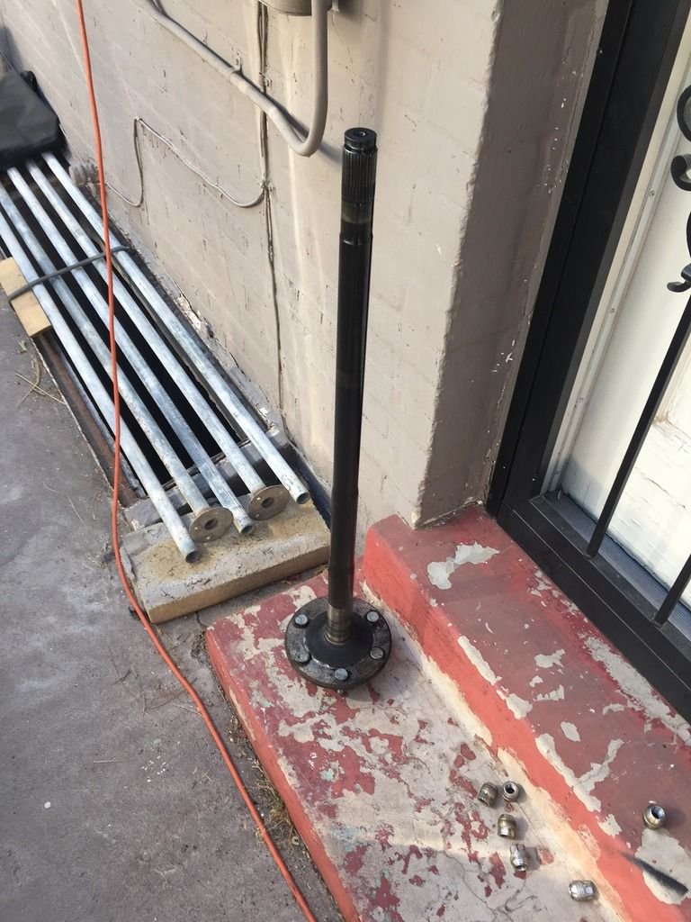

pulled the rotors off and realized you have to pull the axle out to remove the parking brake! did not know this . i had no idea how to pull the axle out so had to do some internet reading and finally figured it out...
